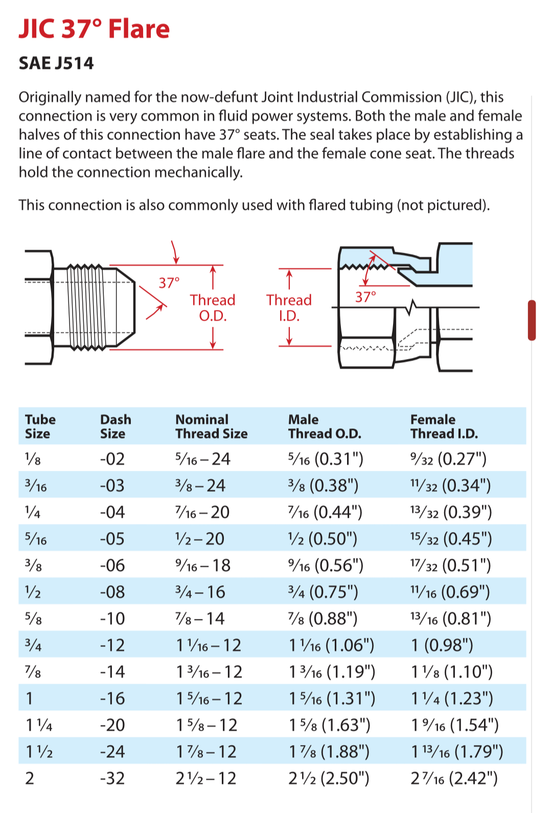

I'm with TheOldHokie - somebody replaced a 1/4" hose with 3/8", and some were replaced with double-braid which is thicker and stiffer.
It's going to be hard to measure those hoses in place. If time is critical and somebody local can crimp fittings, you could buy hose and fittings to have on hand to have local shop cut and crimp (but they may not want to crimp non-purchased items).
I'm attaching the JIC thread size chart. The fitting thread is not always the same as the hose size.
