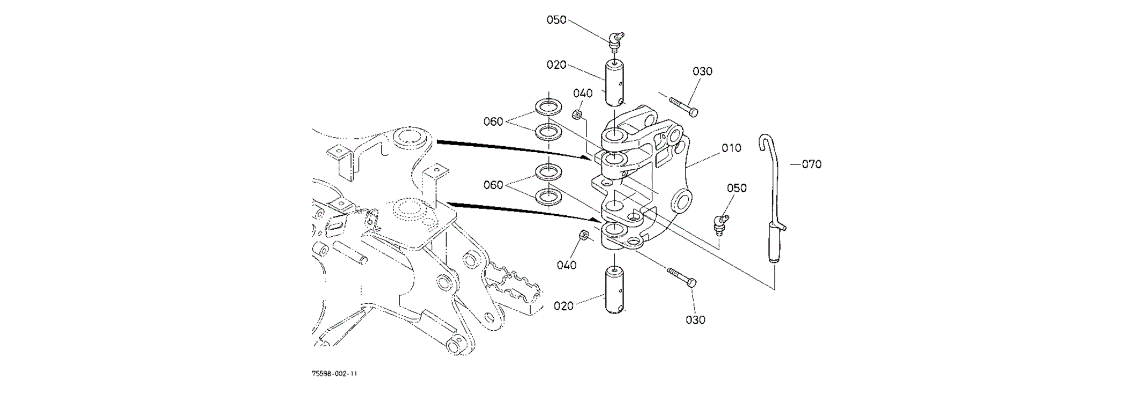

Here is a pic of the swing frame off of Messicks. The is a bolt (030) that holds the pin in. Is it possible that the head sheared off on the side you are looking at but there is still enough on the other side to keep the pin from sliding out???
I could be wrong, but I think she is referring to a pin on a cylinder and not item 020 shown in the diagram you provided...
I most definitely think that you.... "could be wrong" on this!
The pin pictured is without a doubt part # 20, as DustyRusty indicates.
It does not look anything like a cylinder pin!
Well, tractorgal said the following:
"It's been quite a while since I had posted about this problem. Now, I'm back at it. This time, though, I am trying to removing the cylinder to take it for repair. One of the pins that holds the cylinder is stuck."
Sounds like a cylinder pin she is referring to
, not a pin in the swing mechanism...Hard to imagine she would be trying to remove a pin that is part of the swing mechanism...but could be I suppose.
