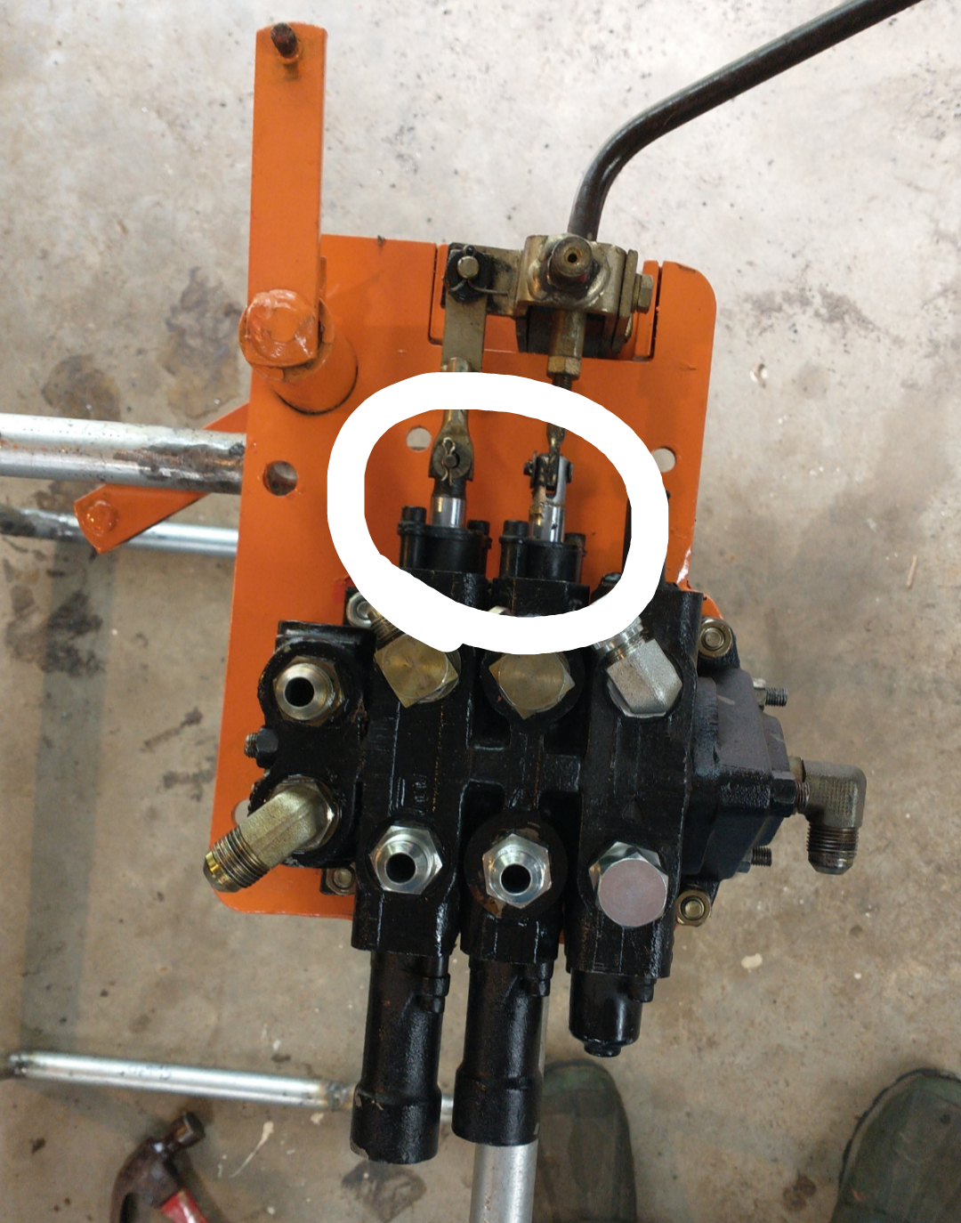

Are the things circled what you're referring to as plungers (these are on my loader, but your backhoe would be similar)?
If so, when you move the stick one way, it should pull out and when you move the stick the opposite way it should push in. When you move it forward and back, one spool (plunger) should move, and when you move it left and right the one next to it should move.
If that's not happening, you have a valve issue. I don't think yours has a relief valve in it, even if it does, when you turn the engine off and move the loader valve, any pressure bleeds off. So I don't think it's related to a relief valve.
Describe what's happening a little better, and someone (probably not me) can help.

I am with Potreeboy.
The "plunger" controls cylinder operation. If it wont move the cylinder wont operate. It is not really under any sort of hydraulic pressure that would prevent it from moving. I think you would be wise to leave that relief valve alone.
Your problem is most likely something mechanical with the valve. Verify that the control linkage (lever) is working. If thats good then the spool is probably jammed inside the valve. Rust, broken return spring, debris caught in one of the lands or simply bent are possibilities there. In all of those cases its valve disassembly time. Lots of little pieces in there too.
Is your valve a one piece casting or is it individual sections sandwiched together with tie rods?
Right now on my phone. I will check the parts diagrams when I get to my desktop.

Perhaps the problem is not the cylinder after all! Here's a diagram of the swing control valve:
I'm looking at the WSM for directions to see if this is something I want to tackle. I had considered buying a new valve! NOT! $733+ Oh my. I'd better learn how to repair. :)

yes you need to CONFIRM that the control valve 'spool' ( rod that moves in and out DOES actually move in and out. NO power need, just push and pull the lever, you should 'feel' 3 positions .
Anyone know if there's a 'kiddie guard' or 'lock' on this BH ?
Maybe remove a cover and SEE what's going on ??
No, there is not a lock or kiddie guard. The spool rod for the swing action pulls up when lever is moved to the right, but will not go down when moved to the left. I have removed the cover even though that removal is not necessary to see the spool movement...or lack of movement in this case.
Do each of these "sections" come off the main group so that it can be repaired? If so, it would be a lot easier. I could put it on a flat surface and then remove and inspect the parts. I'm getting the feeling that the cylinder is not the problem but the individual control valve for the swing.
The WSM does show an exploded view...posted above. That makes me think that the individual control can be removed. BUT, it does not show how or if these control sections are attached to one another. I haven't looked closely to see. Maybe when I do, it'll be obvious.

If the spool does not shift the hoe will not swing.
The valve sections are held together by long tie rods that pass through the stack horizontally. Remove the nuts on the tie rods on that end and slide the sections off one by one. Dint loose the orings between the sections. There may be some sort of base plate or mounting bolts on the underside of one or more sections thst will complicate removal.
