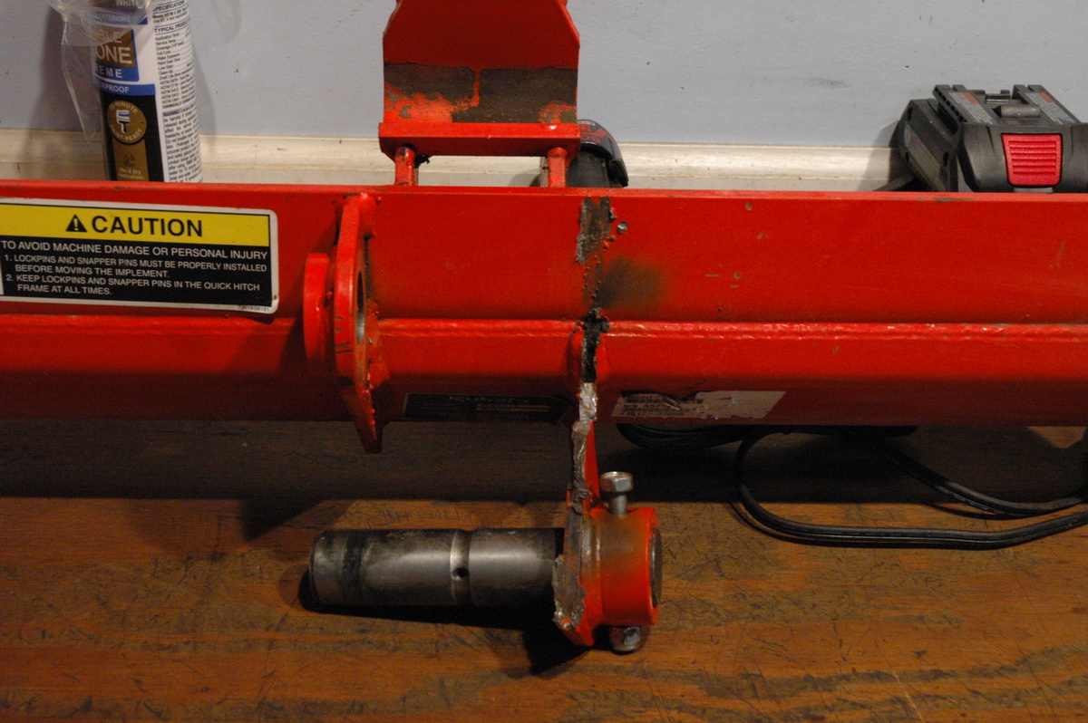

Fixing the driveway today after yesterdays storm. Scooping buckets of gravel to fill the wash-out. The bucket will not curl!!! What the heck???
The Quick attach weld failed. Note the lack of penetration. Removed the quick attach, places the bucket right on the loadrer and finished the job.

Wow. That sure is a piss poor weld.
Must have been a Friday or Monday build.;)
Luckily it should be a relatively quick and easy fix.

It took 5 years of use, about 1,000hrs to finally have this appear.Had to remove loader and 'stuff' for neighbour to WELD it proper.I emailed Kubota about it, they dumped a wad of cash into my account.

I am curious about the pin - it looks awful clean - did you clean it after the break?
That is a sorry weld for sure !
10,001
4,109
wow, I zoomed up the picture 400%(aging eyes...) and I don't see ANY grease oozing out the 'retaining bolted' end !

IMHO, they are asking too much from too little amount of weld. A 3/4” stitch weld on top where the greatest amount of stress is = a recipe for what happened. Wolfman nailed it!

William,
Yup, all cleaned off. If I am going to get something fixed, I try to bring it cleaned to the person, not wanting to leave it to them to clean my mess.
That pin actually does not pivot, it is the pin the quick attack on my little guy 'hooks on to' and is not a pivot point. It is just identical to the pivot pin, handy in that who ever welds it can use it for alignment and in the mean time, my FEL is still functional.
Having a very hard time to locate a local welder though...

Found a welder!!! Spoke with a 'olde tymer' neighbor. Welder/heavy equipment repair place less than five miles. Just dropped it off. Be fixed tomorrow!

All welded up, the guy even spray some primer on. Good deal!
