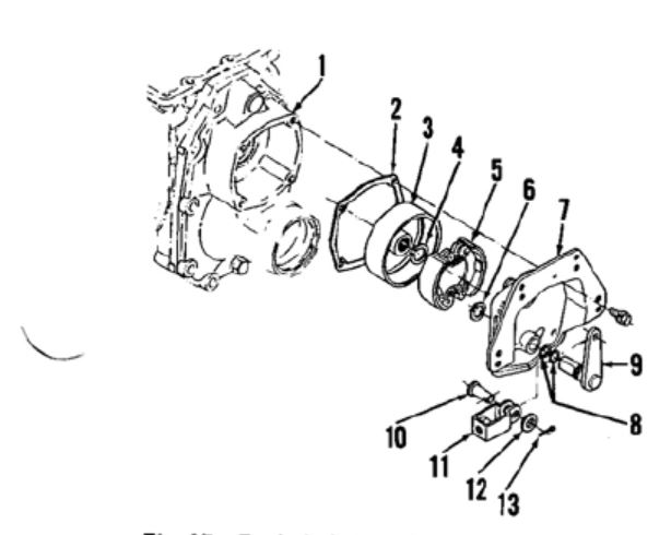

Do you have a shop manual yet?
PM me an email and I'll send you a copy.
Here is what it looks like.
Eric McCarthy
Kubota B6100E
Dec 21, 2009
5,223
9
44
Richmond Va
YEP there is a bunch of stuff in the way before you'll see the drums. I put new shoes on my B6100 a while back and took some diggin to unveil the drums. Seems to me they are more like an internal break drum inside the axle.
