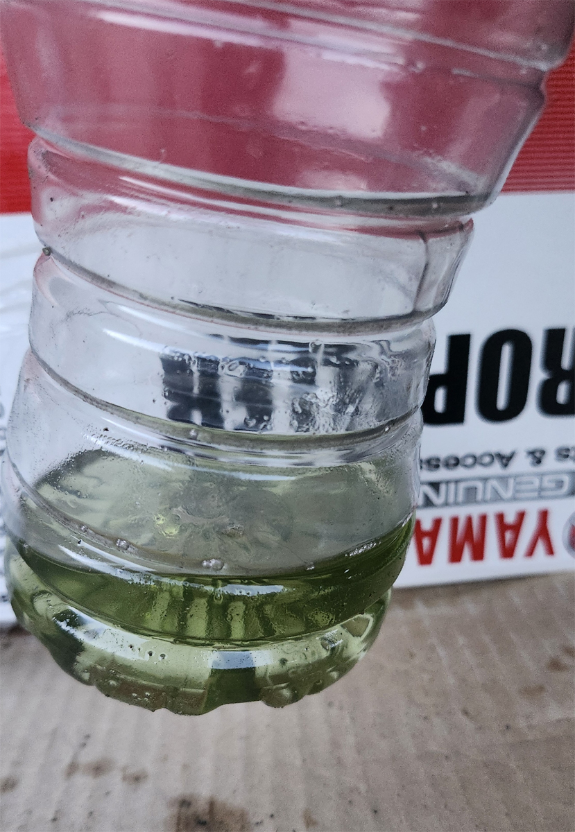

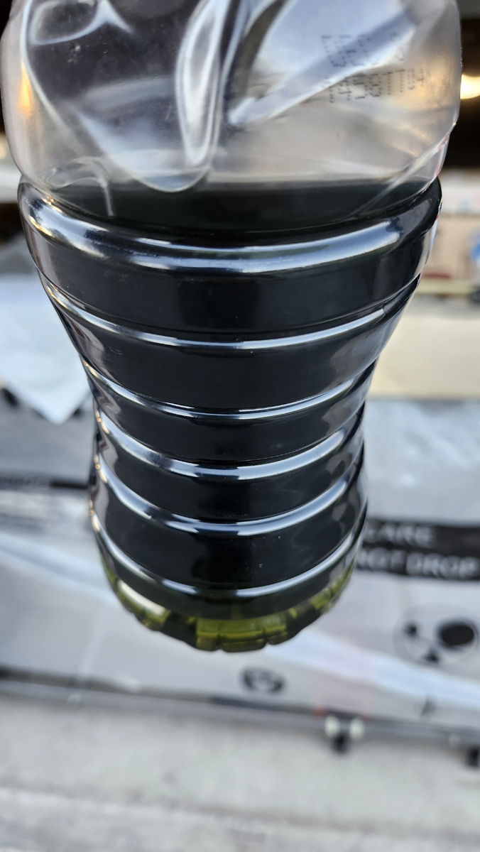

I pressurized the system before adding any brake fluid to the tank to make sure there were no leaks and all was good. I ended up bleeding all four calipers twice due to the color of the brake fluid. It's was a black/green at first and after flushing close to two quarts through I ended up with a lime green solution and a very clean and clear reservoir. I wonder if the green is from degrading brake hoses. :unsure: Since I'll need to bleed the brakes again when I install the braided stainless steel hoses I'll call it good for now.
Next up will be flushing the power steering system as suggested by @CGMKCM.
Brake fluid from the first go around.
Brake fluid after the second go around.

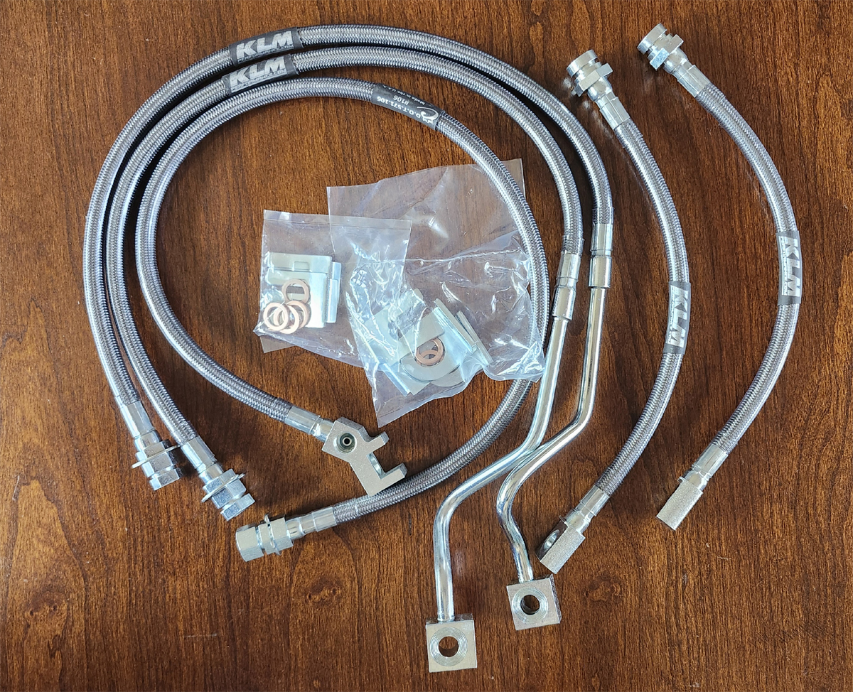

The KLM brake lines showed up today and I'm impressed with the quality. I've had stainless braided lines on my Jeep TJ for at least 10 years, but they don't have a clear protective sheath around them like the KLM version. I'll most likely get them installed in a couple of weeks once I'm back from a work trip.

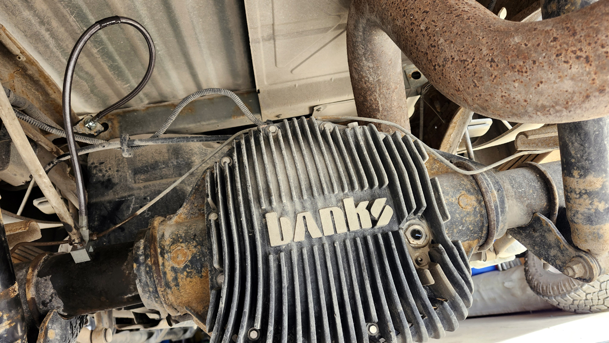

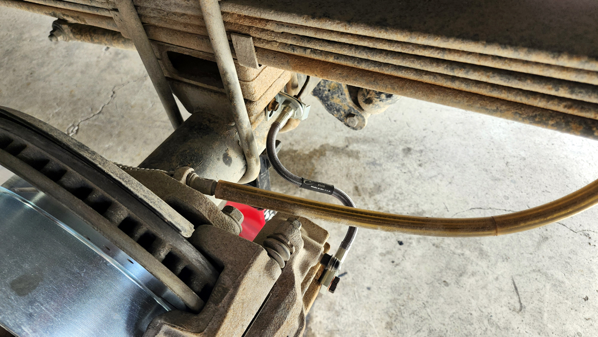

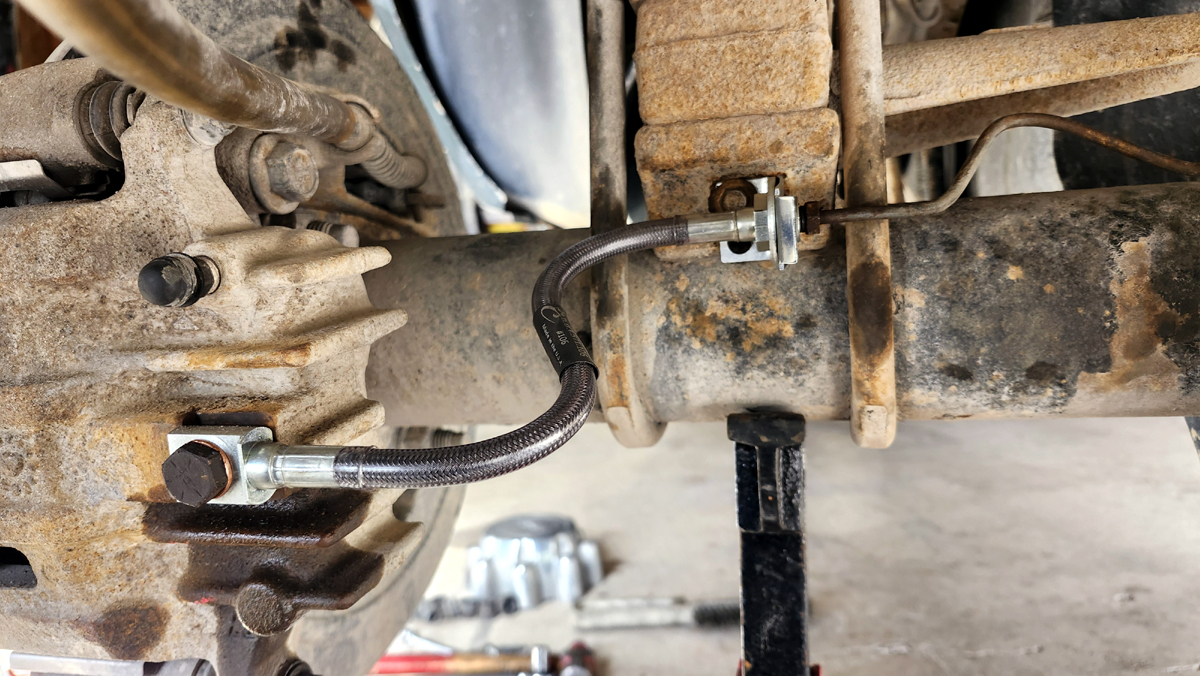

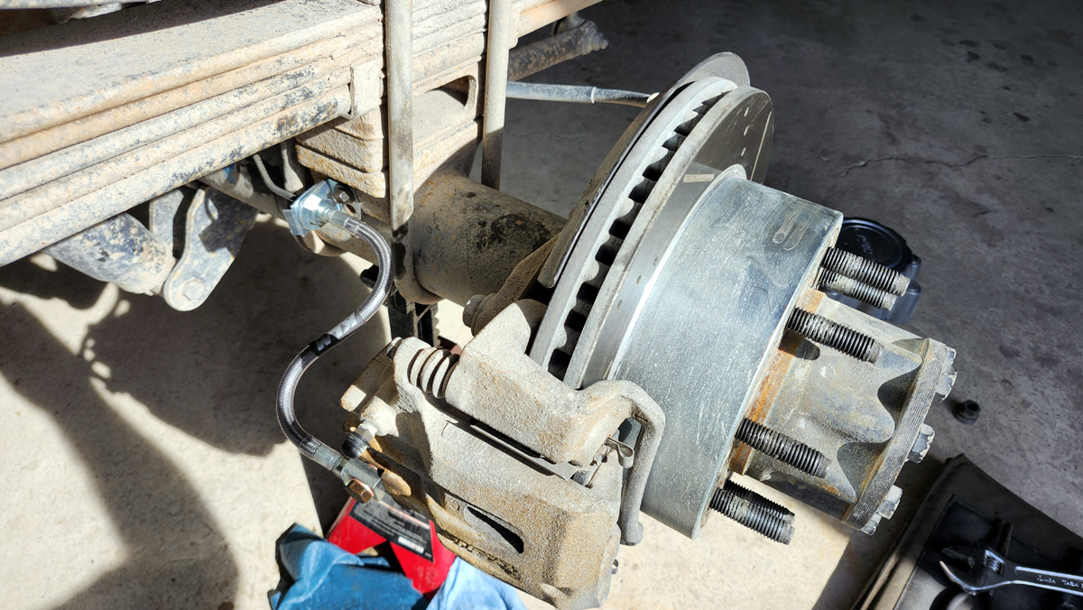

Overall I'd say that the installation wasn't too bad, but I could have opted for the factory length hoses up front rather than the +2" or whatever I went with. I had to adjust the retention clips for the front hoses which use the factory bracket, and there's no way to reuse the plastic clips that hold the brake hose, 4WD vacuum hose and ABS lines together. I used zip ties which I'm not thrilled about but what else could I do? The rear hoses use a new bracket which oddly has two holes in it even though there's only one tapped hole on the spring perch.
In the bottom picture you can see the hose that connects the rear axle hard lines to the hard line that runs along the frame to the master cylinder.
Good input. Thank you.
I already relocated my front brake hard lines when I added 1.5" up front. So I'll probably just go stock length.
Are these the clips you are referring to? I could just walk out to the shop and look at my truck. But it's raining. Lol.

That's not the clip. There are two plastic clips on each set of hoses up front so four in total. I'll see if I can find one in the garage, or possibly look through some phots to see if the clip is visible.
I'll take a peek at mine later on. Maybe come up with a workaround

@The Evil Twin, I found one of the intact clips in the box that I used to contain all of the old brake hoses, clips, and brake fluid soaked rags. There are two rubber "grommets" per side up front that snap into the open part of the clip shown below. The solid rings hold the brake hose and 4WD vacuum line without crushing them. The brake lines have fittings on either end that aren't removable, so Ford must install the clips onto the lines prior to installing brake hoses on the vehicle.
You can see the zip tie below ... not a great solution but there it is.
