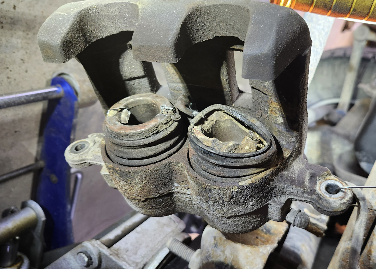

In all my years of owning and driving vehicles I've never seen such carnage! The oddest thing is that the inside pads on all four calipers have worn down to next to nothing whereas the outside pads have plenty of material on them. Needless to say, I placed an order for new front and rear rotors and pads, and called NAPA to see if they have Ford F250 calipers in stock since no one has a complete caliper rebuild kit that includes pistons.
The first two photos show the front right caliper and pads, and the third photo shows the difference in outer to inner pad thickness on the front left brake system. The rears are very similar to the front left.

That happens when the calipers don't float properly.
De-icer is the major culprit.
Pull the pins, clean and grease very well!
Helps if you clean up the slide surfaces too.

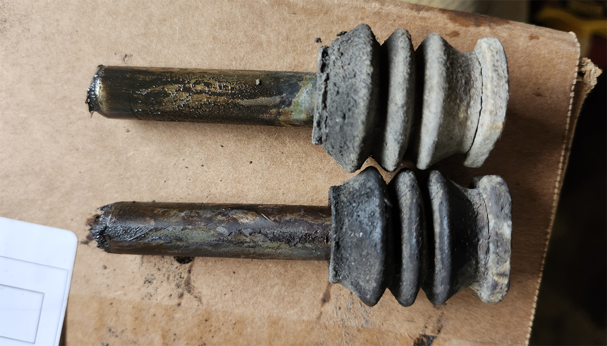

You could have had a pin binding, pad binding, or both. Uneven pressure will crack a piston. The pad backing plate can get hung up when there is rust between its "ears" and the caliper.
Depending on how much winter driving you do, it might just need to be a annual thing. Or every other oil change. I have never cleaned the pins personally. They get replaced when I need brakes. They are too cheap to bother cleaning.

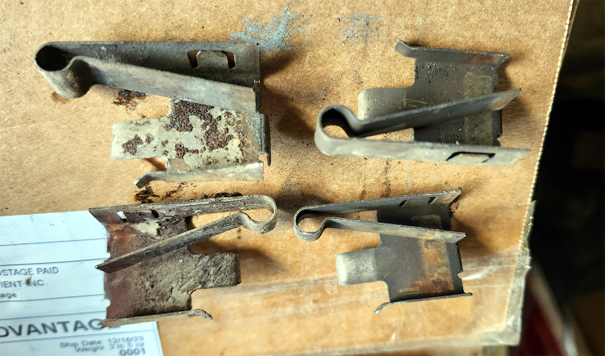

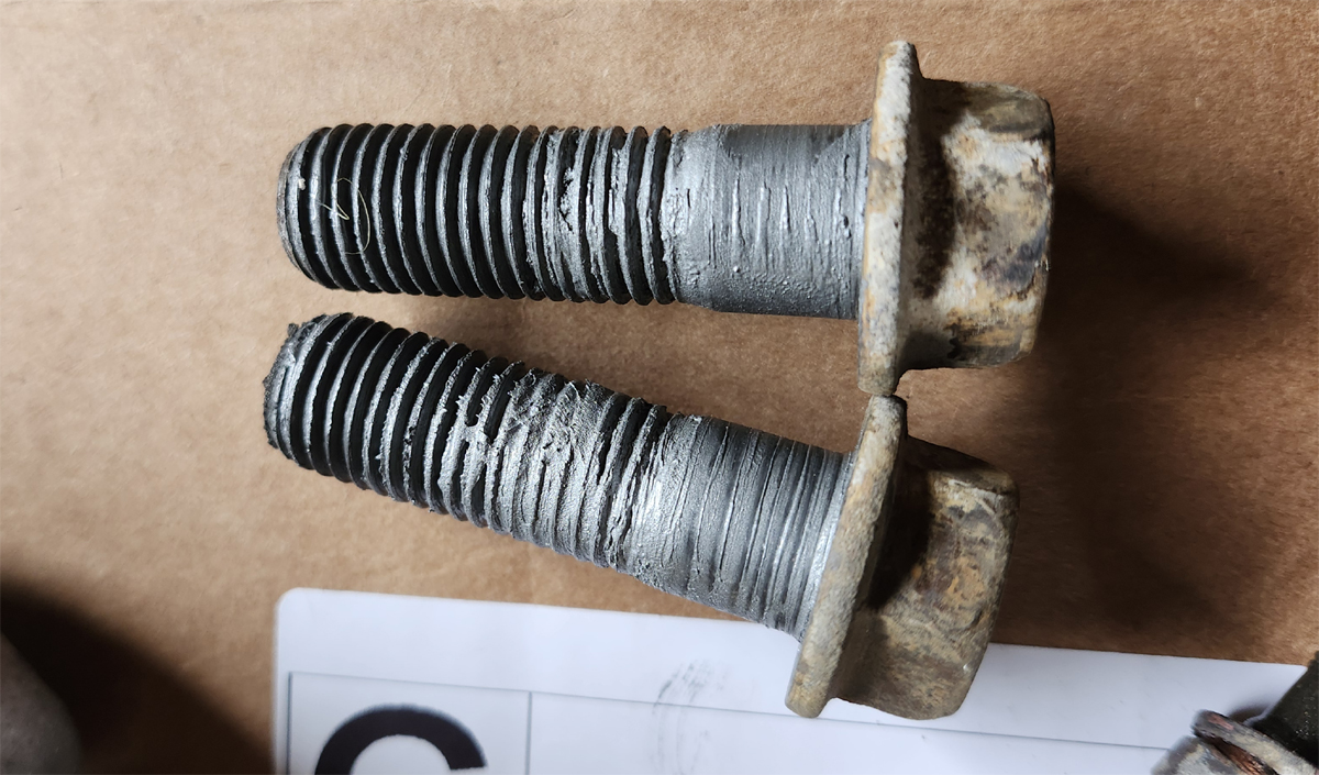

I got the caliper, caliper bracket and rotor off the right front this morning. The caliper guide pins weren't that bad with no sign of corrosion. The grease is a little "dry" but they move relatively easily. The pad guides (anti-rattle) were definitely dry and show some corrosion. Regardless, I'm going to add greasing both to the yearly maintenance schedule.
And for all those YouTube and Internet experts that don't believe anti-seize works, here are the caliper bracket bolts that have been through six Montana winters and 60,000 miles in almost six years. Yep, I'll continue using what has always worked for me.

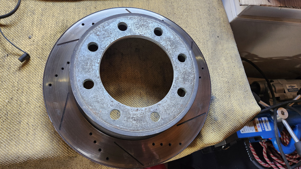

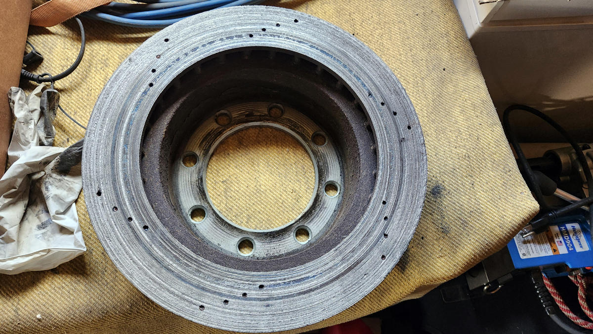

Here's the outboard and inboard sides of the front left rotor!
That’ll turn right out…..good as new…😉
Just kidding of course….🤓
My last tire rotation brakes looked pretty decent for 55k miles. Rears were a train wreck month ago and replaced all of them as well.

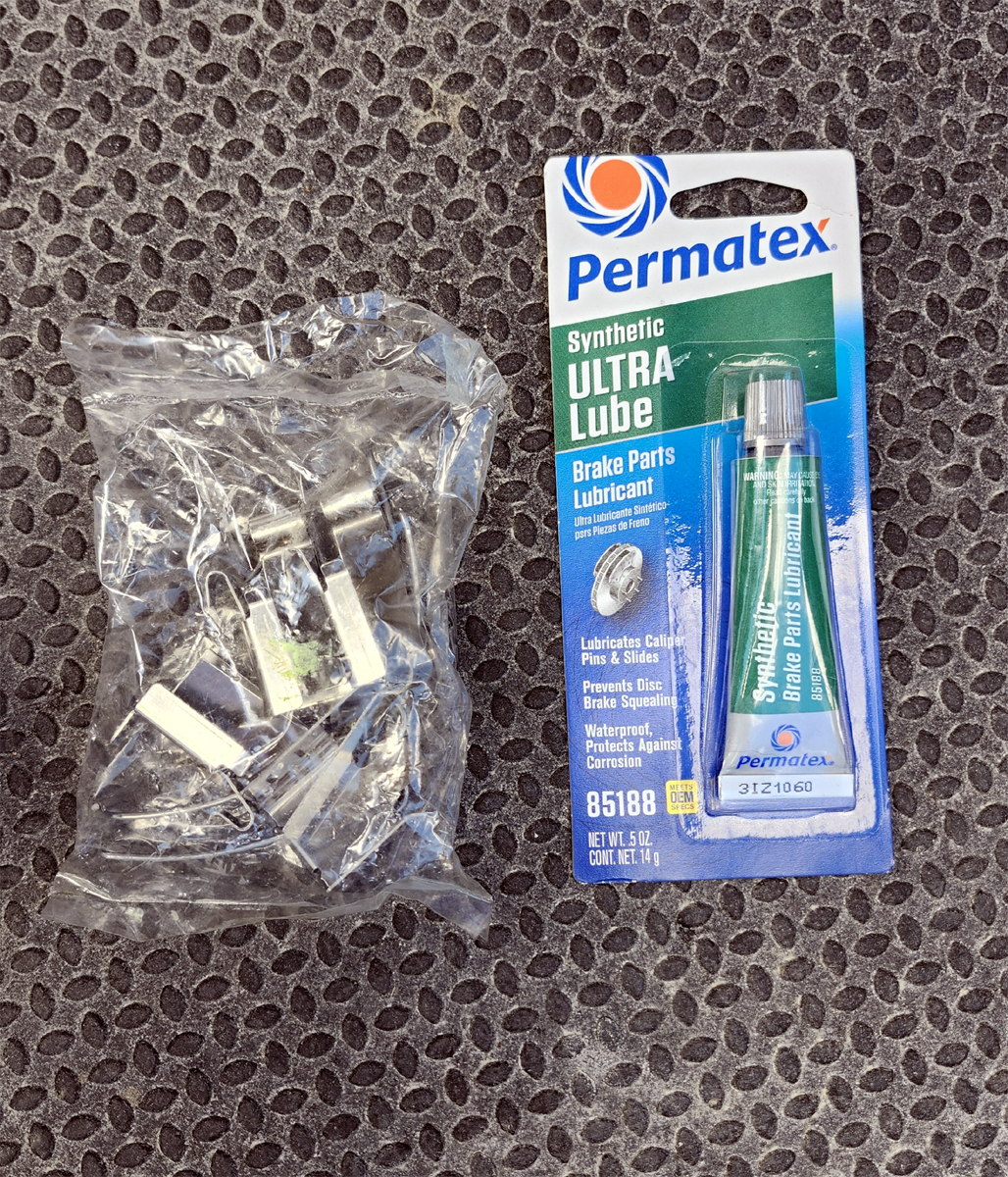

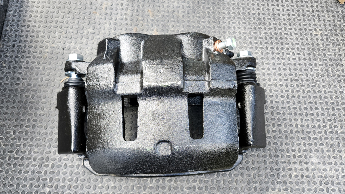

For anyone in a similar situation, I'm pleased with the remanufactured caliper I picked up today from NAPA. It's a Ford part that they've serviced/rebuilt and not some RockAuto mystery brand. It comes with a caliper bracket, new caliper pins, new dust boots, new anti-rattle clips, new banjo bolt and washer, new seals on the pistons and black paint. All that for a mere $83 is darn reasonable in my book. I gave them the old caliper so no core charge.
I might pick up a rebuilt front left caliper too if the original one looks bad enough. I'll remove it this week and decide after I know what I'm working with. I also picked up a quart of DOT 3 brake fluid, two cans of brake cleaner and some caliper pin grease. The new rotors and pads have shipped and will be here Tuesday.
