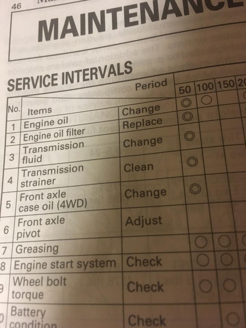

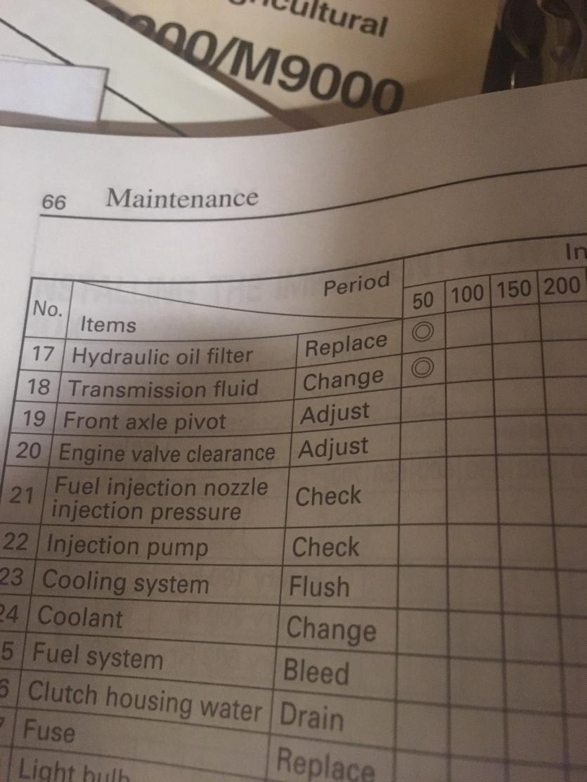

First pic is from my M9000 manual, second is from my L3000. Both list changing trans fluid, filters and front axle fluid @50hrs.
Don't know why Kubota has changed this but I'll never run a new one past 50hrs without the service being done. I've bought 3 new ones and they all were very nasty @50.
It sux to waste the new fluid but it could be worse. It takes 30 gallons to service those 2 I mentioned.
