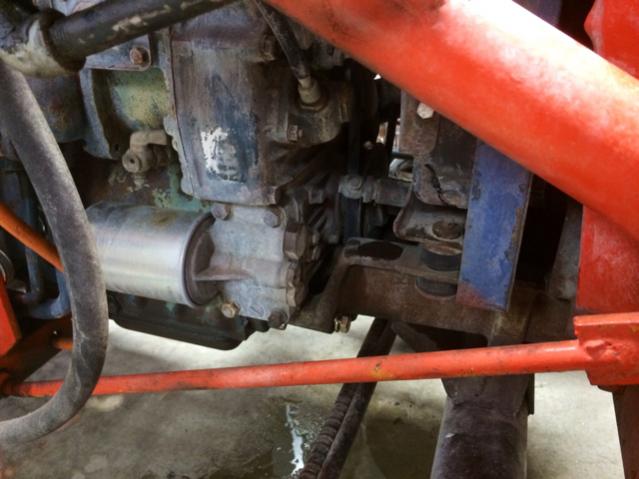

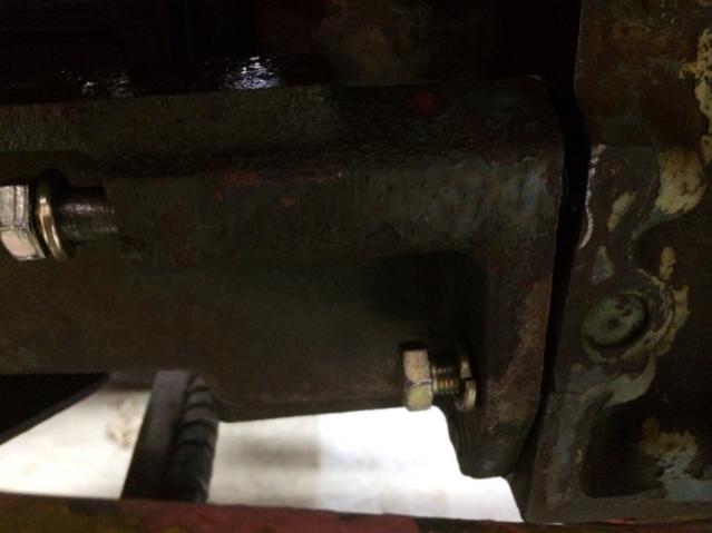

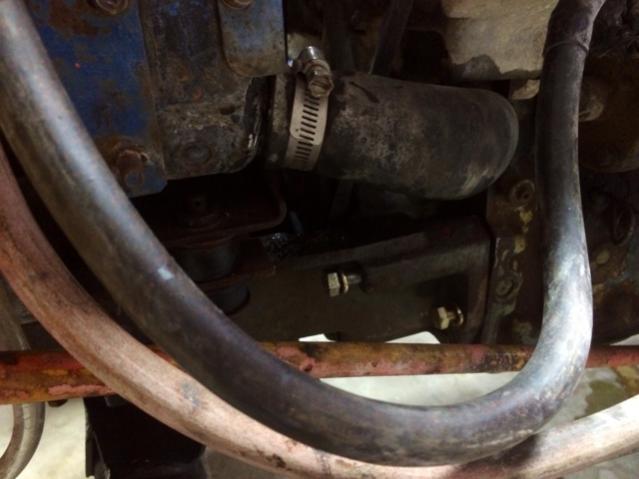

Don't know if this will help or not. I know I have a dilemma.
First one is when I had it apart for the repairs last time

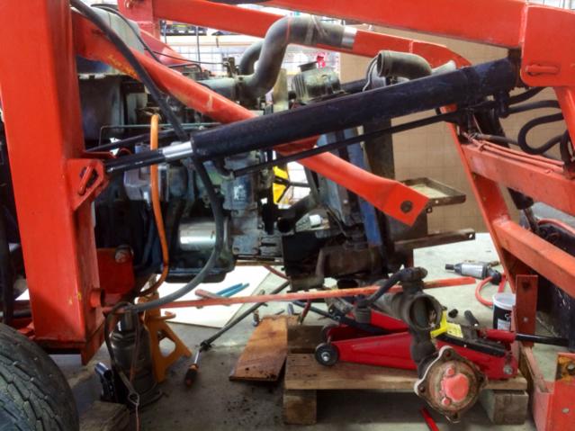

Here's todays report.
Pulling the motor and going to take it back to Houston with me. There is a company there that specializes in engine block repairs. Going to let them do their thing on the bad holes, and remove the the broken studs in the bottom 2 holes.
I'll go with 7/16" bolts again so or socket heads, depending on their recommendation. Guy told me there are many different ways to make a successful repair depending on location of the holes. Good thing about this company is I don't even have to drain the oil out unless the break into a cavity. Every thing except the alternator and starter can stay on.
Now as I'm taking it all apart I'm looking very closely at what cause the first and second failure. When I bought this beast the framework that bolted under the motor and chassis had several bolts missing. This allowed the loader to move around. After shimming and some alignment this problem was solved. This was last year. As I'm disassembling the front end I'm finding that a lot of movement has taken place and the two "tension rods" that run from the plate that bolts to the front of of the axel housing were not keeping holding tension due to past movement and flexing of the whole frame. This plus the bolts that hold the rear vertical posts are at the rear part of foot that bolts to the piece that runs under the tractor. After playing with two different jacking points (one under the gear case and the other on the front plate) I saw what what was allowing the movement that led to the bolt failure. Instead of acting like a vise or clamp, it was letting allowing to much movement both when lifting and back dragging the bucket.
When I reassemble I'll be very careful to have the alignment stress free and will run a weld bead across the front of the vertical post feet since there is no room for bolting.
Now this brings us to today's dilemma.
I've not been able to remove the axle pin from the front housing. I used a rose bud to heat both ends of the casting to orange and beat the crap out of the end of the pin with a 2# hammer only to get a ring instead of movement. Tried turning it with the piece of key stock that's welded on, no go.
I have to remove it so I can take the housing along with the motor for proper bolt alignment.
Any suggestions here?
