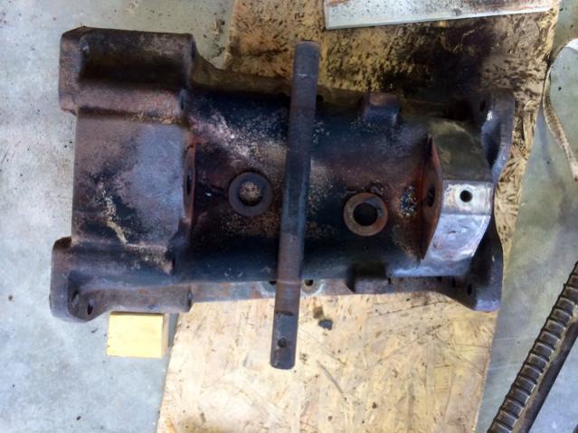

Here's the framework if you can make heads or tails of it.

Where (on the tractor) was the set screw (holding in the pin) installed at? No mention of that was in the work shop manual I have.
Looks like you have a fairly serious "groove" in the pin. I assume that is wear on the pin, is that correct?
The set screw was located in the hole on the right hand side of the housing.
That is wear you see on the pin, but that's not what was not letting it come out, it was the housing on both ends of the pin that had it captured. It didn't want to start moving until both ends were orange in color.
