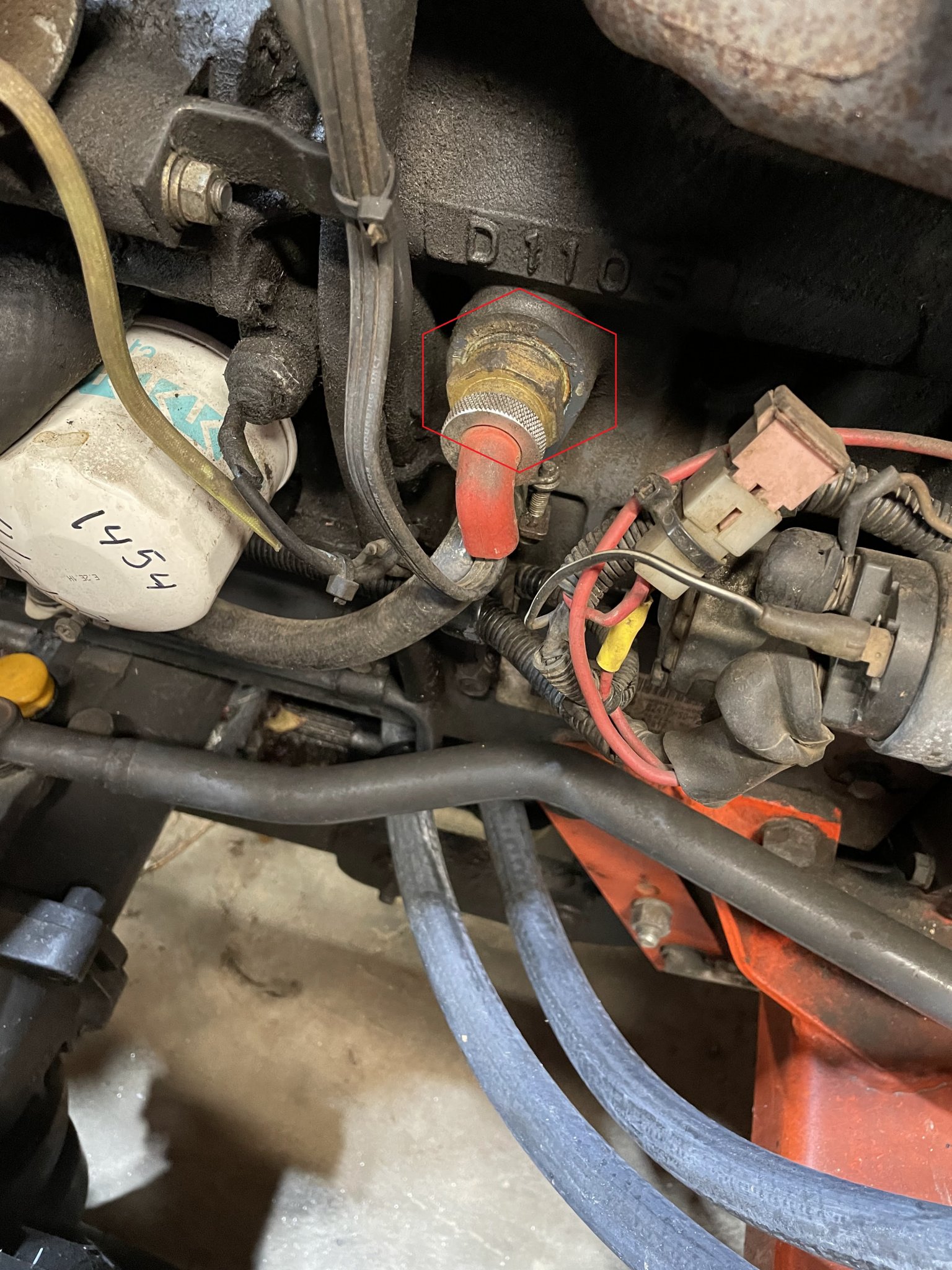

It has the D1105 motor in it the part for the block heater is 70000-73274 About the best price I have seen for them is at R&L Supply. If you need filters or other stuff it's cheaper on their own site if you need just the heater it's $57.54 on E-bay with 5.50 shipping.
To install it it goes right behind the alternator on the left side of the block.
You will need a 17mm Hex bit 1/2" drive socket and a breaker bar and an 8-10" extension. It's in the block pretty tight about 100 or so Foot pounds.
their should be a block drain petcock just under the plug. Remove it so you have room for the next step.
To install the block heater (You do not use the small steel rod or the hose clamp). You will coat the threads with a Teflon pipe dope ( I do not like to use tape). then use a 1-3/8" socket to tighten it into the block use at least 75-80 foot pounds of torque to tighten it or it will leak. then re-install the block drain petcock. re fill the cooling system and connect the 110 volt AC power lead.

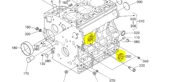

The block freeze plug as well as the block heater are threaded into the block
Block freeze plugs are never screwed into the block, they are always a press fit. If his block has a threaded plug, then it was purposely made that way to accommodate a block heater. If using Teflon of any type, you have to be careful not to overtighten it when installing the block heater. Teflon will reduce the resistance to threading the block heater into the engine. I would only use a thread sealant that doesn't have Teflon in it. If you examine the block heater, you will realize that it is a tapered thread, and you only need to get it snug. If you find that there is a leak, you can always snug it up some more. I use Rectorseal #5 -since once it sets up, it will seal the threads. If you are pushing to get to 75 or 80 PST of torque, you will run the risk of cracking the cast-iron block. It only needs to be tight enough to seal the threads.
