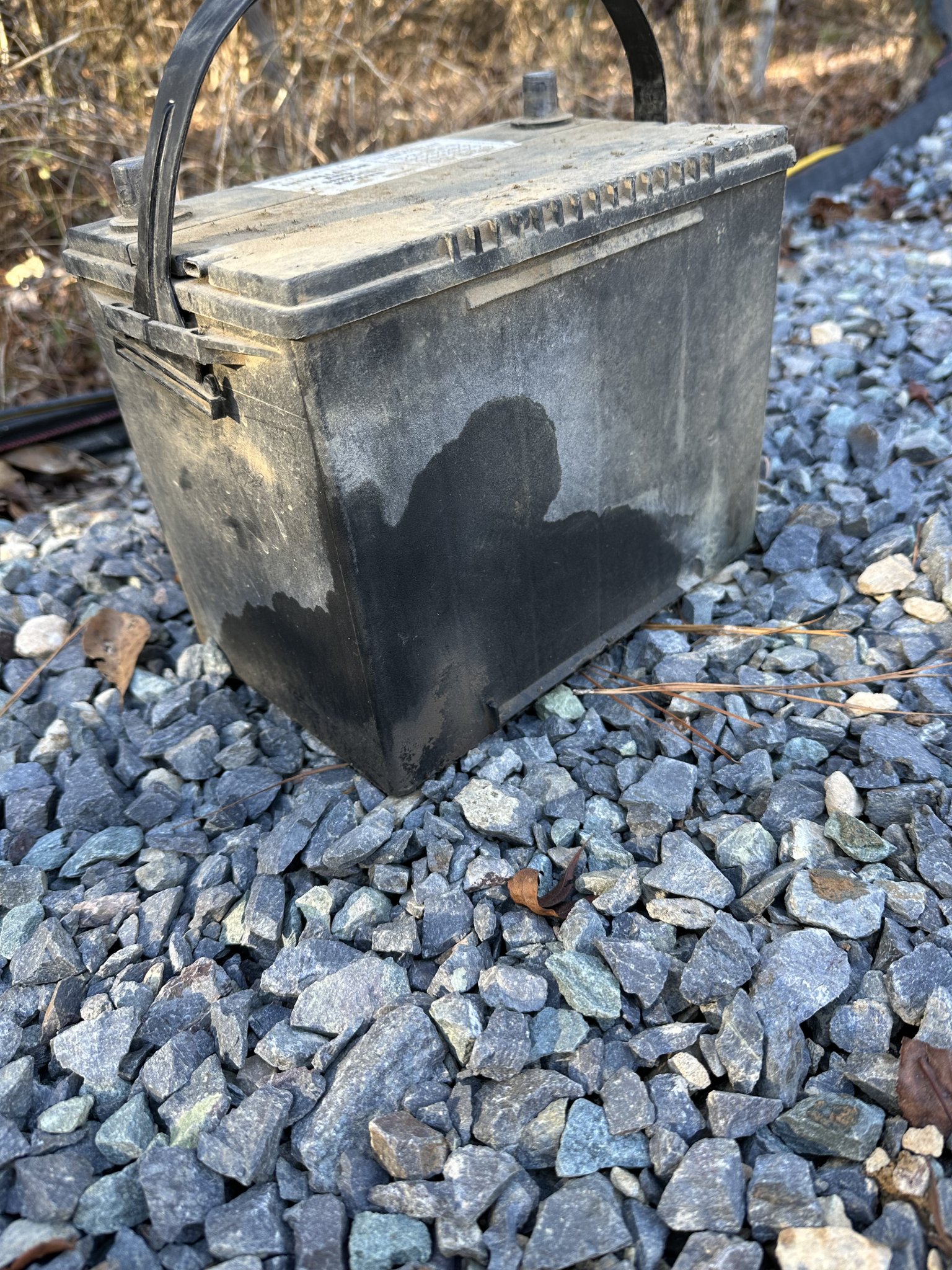

Thx folks. I ended up with one from the dealership which is supposed to be a private label interstate battery.
looks like my old one was cracked and leaking acid from the bottom…the steel at the mounting location confirms it.

hopefully you'll pour a LOT of water/baking soda mixture where that battery was !!! Pour. let it fizz, pour some fresh water on it, repeat until no more fizzies.....
I didn’t think of that but I did spray it with a good bit of fluid film.

Boil some water, take it off the stove, add baking soda, pour it on, watch the magic. Hit it with some good paint.
