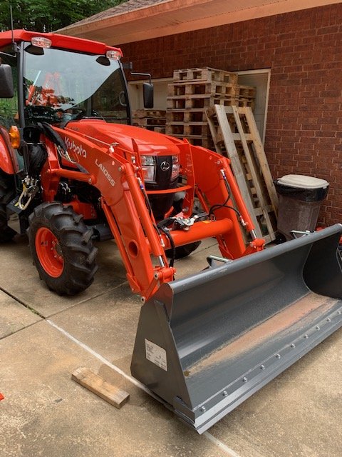

Bent (frown) leading edge on new 60” bucket

It is probably curved due to the welding process. Which means most will be like that if that is what your confirming. Honestly you will be surprised how quick that frown will smile. 1/4 over a timber of wood is not much. The other possible is to have the dealer put a bolt on cutting edge on it for you. It will make that edge flat. I wont buy another tractor bucket without one. They are much stronger and will always have the potential to be renewed.
What style or brand of edge do you like best? I’ve seen those piranha cutting bolt on’s... vs the straight edge.

Well it IS a 'big deal',shows someone using substandard materials, poor welding setup and bad 'engineering'.OK, it's 'just' 1/4" bend but that's in 30", so 0.83333%.doesn't sound like much BUT consider neighbor's new house foundation. One 25' wall is 'only' out 1%. You say 'not bad' UNTIL you string for the wall, it's out 3 INCHES !! Froming crew is coming back, on their dime, to 'cut ,pin,repour' though it will NOT be the same as a PROPERLY done wall.
Having built 25-30 trailers ove rhe years, I know that you need proper materials, jigging and welding to keep things 'straight and true'. I'm thinkig the bucket is made of thin steel, improper grade and quickly welded.
I'd expect the dealer/head office to replace the defective part AND supply a heavyduty' bar, free of charge.

My dad had a problem with his bucket with a little bend in it. Although his was the typical smile and not the frown. His bend wasn't able to be fixed with a bolt on edge. I think your bend might be able to be fixed with a bolt on edge, but you hate to see the quality slipping when they are trying to meet the high demand.

Without question, I wanted an edge on my bucket. Happened to choose the Piranha Tooth Bar.
As others mentioned, I think an edge would take care of it, and also protect the bucket over the long-term.

It sounds like a straight cutting edge may be best for what you plan to use the bucket for. Also, check out edge tamers to assist in snow removal with your bucket. It's very unfortunate that there appears to be a manufacturing issue currently but these items should help you do what you need. Another option is to return the bucket and purchase one from a third party. One option is the Everything Attachments bucket with the reverseable cutting edge.
For this scenario straight. The piranha and straight bolt on edge really serve two purposes. The piranna is to increase your ability to penetrate the aggregate. It also attaches by tongue which is for simplicity to install. A bolt on edge functions to strengthen the lower edge, while also providing extended life. The buckets drill fairly easy with cobalt bits. If your adding one, just clamp the edge on and mark/drill the 1/2" holes. There are UHMW cutting edges for snow removal as well, if you decide to go that route.
The bolt on cutting edges are very hard and brittle. They seem to resist wear better than the original welded edge. I would go with factory, it will fit the width perfect, its painted, and it will come with hardware if ordered wholegoods.
OP,
I believe there is a factory bolt on cutting edge heavy duty bucket. Maybe you can have the dealer swap you one out. The hd bucket is double skinned and much stronger. They are about 30% heavier so that does take off the lift capacity.

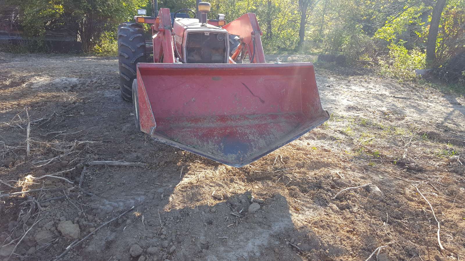

WOW!! Is that ever bent!! LMAO

That'd be good for digging a ditch!
About the only thing it is good for. It has since been replaced and I think he has learned to be a little more gentle with his bucket.

I’m not convinced the board is straight....
I'd use a 6 foot builder's level or some other straight edge instead of the board.
Even better, I can visually gauge a bend easier than using a suspect measuring tool.

I trust that the OP had a reason to check the straightness.
A tight string from side to side will tell the story.
