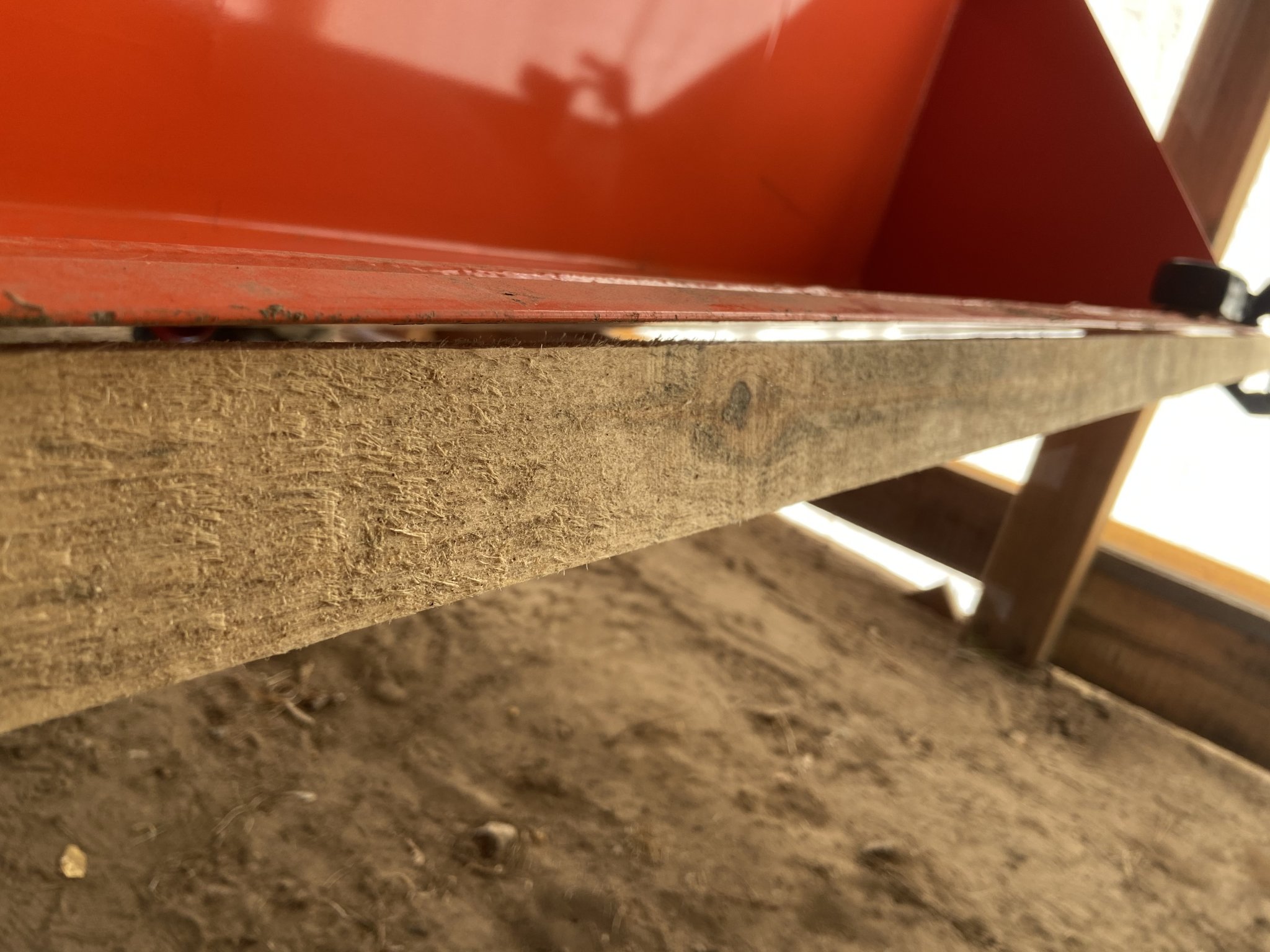

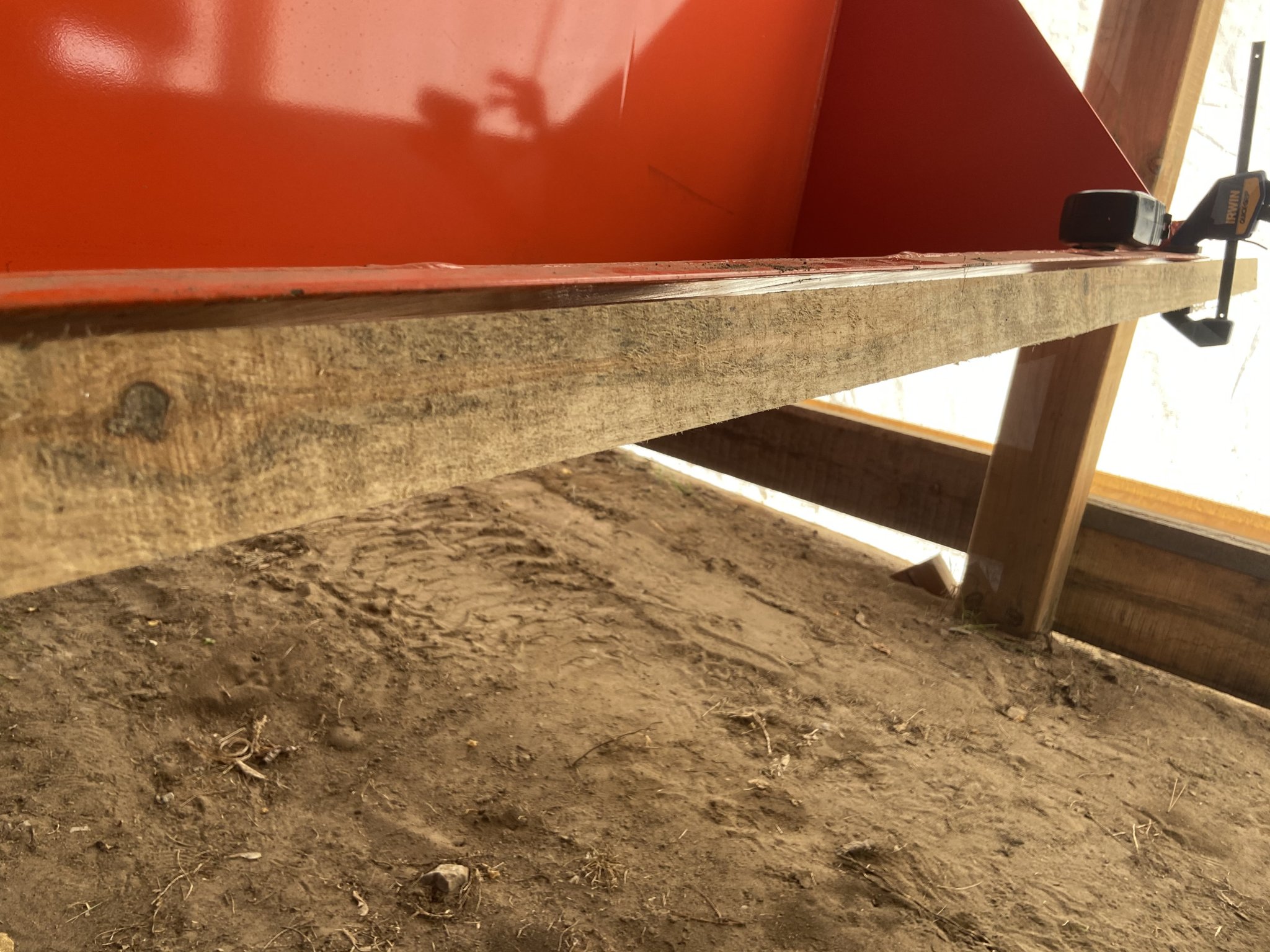

Thanks for your reply I am including a pic. Space is just over 1/4”
Try ripping at a stump with the center of bucket will probably bring it to flat. Maybe some shrinkage happened after welding that caused it.

the gap is just over 1/4” which wouldn’t be a problem other than I will use it to clean driveways and clean off rinks on the lake this winter

Arkansas, US
