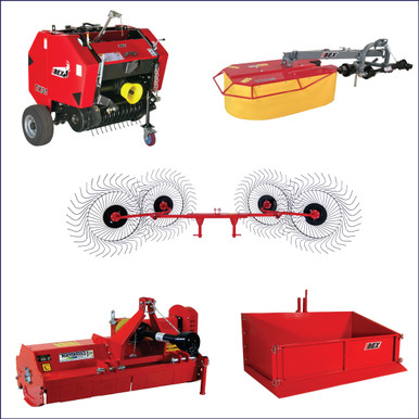

There was a time I was pretty serious about a ...package... of hay equipment consisting of a mower, rake, baler package for a bit under $10,000 at the time... Then I wanted a string tie bailer, not net wrap.. They kept pushing the net wrap option pretty much ignoring my preference of string wrap.. So it never went any further..
My 5 cents of experience..
