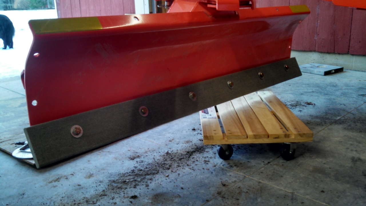

I am guessing the stall mats alone would work well for fairly light blades, but another suggestion is a piece of Trex or similar plastic 5/4 board drilled and installed to replace the steel blade. You might be able to find that if you can’t find a stall mat.
I got a free piece of board and it is still in place 3 years later. I needed to make sure the steel blade didn’t gouge up an alley that was sloped to form a V shaped area about the width of my tractor the length of my barn. Works well and has the side benefit that I can plow parts of the lawn if needed. You may
have to find new bolts though, mine were designed to work with square holes in the steel blade, and I didn’t have the right tools to make square holes.

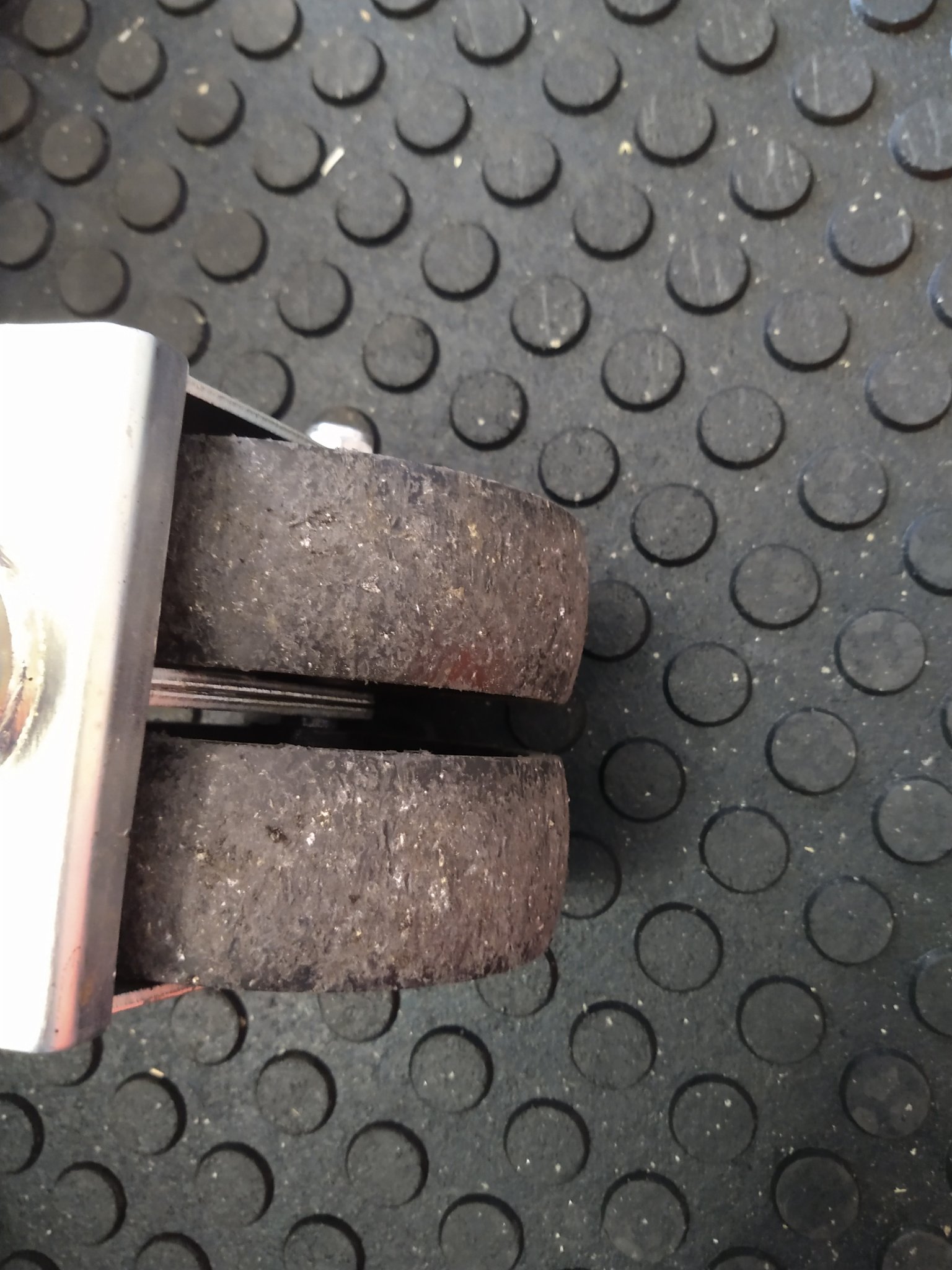

Final build is done. I'll be working on the other side tonight. I know some of the guys were asking where to find the plow bolts, I as well had a horrible time finding them and settled on bolt depot dot com. All the rest of the bolts, nuts etc I sourced locally. So the difficult part was making sure I had enough clearance for the wheel to rotate so that's why you see so many unistrut stacked together. I could have had someone fab me something with square tube but I had a bunch of unistrut so that was easiest and cheapest for me.
I also had to be careful how far the bolt on the bottom stuck out and had to cut some of the "curled" part of the strut out to be able to tighten the 5/8" plow bolt down. One other thing I added was a carriage bolt to hold the top bracket for the trailer jack to give me a little more confidence in it holding tight. Oh I also had to reem out the strut holes just a bit to get the 5/8 bolts through.
I was going to paint it to match but will probably wait till it comes off in the spring and then add that final touch.
If I was to guess I am probably $130-$150 in this project. Probably 1/3rd of that was ordering extra plow bolts not knowing the exact length I would need for the bottom of the strut. I also had spare strut so there was no cost there.

My biggest concern with not going with grade 8 would be longevity/rust build up. Other than that I would think even the zinc bolts should be strong enough might just be rusted up after a number of years.
So my biggest concern with this setup is the wheels. With the gravel drive I think they will wear pretty heavily over time, but i had a feeling that might be the case going into this. So just have that in the back of your mind if you go with a similar setup. Probably will do some research on some better wheels, maybe with grease built in at some point, if they make that for something this small.
The picture of wear was from a test run of just a few passes.

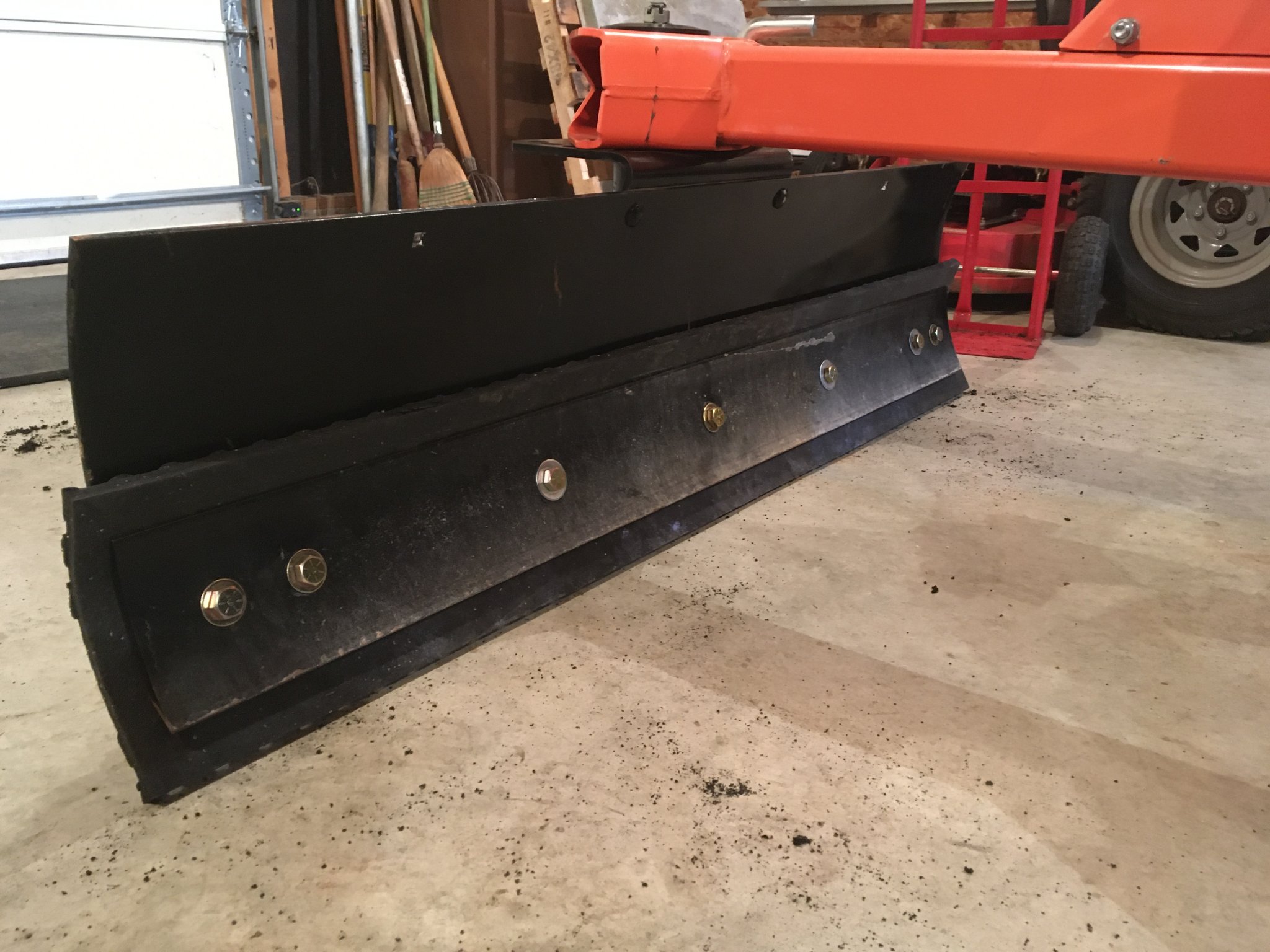

Finally got er done! Had to use regular bolts and washers on the face.. grade 8 bolts. Funny TSC did not have the correct sized washers for their bolts in that grade., they were plenty large enough for sure, too large, more like a 13/16”hole, bolts are 5/8” I had to go with the zink for the almost right size washer. I had 4 that fit perfectly, go figure! Anyways that’s why the difference in color and size.
It came out nice and I’m anxious to try it out. I cleaned it up underneath where the blade and cutting edge had surface rust and coated them with some Wd40 to help with that. I’d like to thank @sam24and48 for posting this thread.👍
