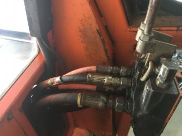

First post here. I bought a b8200 hst from a co worker this past summmer. Since then I have been getting things freshened up. New fluid and filters, new seat, new lights, fixed the flashers, solved an oil leak (oil pressure sending unit) and some other odds and ends. Anyways, I am now in the process of replacing the front hydraulic lines. The tractor has a full cab with heat, a two spool loader valve, and a b2020 front blade for snow. As I’m getting into this I now realize my hydraulics are odd. The two spool loader valve has two lines that run from the rear block and utilize the same port. There is a third line from the loader valve that runs down to the mid pto. Everything works fine but why would they hook it up this way? Although I have nothing attached to the rear, it could be annoying if I did because the loader valve for the blade also operates the 3 point at the same time. Aside from the loader valve I can still operate the 3 point with the control lever. I’m thinking while I am doing these front four lines, to maybe re plumb the whole loader valve from the front block which would correct this strange set up. Any advice or tips would be great? I am new to tractors but having fun working on it. Thanks

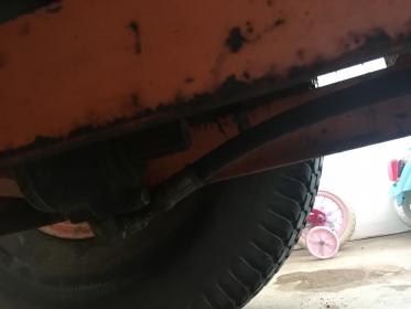

Looked at it again today. Tough to see markings on spool valve but I could see one pb mark. I believe the pb is one of the two lines that run to the rear block and share the same port. I believe my third line to tank is the line that screws into the bottom of my mid pto. Hopefully my pics load...

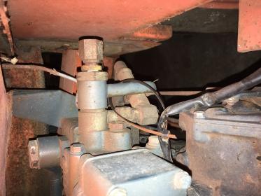

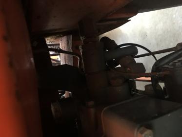

forgot rear block. So although this is a weird set up, I’m not too worried about it because I don’t plan on using 3 pt in winter. Since I’m planning on replacing the 4 snow blade hydraulic hoses, I’m going to add quick connects. So come spring I’ll remove the blade and I’m assuming I’ll be able to operate the 3 pt. With either the spool valve or the oem lever to the right of the seat.
Again, has anyone ever seen a set up like this and why would they do it this way? The front block looks like it’s never been touched, but maybe it could be a clutter with the pedals and cab and what not?

So it sounds like the front spool valve is hooked up right, the line to the mid PTO housing is rather unique but will work fine.
Can you turn on the flash or hit it with a trouble light and retake the last pic. ;)

Are both the add on lines going to the loader valve?
And yes that is a truly strange way to hook it up, as both the PB and the Power in appear like they share the same port location??? :confused:

Yes both of those lines which share the same port go to the loader valve. The third line on the loader valve is the one that connects at the drain of the mid pto which is my tank line I believe. So yeah, very odd. Again, any ideas why someone would ever hook up this way when the original block valve appears untouched? My first step will be replacing the four lines to the snow blade. I’m still debating if I should correct this strange set up or just leave it as is. I just put in new hydraulic fluid so that’s one issue I’m worried about is when I open up that mid pto connection I’m going to have a huge dump of new fluid. Opinions?

There is no real good way to change the tank line, as there is not any other port that you could connect it to.
The original kit for the loader had an adapter that would pipe the tank like into fill port.
As far as the other two lines, yea if it was mine I would change them to where they are supposed to go on the front block. ;)
