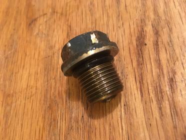

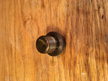

Looks like ORB. Maybe a touch longer than some plugs.
Do you have accurate calipers? And maybe thread pitch gauges? You could use a chart such as this to verify the threads and diameter:
http://fittingsandadapters.com/saej5straigt.html
(There's lot's more out there -- that was the first one on the list from Google).
36,535
11,292
Measure the size across the wide of the threads, send me a PM with your address and I'll send you some if I have them, and I should have them, I have a pretty good pile of o-ring boss fittings.

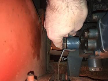

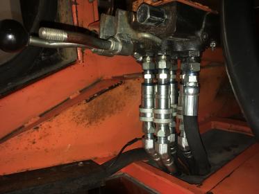

I confirmed today that the plug is bspp with o ring. I think my best bet is using a male bspp to male jic 37, then attaching a female swivel jic 37 with a 90 degree turn. Biggest conflict is the hst pedal as I only have 1.5 inches of clearance. Anyone know if I can remove my hst pedal and either bend it or weld in a jog to get more clearance?

Torch,
Does that male BSPP end swivel? Reason I ask is because the Tank and PB ports are right on top of each other and I don't know if I could spin them both in without hitting each other. That's the thinking behind the male to male nipple, then I can spin on a female swivel. For the HST pedal conflict, I'm going to cut the pedal just past the pivot point, and weld in a piece of flat bar roughly 1 inch to create a jog. I think it will work well, and give me plenty of clearance for my hydraulic connections. I now believe this may have been the whole reason behind the strange set up, Kubota chose a poor spot for the hydraulic block.

No, it does not swivel. The BSPP side is threaded in nearly all the way, oriented to the direction that the outlet needs to face, then the nut is tightened to compress the o-ring and seal the joint.
When I built my FEL, the hoses all needed to turn 90° from the spool valve outlets, and I too had an interference issue. However, I found some long elbows that cleared the standard length elbows. I installed the standard, shorter elbows on the valve body first, then the longer ones. There was just enough clearance between the two.
Mine were ORB fittings, but I would think similar long 90° fittings should be available in BSPP thread too.
Yup, found some: https://www.discounthydraulichose.com/9059l.html
(here's the standard length from the same supplier: https://www.discounthydraulichose.com/9059.html)

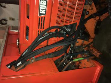

Well, the job is complete. Only thing to do now is start it up and check for leaks. Being that I had to dump all the fluid and I removed all the lines, do I have to worry about air in the system? Or will it vent itself? The biggest pain I had was the rear banjo bolt. I got a replacement through messicks, but the bolt was too short. I ended up re using that big old banjo bolt and capping off the two connections. Notice my hst pedal mod, it worked out perfect. I didn’t expect this job to be a big deal, but there was some time put into it. Check out the pics.

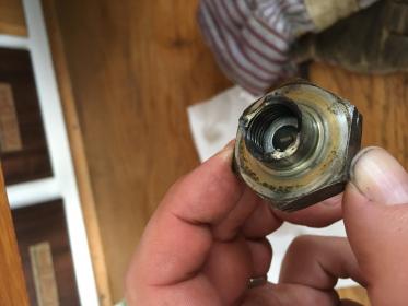

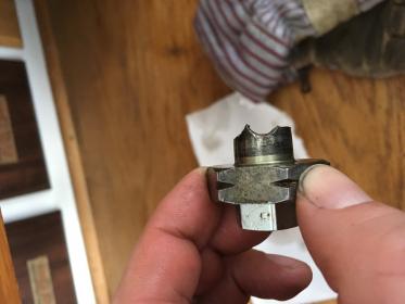

Wolfman, check this out. I went to start this morning for the first time. Once the engine fired up I heard a loud pop. I began working my blade up and down and left, then I noticed a pile of fluid on the floor. I immediately shut it down.
So the original big ass banjo bolt in the rear failed at start up. The head of the bolt blew off, and I lost over 3 gallons of fluid.
I’m back to finding the correct replacement factory banjo bolt, which messicks claims I have, but the bolt they sent me is too short. According to the parts diagram I need “bolt, joint 35” which measures approximately 2 inches end to end.

So looking at the banjo bolt that failed, I believe it was home made and drilled out. It was drilled and tapped at the bolt head as this is where my blade used to get it’s supply. Between the bolt not having much wall thickness and being tapped, it’s easy to see why it failed.

Torch, my loader valve is hooked up just as your picture shows. Pressure from the block goes to the inlet stamped “in”, the tank line goes to the outlet stamped “out”, and the power beyond goes to port stamped “pb”.
How would I know if it’s not an open center valve?
The setup prior had three lines as well.
The blade seemed to be working with up/down/left. The right cylinder wasn’t pushing but at that moment I went to shut it down.

Ok so I have my pb line hooked up to the neutral port, meaning I am always sending pressure to the 3 point even if the directional valve is set for the loader valve. Right? The only time the directional valve will be of use is if I wanted to bypass my loader valve then I would turn it counter clockwise.
Yes, from the pictures, I have to agree that the banjo bolt may have been home made. And it is possible that it could fail at less than the designed working pressure of the system (as limited by the relief valve).

I think your homemade banjo bolt was made to supply fluid out the
end of the bolt and then back in on the side fitting, thus when you capped off the end and side it dead headed.

If you look back towards the beginning of this post, you will see that goofy banjo connection at the 3 point connection that used to send pressure into my loader spool valve, along with a power beyond connection.
The banjo bolt that failed had a very thin wall thickness compared to the new banjo bolt that I have from messicks.
