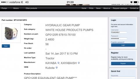

Was the pump a genuine kubota or non oem pump. I received a GPO120L pump from another supplier , but it is not exactly the same . It does fit but the gasket sealing area is much smaller. I am just wondering if your pump issue was similar or was the pump exactly the same as the original pump I have another post open on this and just need to be sure before fitting it.
Was this the part you ordered in the end

I have a new hydraulic for my Kubota B8200D in from White House Products
5P1/41041GPO GPO120R EQUIVALENT***
HYDRAULIC GEAR PUMP CLOCKWISE / RIGHTHAND ROTATION
RIGHTHAND ROTATION KUBOTA TRACTOR PUMP, 13.4MM SHORT TANG 6.8MM WIDE, 4-BOLT MOUNTING FLANGE 58MM SPIGOT AND 63x63MM HOLE CENTRES , 1/2 JBSP SIDE INLET, 3/8 JBSP SIDE OUTLET, 73MM WIDE ACROSS THE PORTS.
Manufacturer : KAYABA, KAYABAISH
OEM : Kubota
Numbers on Part : GP0120R 67810-76100
After some work it mounts on the tractor. I added some fluid to the inlet but but it appears I get no hydraulic pressure out. Does anyone have any suggestions? Next trouble shooting item is to check the filter.
I see a right hand and left hand pump rotation in this forum. Which is the correct rotation?

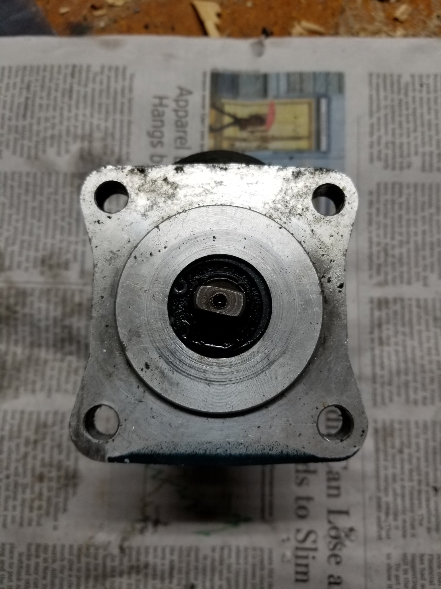

Yea the pictures below capture it the last is the right hand rotation pump purchased. So if I go with the same pump but with left hand rotation should work?
Thanks,

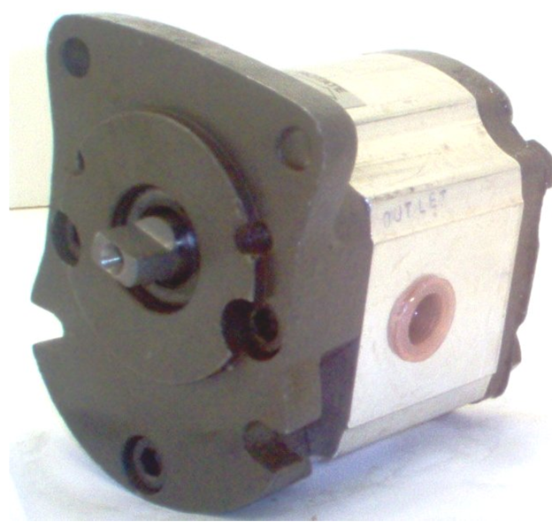

Yes. Whitehouse doesn't take returns, so after I found the LH pump was the wrong one (for my B7100), I ordered a RH one and installed it. Works great.
The difference between the LH and RH pumps are the inlet/outlet are reversed. If you flip your RH pump upside down you will see how the WHP LH pump would mount (although the pipes cannot be connected of course. The inlet and outlet are different sizes).
Here are a series of images of the two WHP pumps. LH pump on the left, RH pump on the right:
If you are interested in my LH pump, send me a PM with your shipping address and I'll look up what that cost would be. I'd like to get 1/2 what I paid for the pump itself.
