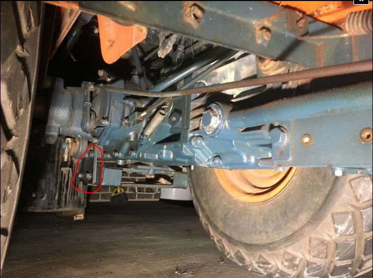

But it looks like the attachment bolts in red would be a great place to tie into.
My axle bars are 2" x 1/2 steel, on that a 1 1/2" C channel should help tremendously, and tie the 2 bars together somewhere upfront to cut down on side flex of the bars.

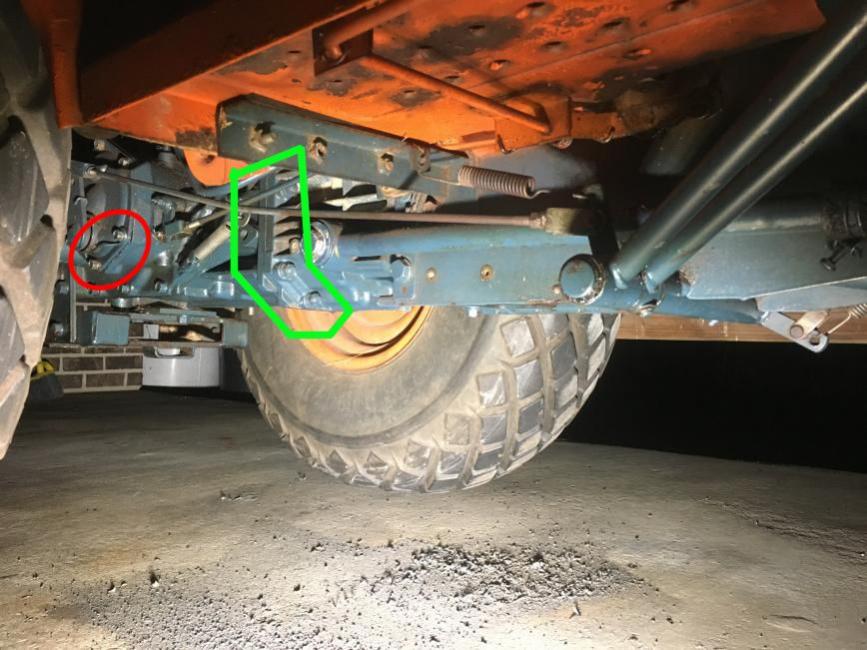

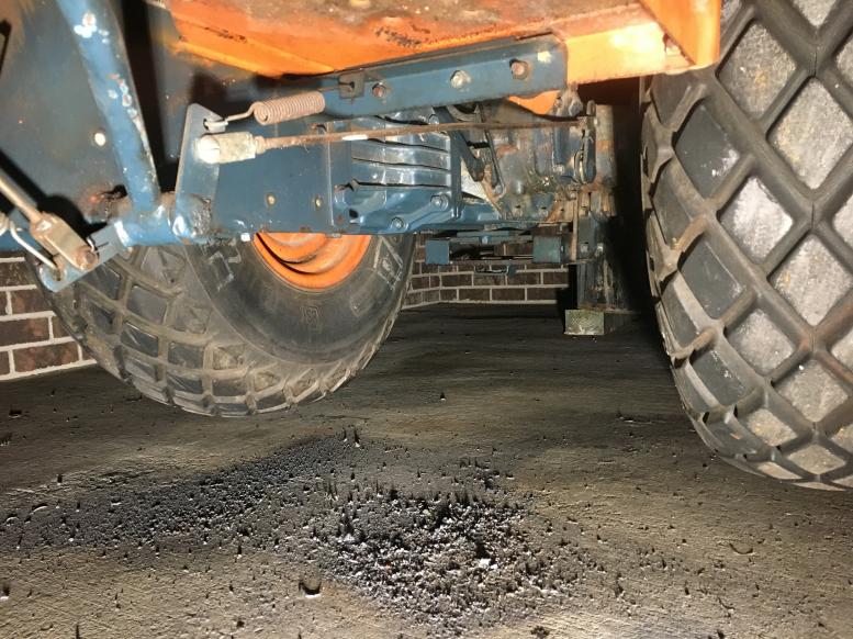

Could I also tie into the mid section right below the back of the step? I circled it in a few pictures. Let me try to understand this better, I am not trying to counteract the torsion from the loader on the big grey beefed up brackets. I am simply trying to help the tractor not split apart when the front has something heavy on it and lifts the back up? Seeing a stock one would help if you could when you get a chance.

You are trying to reinforce the joint outlined in green (below), so you need to tie in behind it. Don't go to the 3ph, but if you meant the drawbar that would probably be OK. I think those are the bolts Wolfman circled. Most Kubota subframes seem to go to the axle, so I would also consider the bolts circled in red:

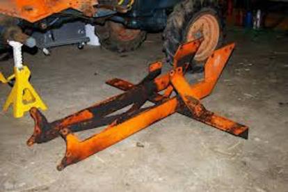

This is the B219 FEL subframe for a B7100. Side plates are 1/2" x 4" if I remember correctly; also note the "X" bracing,
Sorry need to correct you slightly.
The bolts that you point out in red are the brake cover bolts, not a good choice for the bars, you meant lower and farther back which is the axle housing bolt holes, same ones you used on yours.
And the joint you pointed out is not the week one, that joint is the clutch housing (AKA transmission) to rear end joint, the weak one is farther forward in front of the pedals, it's the bell housing to clutch housing joint.
Looking at the parts diagram for the B8200 on Kubota's website, I see what you mean. The brake cover is a separate cover in front of the axle. In the picture it looked to me like one casting.
I thought the idea was to protect all 3 (differential to transmission, transmission to clutch, and clutch to engine) joints by providing a continuous reinforcement from the front bumper to the rear axle? Or is the B8200 different from the B7100 in that regard?
