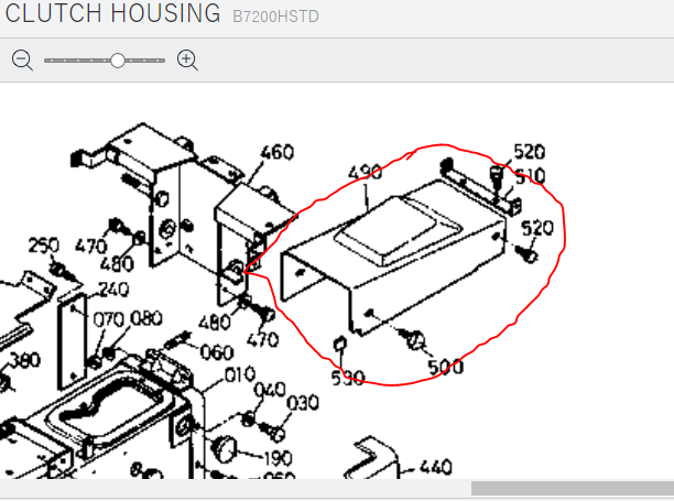

Pull this cover:
Then you will see the propeller shaft
Run it and try and move around, if it's not turning or turning very slow, then it's 100% a bad clutch:
Replace the pilot bushing clutch disk, pressure plate and throw-out bearing while your in there.
