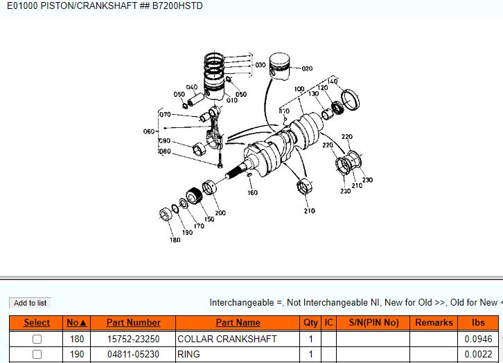

I've worked on quite a few of these engines and you can remove the seal without pulling the case, and it's even easier when you remove the collar, #180 then you just hook the seal from the inside and pull it out.
FYI, You will need to find out which engine is actually in the tractor, as this was one model that had both the D850 and D950 installed in it.
It's stamped into the flat on the block facing up next to the injection pump.
Thank you for bringing this to my attention!! I never would have know until I got into it otherwise. So I need the oil seal for the crankcase and the O-ring for the crankshaft at minimum.
Is the collar reusable, or should it be replaced upon removal? Also, is there a special tool to remove the collar, or can you carefully wedge a tool and pry at it from multiple angles? Thank you, I'm a bit of a newbie when it comes to "internal" engine work. Did a rear main seal on my Mustang once - well, 3 times in order to get it right lol :D

The collar slides off but if it has a wear groove in it, you need the collar as well. Think I'd get the collar and seal.
Ah, thanks for the info. When I saw collar I just assumed it was pressed in. I'll post pics for others when I get around to it. Probably next week as I've got to order up everything I need. Anything else I should consider tackling while I'm at it? Getting real tired of oil leaks :p

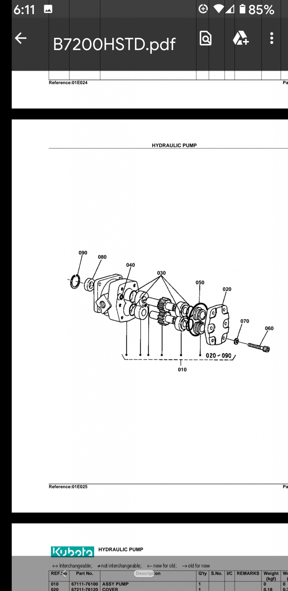

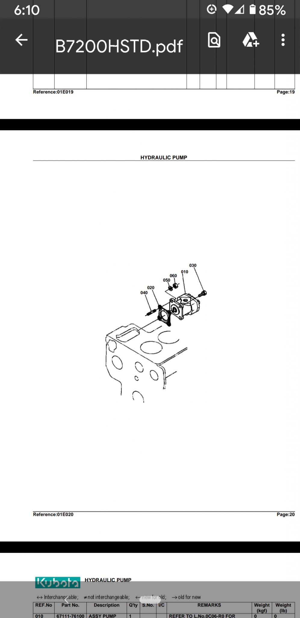

Hello again, got all the parts on order and I realized another issue. I've been leaking oil pretty heavily as you all know. But.. my oil level hasn't changed. It stays right on full. I'm pretty positive hydraulic oil is leaking into the crankcase. Antifreeze level is normal, and I don't smell diesel in the oil. I was looking online to make sure I'm ordering the right parts. Can you guys help me out and make sure I'm getting what I need, also is there anything else you would recommend I tackle now? Thanks.
I'm thinking I indeed parts #020 (pump gasket), and #080 (oil seal) anything I'm missing or incorrect on?
Looks like I might be facing this issue myself. I have to take the covers off and verify the leak location, but it looks like it might be the front seal. The D750A parts diagram looks like the same arrangement, but with different part numbers.
1. How does the collar come out? Just a slip fit -- grab it with fingers and pull?
2. Does the seal wear a groove into the collar -- ie: should the collar be replaced as well?
3. On installation, slide the o-ring and collar in first and then coax the seal lip over, install the o-ring and seal first, then insert the collar, or install the o-ring, slide seal over collar and install as a pair?
By the illustrated parts list yes. The pressure of the pulley is all that holds it. Personally (wrenched on cars and equipment for years). If going to the trouble of the front seal I'd replace it, the seal, and the oring. At the least the belt, fan and the pulley need off. Pulling the radiator will give more access. If my history is a guide the hardest part will be getting the pulley off.
