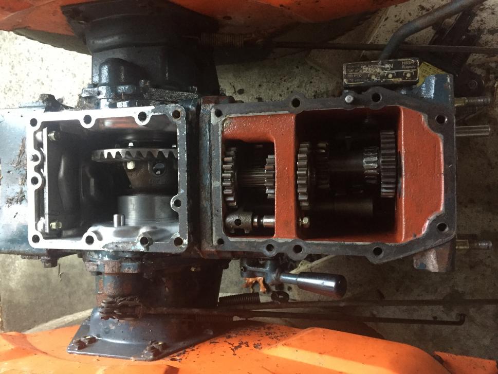

HI North Idaho Wolfman, I just wanted to let you know (hopefully before you have invested any time in trying to document this for me) That I have had some success today! I felt sure that the transmission casing should separate from the axle housing... but try as I might the two wouldn't come apart... I discovered today that they do of course come apart... provided you have remove ALL of the nuts holding the two together... I had missed one that was covered in dirt and grime and partially obscured under the 4WD lever! I feel like a bit of an idiot! As once the two housings are separated, is is indeed evident how the disassembly proceeds.
I'll try and post some pics and more of an update a bit later, but just wanted to let you know so that you don't spend time on this on my account

Just as an update to this... I've got the girl purring like a kitten again.
I managed to find the two replacement gears I needed (2nd Hand) from Wengers at a mere $350 $USD (cough cough) Then I had to ship them to NZ.
Also ordered a complete gasket kit from Coleman Equipment for every join I had taken apart for $60 $USD. This also included a new main O-ring for the 3 point linkage Hydraulic ram... as it would drop quite quickly with the mower mounted on the 3 point linkage, and I suspected that the O-ring was the root cause. I had numerous hours of *fun* reassembling the transmission... especially after sitting apart for the month it took to get the gear together. Eradicating the metal flakes from the old gears was not as simple as it i though it would be... including using a powerful electromagnet to extract the metal filings from the hydro-static drive filters... (yes in retrospect I should have ordered new ones of those too.) Reassembling the two halves of the tractor by myself was also an exciting challenge, but nothing a large ratchet strop wasn't able to fix. The PTO now purrs like a kitten and engages both High and Low speed smoothly (unlike when I first brought the tractor 2nd hand) And as a bonus, my $2 O-ring has made a huge difference to the mower staying at the required height without dragging the 3 point linkage down.
