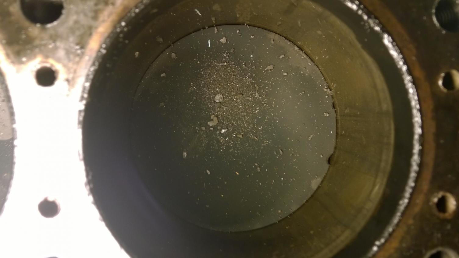

I removed the head (easy) and the gasket looks fine. Given this, I was a bit stumped as to why I was seeing white smoke in exhaust, bubbles in the radiator, and a preponderance of overheating. Then I looked at the block and saw this!

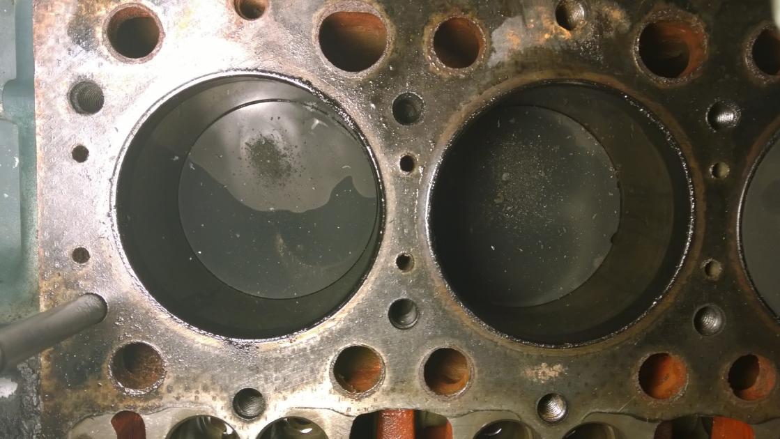

This is the middle piston and clearly is chipped. Somehow this debris has traveled to the first piston too (note the last piston looks great):
Does anyone know how this can happen? Ether? The prior owner said he never used it (and I never have either as the machine starts right up and I know it is bad for these engines).
So, can people advise me on how to proceed? As it stands, I am currently removing the oil pan to see if I can pop out this piston from below while the block is still in the machine. I would like to prioritize solutions which keep the block in the machine (if possible) and costs/time to a minimum. Plus, I am doing this all myself and as the title suggests, everything is new to me here.
The tractor has 1700 hours or so and the cylinders still have some cross-hatching. Should I hone the walls or can I get away with just popping in a new piston?
Should I worry about replacing/honing all pistons or just the middle one?

First before you go any farther pull the head gasket off the block and take another set of pictures of around the middle piston and a set of the head too.
The debris is pieces of piston and carbon that have steam fired off the center piston.
When it goes to redoing it, just buy a rebuild kit and do all three pistons and bearings, other wise you'll be kicking yourself later.

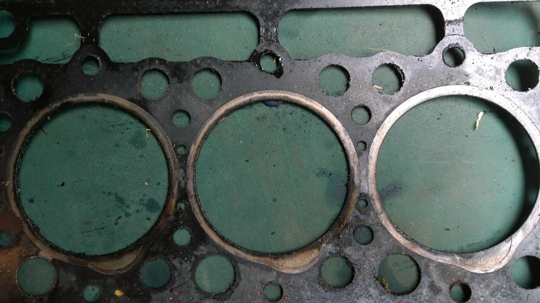

Ok: if i am going to do one, I'll do em all! Those kits seem reasonable too, give the cost of just one piston/rings.
Here is a pic of the gasket:
And here is a picture of the head:
The head has carbon on it which brushes off easily. Using a straight edge and my feeler gauge, it looks like it is within tolerances (done after cleaning head in this pic).
32,922
8,379
Just by the pic's what I'm seeing is just plain old head gasket seal failure.
Get a long file and surface the head and block and look very, very, closely for any signs of a crack.

Thanks for your quick response. Just to clarify, are you saying I don't have to worry about the chip in the middle piston?
32,922
8,379
No I would still pull the pistons, hone the cylinders, the water/steam damage is pretty great on that piston and you wouldn't want it doing a total failure while running. ;)
