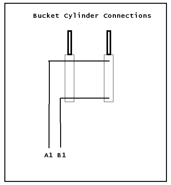

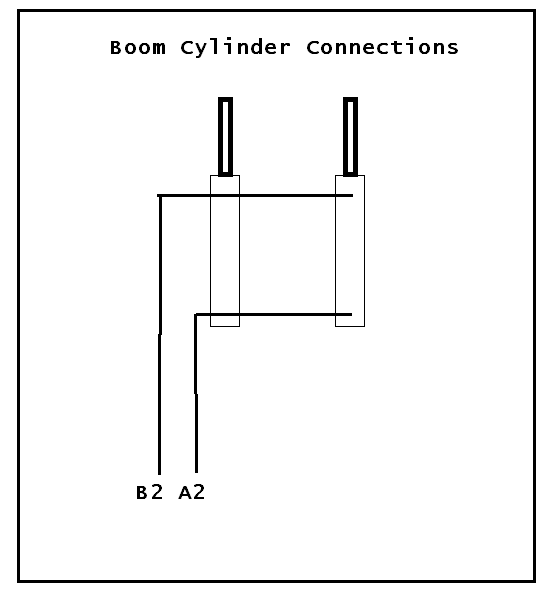

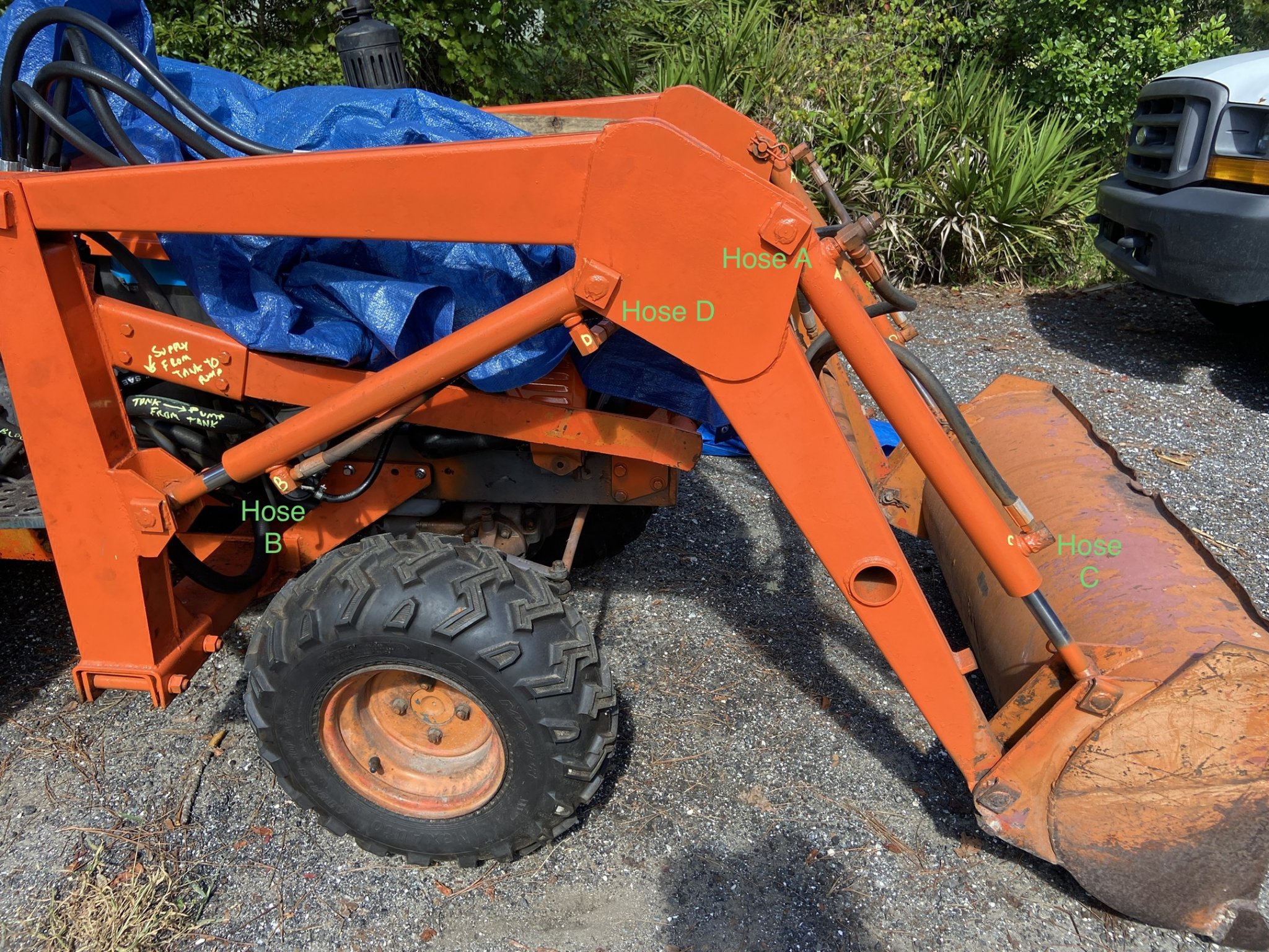

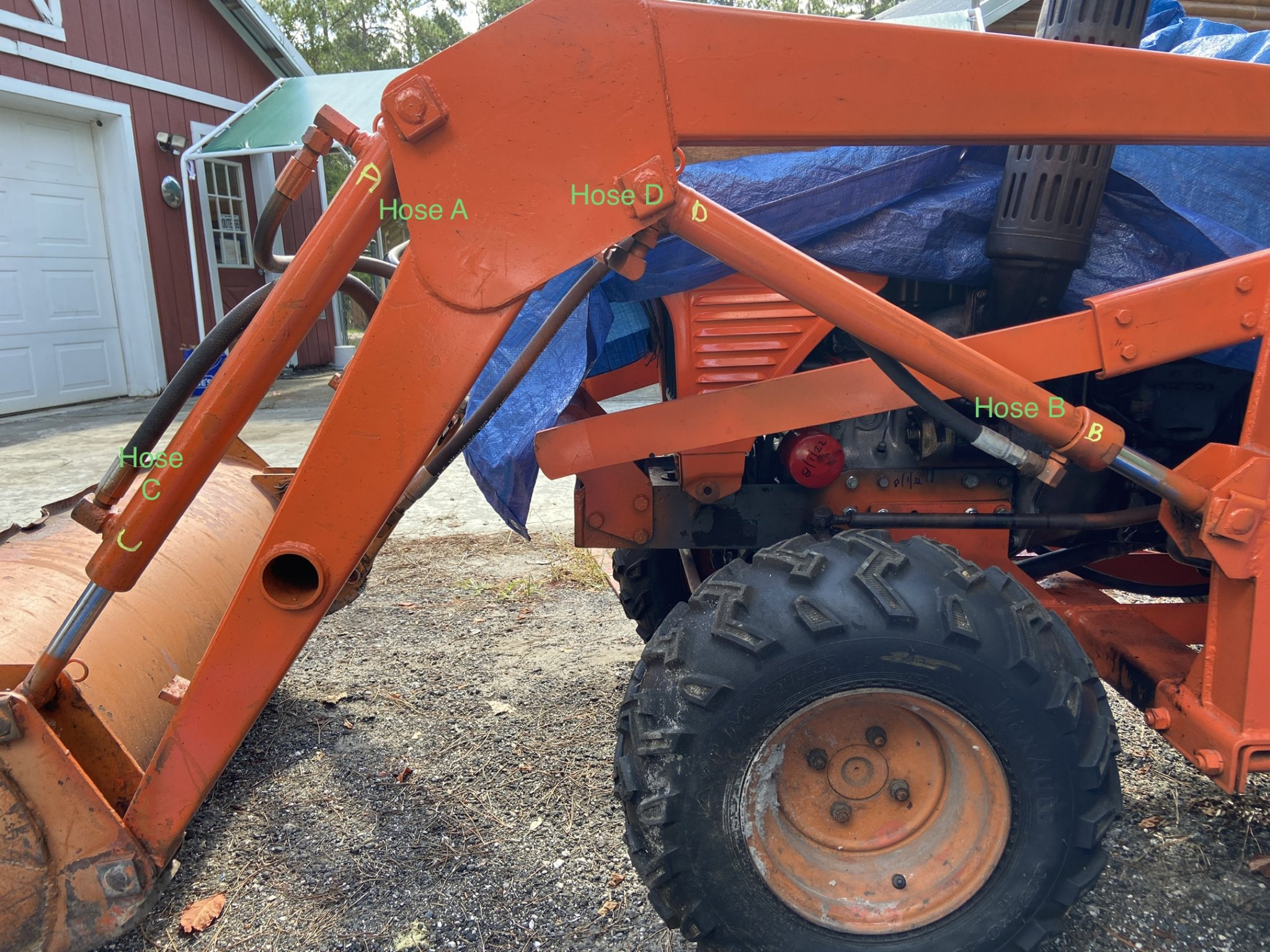

Please post a picture showing both bucket cylinders and the hoses that connect them. All in one picture so we can see the routing not just the ends.

Yes we covered that part of the plumbing in detail already.

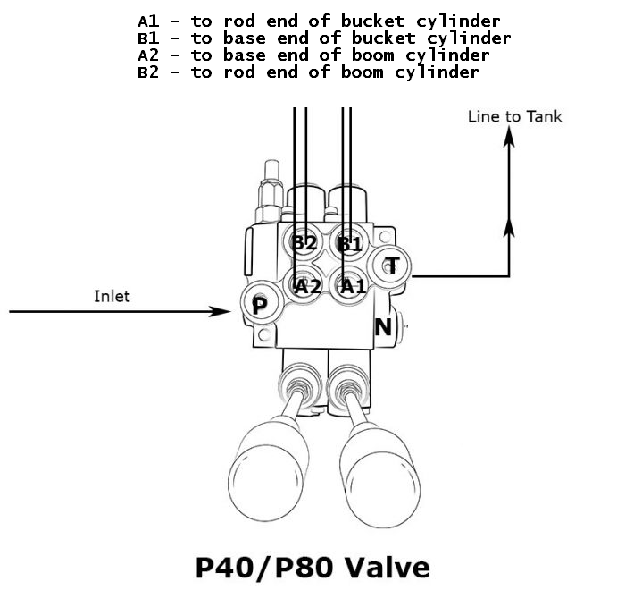

Here are a couple simple diagrams of the valve and plumbing.
Double and tripl;e check your plumbing against these diagrams. Follow each line from valve to 1st cylinder then across to second cylinder and confirm they are routed exactly as shown in the diagrams.
Left lever operates boom - pull back to raise, push forward to lower
Right lever operates bucket - pull back to curl, push forward to dump

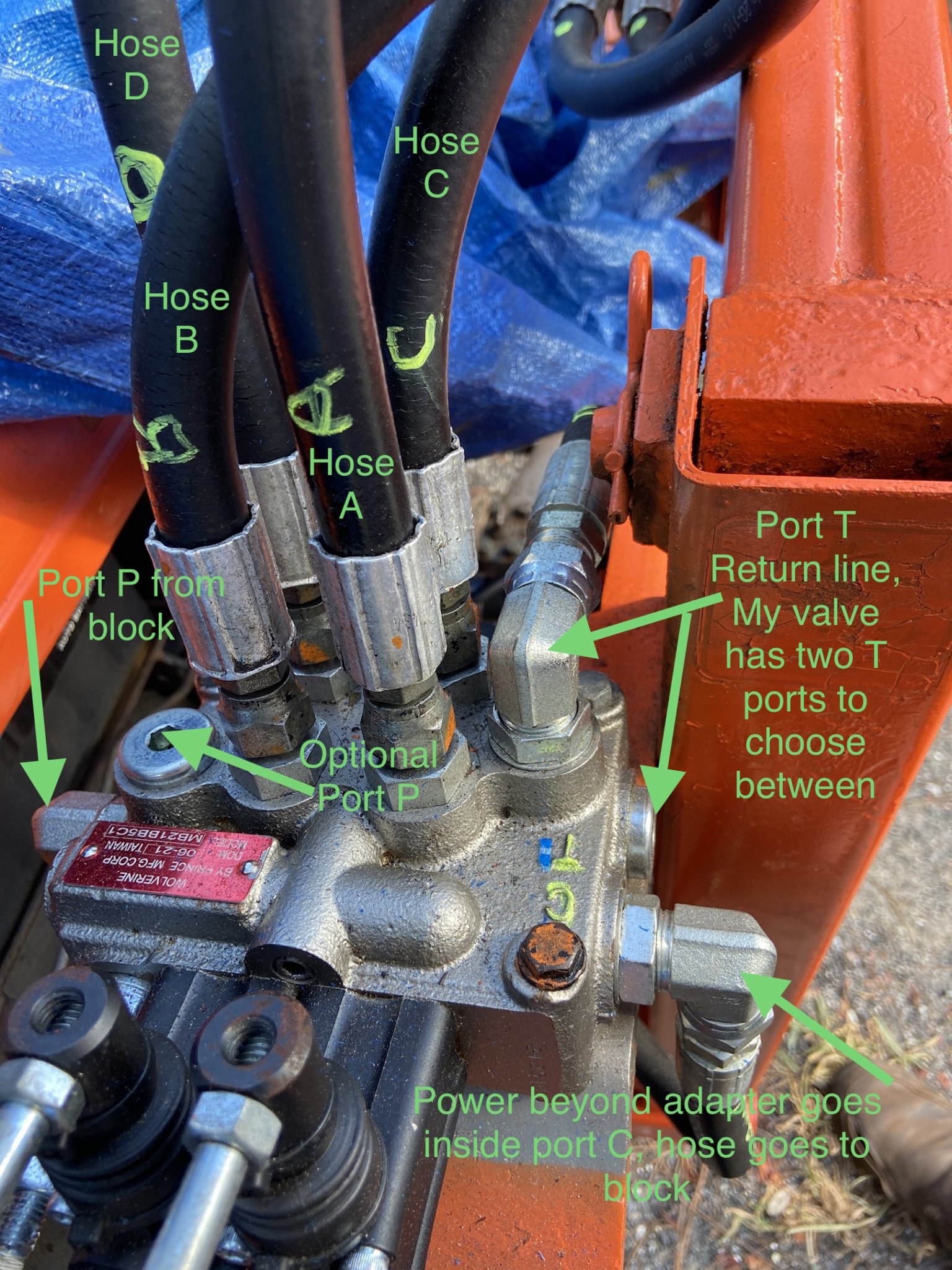

Not to jump on anyone’s toes, but here’s how mine connects.
Where do you have you 2 port from hydraulic block going to? Do you have your T port from control going to fill port on transmission? My tractor is just like yours it’s a b7100 manual transmission

W
His valve has power beyond and his T port is going to transmissuon filler. That is not your problem.
