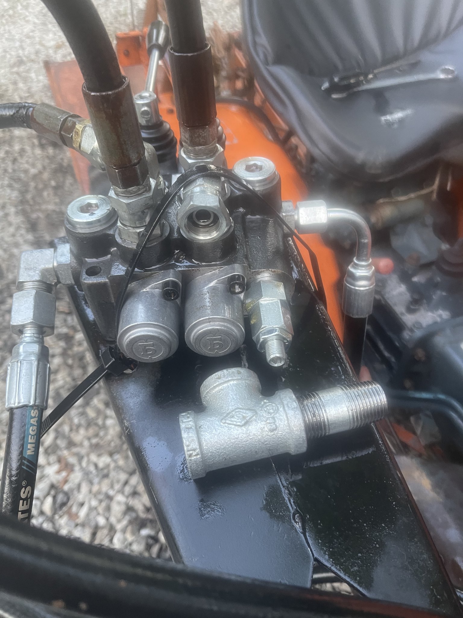

Ok yes I have traced it 3 times and it is exactly as your diagram. My only question is the T does the line from the second port on the hydraulic block go to the T port?
The second port on the hydraulic block is pressure return for the 3pt. Technically you should not use the T port on your valve for that purpose but as configured it will work.

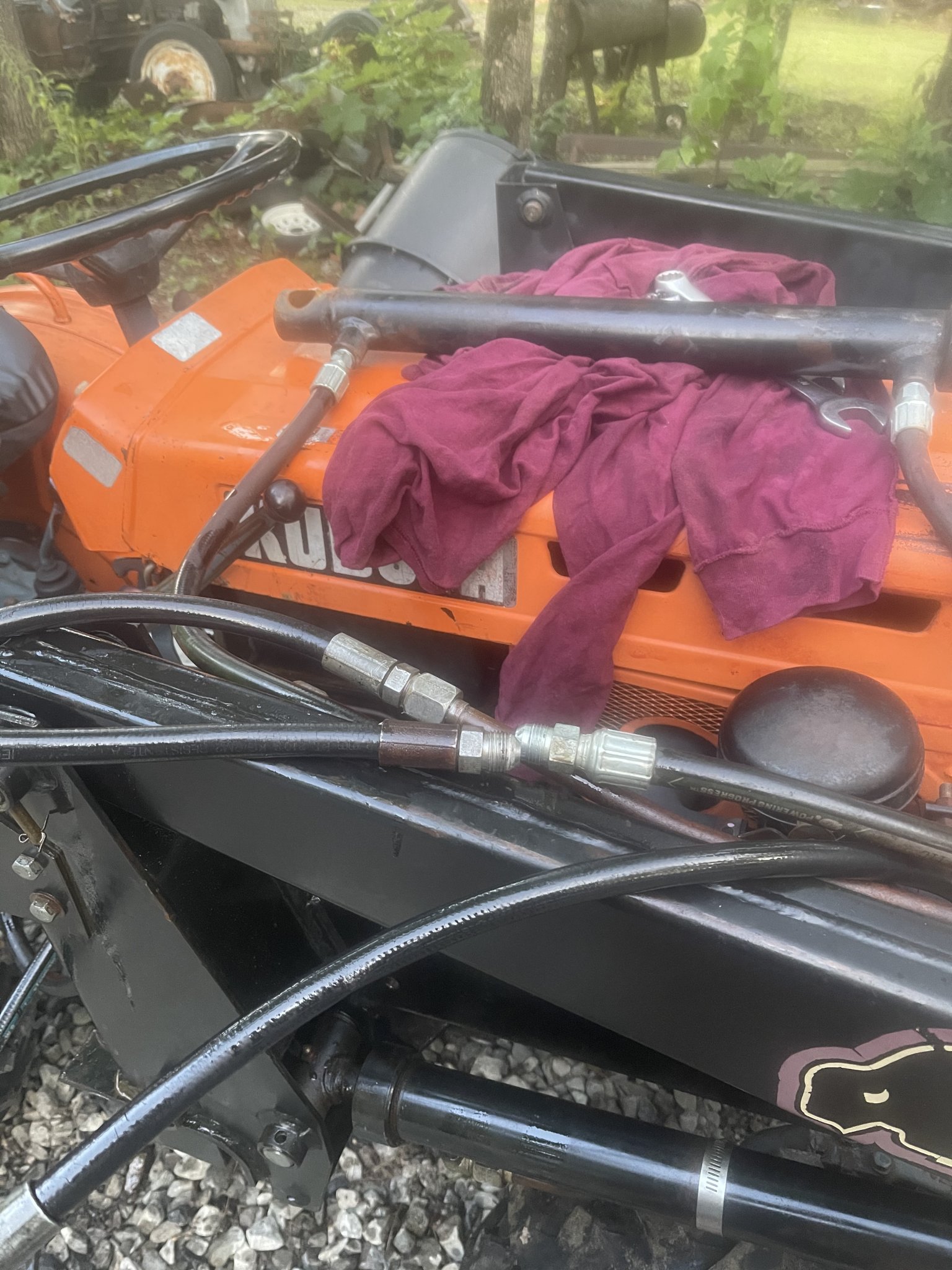

Ok this is what it’s doing it will tilt and dump the bucket but when you return to neutral it falls and the boom will move about 1 inch each direction and that’s it and that’s with 3/4 throttle

I don’t know but when I tilt the bucket all the way back and return to neutral it falls back down or in other words the rod goes out extends on its own

I don't doubt your observation. There is an explanation but the only way you will find it is by controlled diagnosis. You need to isolate and test your individual components and plumbing. Right now you dont know what parts of your plumbing is right and what is wrong.

It has me confused and to add to the confusion I can raise my boom if I slightly pull back on my 3ph lever and pull my boom lever at the same time and if I let go of my 3ph lever while holding the boom lever back it will fall to the ground

You are not going to find the problem without simplifying the system and testing one component and plumbing at a time.
13,242
7,472
Ok plumbing is correct. Next step?
Remove ONE cylinder from the loader and connect it directly to the left spool on your valve with the two hoses currently connected to A2 and B2. No other loader plumbing or anything else on the circuit. Cycle the cylinder fully in and out a couple times and verify it holds at mid stroke when the lever is in neutral. If everything checks out we know the pump, hydraulic outlet, and loader valve are working.

Where do you have you 2 port from hydraulic block going to? Do you have your T port from control going to fill port on transmission? My tractor is just like yours it’s a b7100 manual transmission
On my B7100D, the rear most port on the block connects to Port C on my controller. Like Oldhokie said, this powers the three point. Hence, the name Power Beyond, it sends power beyond the loader to the 3 pt. Port C is where you should have a power beyond adapter. They are very small and you might have thrown it out with the packaging.
The front port on my block connects to Port P (inlet pressure line, or power) on the controller. And as OldHokie said, Port T connects to the tank filler.
The power beyond sleeve is not included with that Summit valve. It has to be ordered separately. The valve will power the loader fine using the T port as the power beyond return. This is not his current problem.
It didn’t come with the PB plug I can buy it separate didn’t think I needed it but I might need it after all.
I ran into a problem I can connect the hoses I guess I will have to get some kind of connector to do that test.
