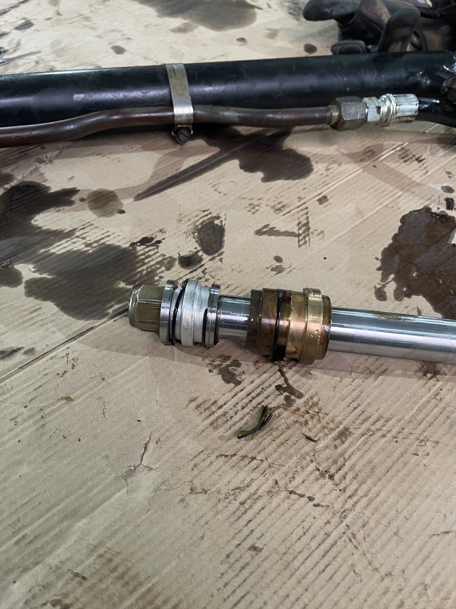

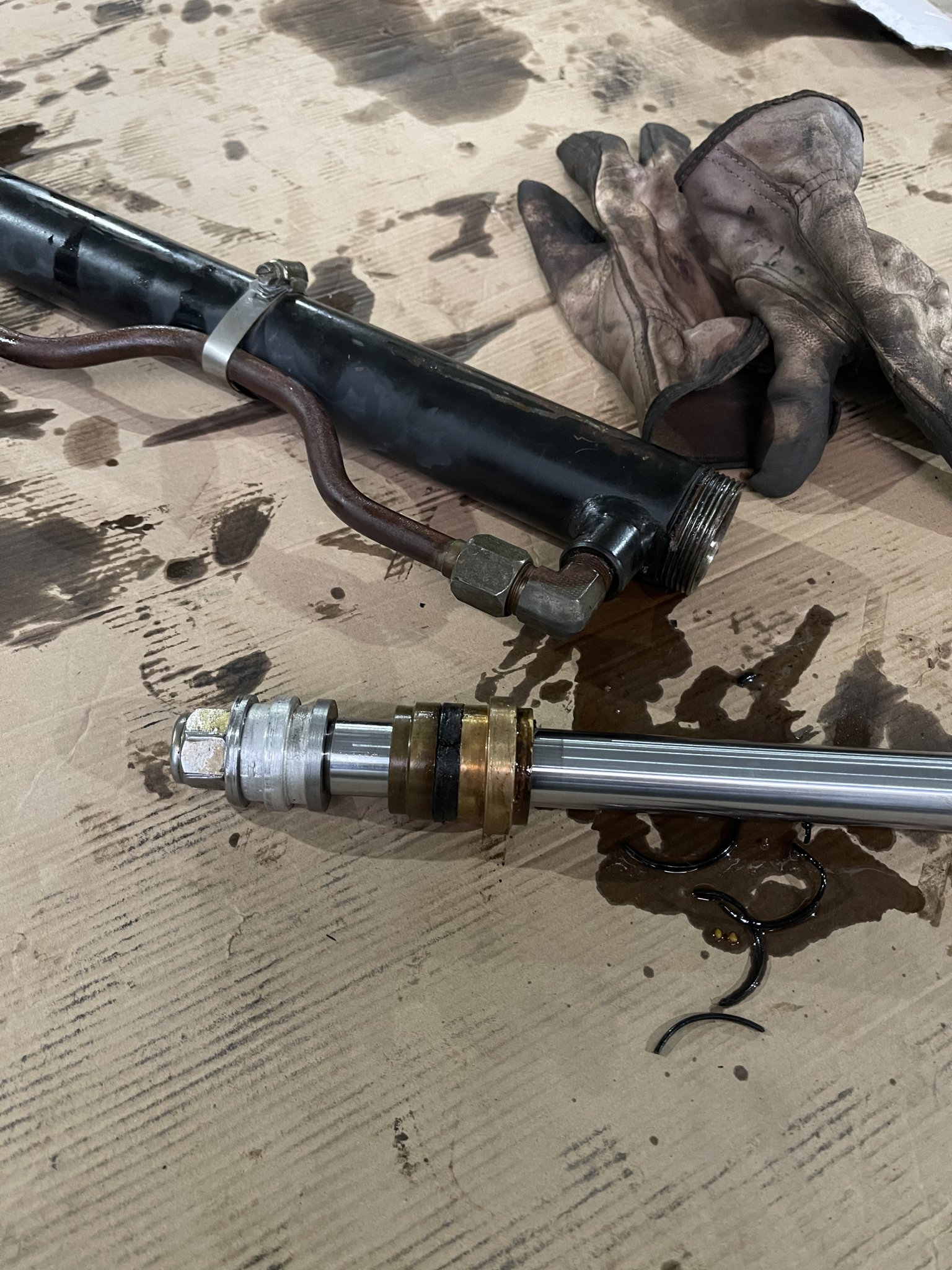

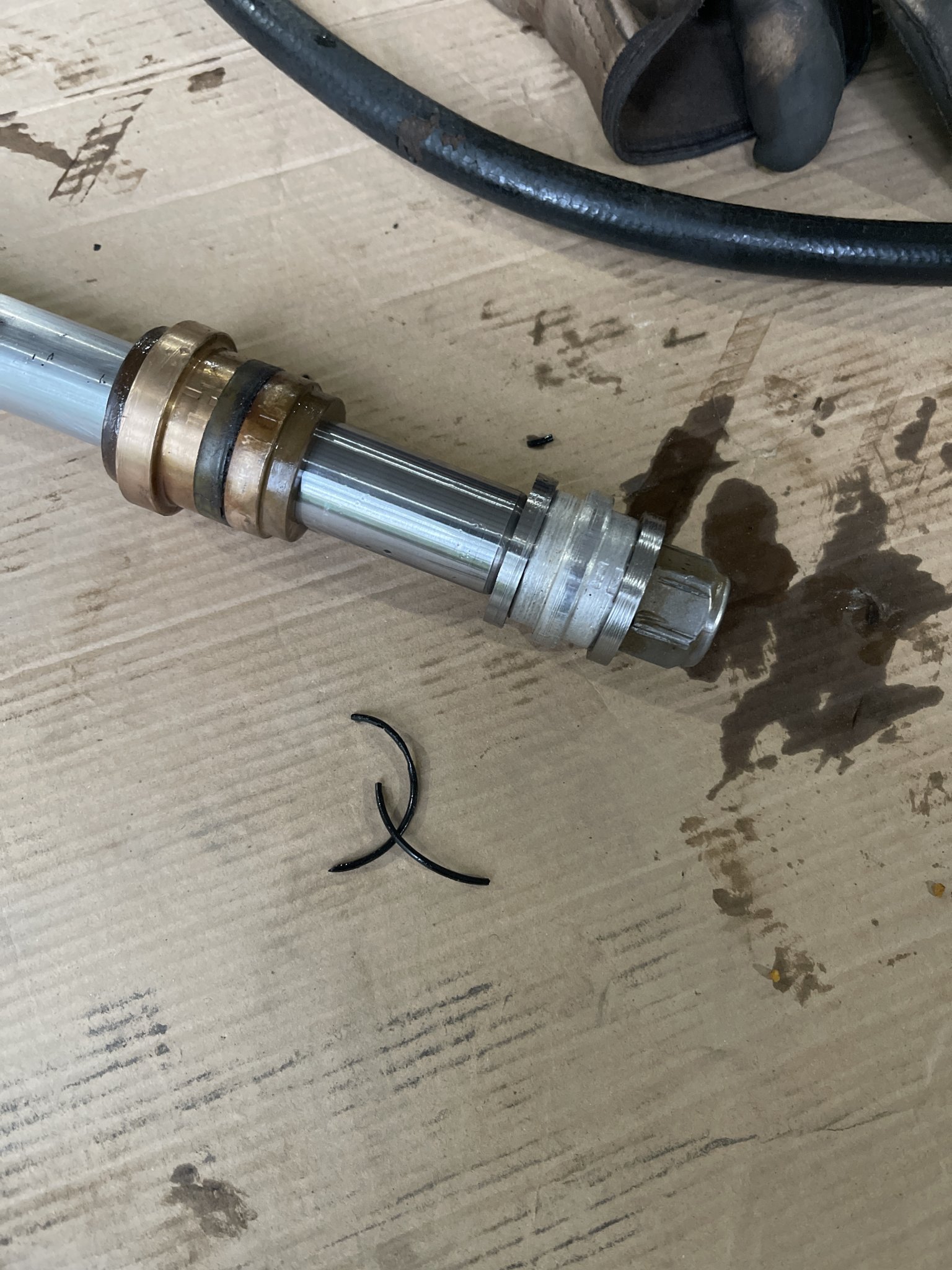

Im not a hydraulic gooru by anymeans but id say your missing some o-rings on the piston. If your going to rebuild the 3, rebuild all four and call it a day. I bought the special tool to install the inner seals but didnt need to use it, it was simple enough to wiggle them into place by hand and a little oil.
Like oldhokie mentioned earlier, its not too much more to purchase brand new cylinders for these machines. Seal kits for my loader were 80 bucks each from kubota, some have taken the seals to a hydraulic shop and had the old ones matched for far less. Or a new cylinder was 150 bucks or so and you dont have to do any of it except install them.
