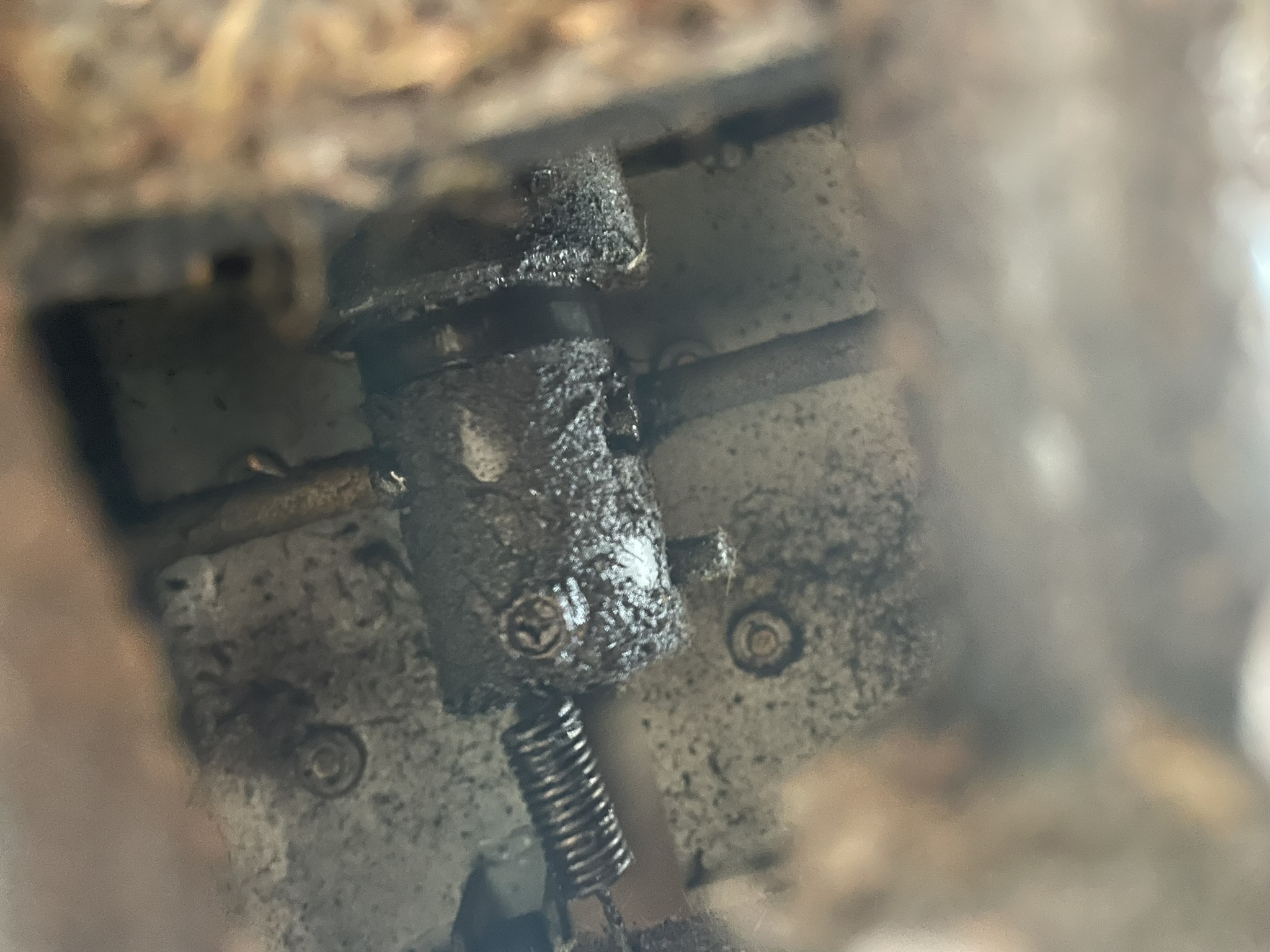

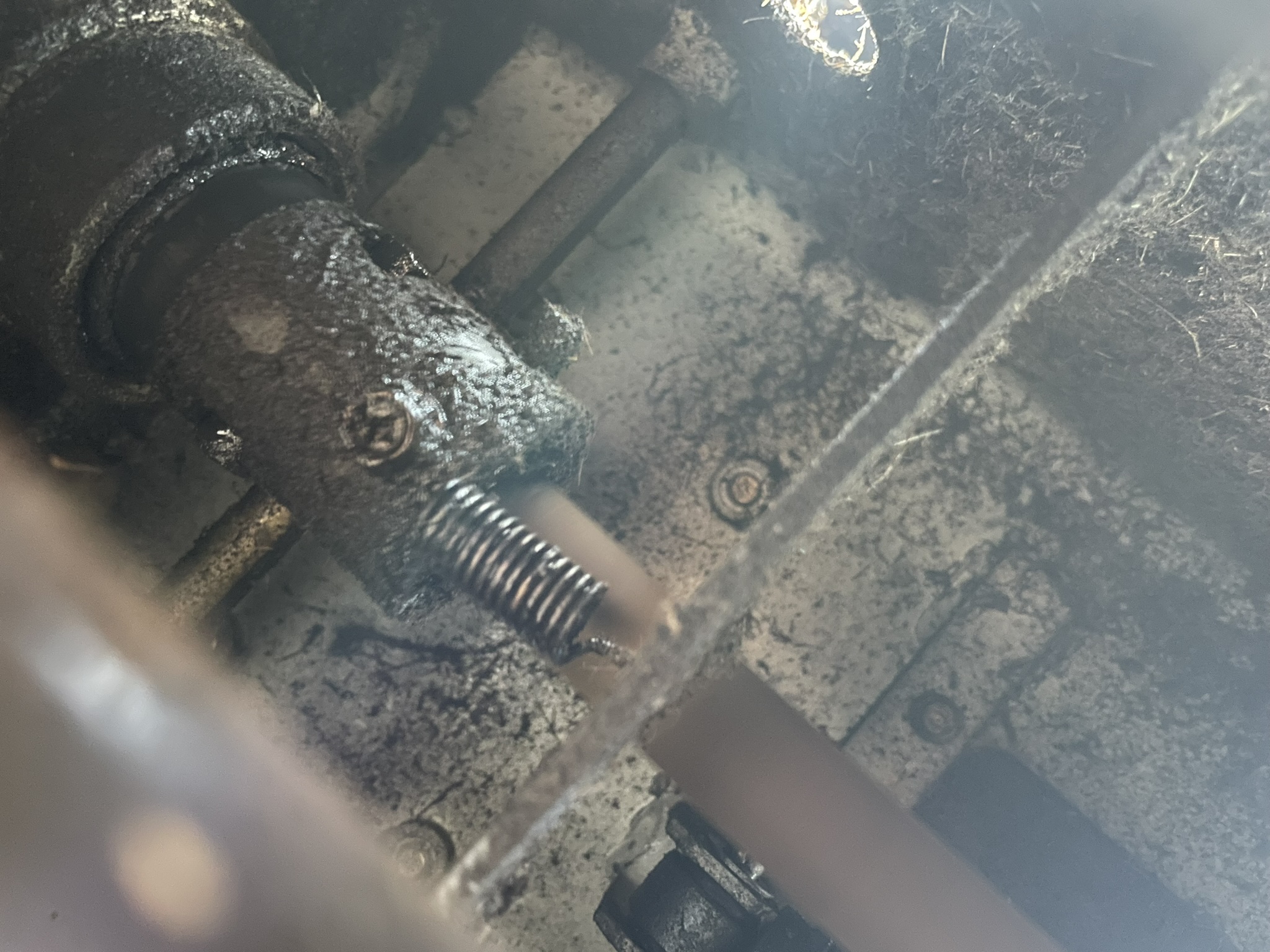

I used it again off and on for most of the day, didn't make the noise at all..
When it was doing it yesterday the noise would go away instantly when I pushed the clutch.
I have no idea what this is supposed to look like..
Took off the cover today and got a video.
Thanks for the replies

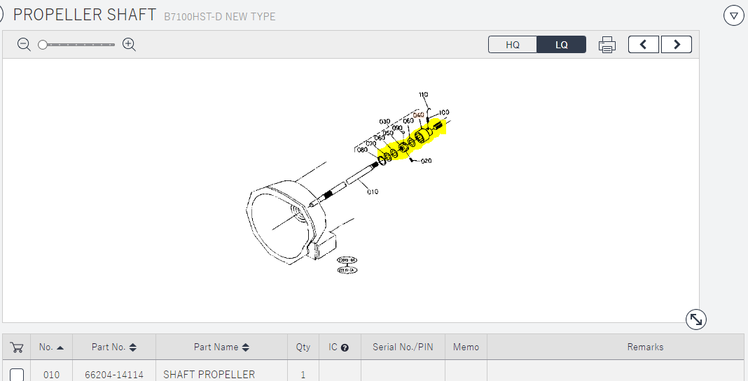

The hub piece with the wire that rotates on the shaft has 3 or 4 steel balls the size of a pea that function like a flexible slip joint. The piece with the wire should have a roll pin in there to keep it tight to the shaft and the wire helps to keep the roll pin in place. The components wear over time.

Please forgive me for warning about the obvious but I get cold chills when videos are posted of rotating shafts. When folks advise checking for slack or rattle THEY MEAN YOU SHOULD DO IT ONLY WHILE TRACTOR ISN"T RUNNONG. Don't even touch the shaft or related pieces with a stick or screwdriver while it's rotating.
Ok I feel better now. I don't see anything unusual other than all that grease from over greasing the throw out bearing carrier. As wolf said see if there's looseness in that fist size coupling. If you hear rattle when moving shaft make sure it isn't coming from T O bearing carrier which would be normal. The bad news here is that it's looking like a tractor split regardless what is rattling. Until now I haven't heard of anyone being able to replace that fist size coupling (ball joint) without splitting tractor. Whether you plan hiring someone to fix it or diy I suggest getting a shop manual now to start familiarizing yourself with what to expect and how to evaluate wear on various parts. Reason being that unless clutch and pressure plate are in excellent condition it's generally wise replacing them while tractor is split. Ditto for prop shaft, t out bearing, pilot bushing ect. Just for the record and help folks know how to respond if a split is required, do you plan diy or hiring it done? Several here have performed splits for various reasons so searching terms like clutch, pressure plate, pilot bushing, split and such will turn up a generous amount of reading to help you better ask questions.
