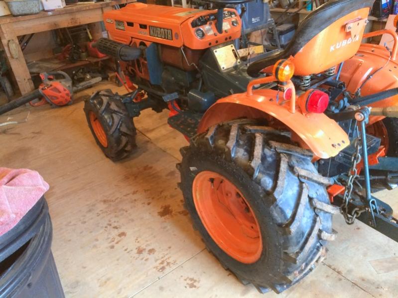

thats looks like a mean machine! Those tires are awesome - ifn you dont mind me asking, what did they cost turn key?
Jimc3165
1982 B7100 HST-D
Jul 22, 2015
130
CLEVELAND, GA
Jim,
The fronts was 130 for the pair on ebay and the rear was also on ebay sold by Summit Racing equipment and they were 190. each, shipping was free and with tax all came to 585.00 then I paid another 56.00 for mounting and disposal, not cheap but am real happy with the result. I was really impressed with the better traction. The Georgia red clay is really sticky and slick so the turfs were worthless.

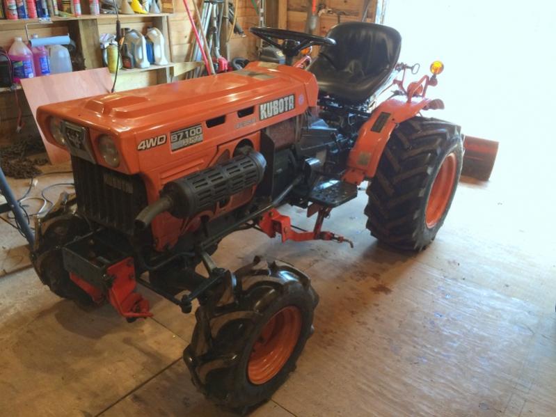

So, from the other post, these are the sizes you got:
Rear - 29 x 12.50 x 15 (RC = 88 inch @ 15psi) Carlisle TRU POWER
Front - 20 x 8 x 10 (RC = 62 inch @ 25psi) Kenda K378
I wonder if they would work on my B6100? I don't know if the front/rear gear ratio is the same as the B7100. Anybody know?
I would really like R1s, but can't find rims to fit. These would work with my existing rims.
28,726
5,134
EDIT: NO, it's the same ratio on the axle, but different ratio on trans,
So you could change to:
Fronts - 21 x 10 -10 with Rear - 29 x 12.50 -15
or
Front - 20 x 8 x 10 with Rears - 27 x 8.5 -15 . ;)

That's the exact same setup that I have on my B7100, and I love them! Best money spent, yet, on my tractor- right up there with the upgraded rear hubs.

I mis-stated my cost. Looked it up again this morning and I have 538 and change in the tires. Also like Hodge stated was the best purchase possible for my little tractor. The N. GA. red clay is super sticky and the turf tires would get stuck very easy. The AG tires clean well and provide some traction to move things. I should also mention like the original poster on this upgrade (dunk) I am running 25psi in the fronts because they are 1/2 inch shorter (20 vs 20.5) than the original tire. :eek:

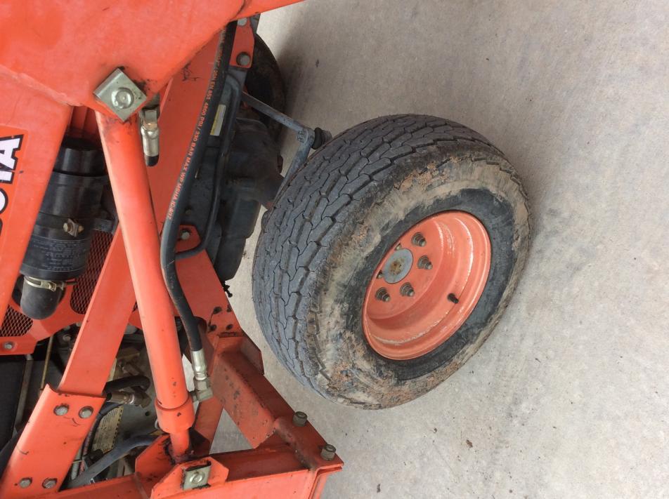

rick sheltra
B7100 4wd diesel w/ Buhler Front end loader
Mar 21, 2012
Knoxville, MD
Hi there Hodge...
My rims are 4 bolt on the front do you think these tires would work with those? thanks Rick

Hi there Hodge...
Rick, I think that the rim size is the same- its just the bolt pattern that's different.

I know this is an older post but I want to say "Thank you!" To Dunk for finding the Kenda 378 and to Hodge for repeatedly posting how well they work. I finally got a pair myself and agree they are a great upgrade from trailer tires! I switched from turf to Solideal "traction masters" on the rear.
