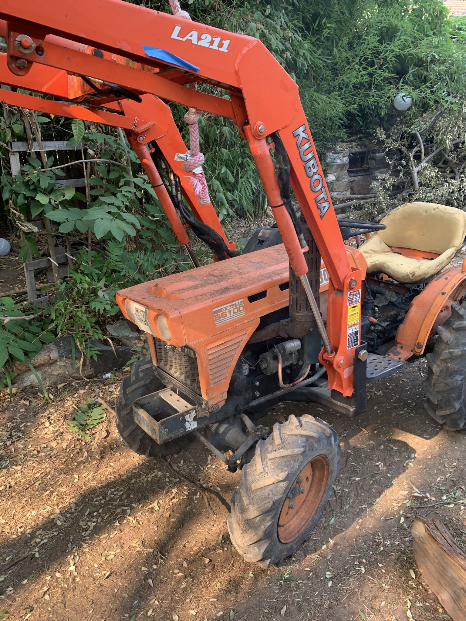

Looking for a FEL for my B7100 Not sure what fits but think is a LA211?

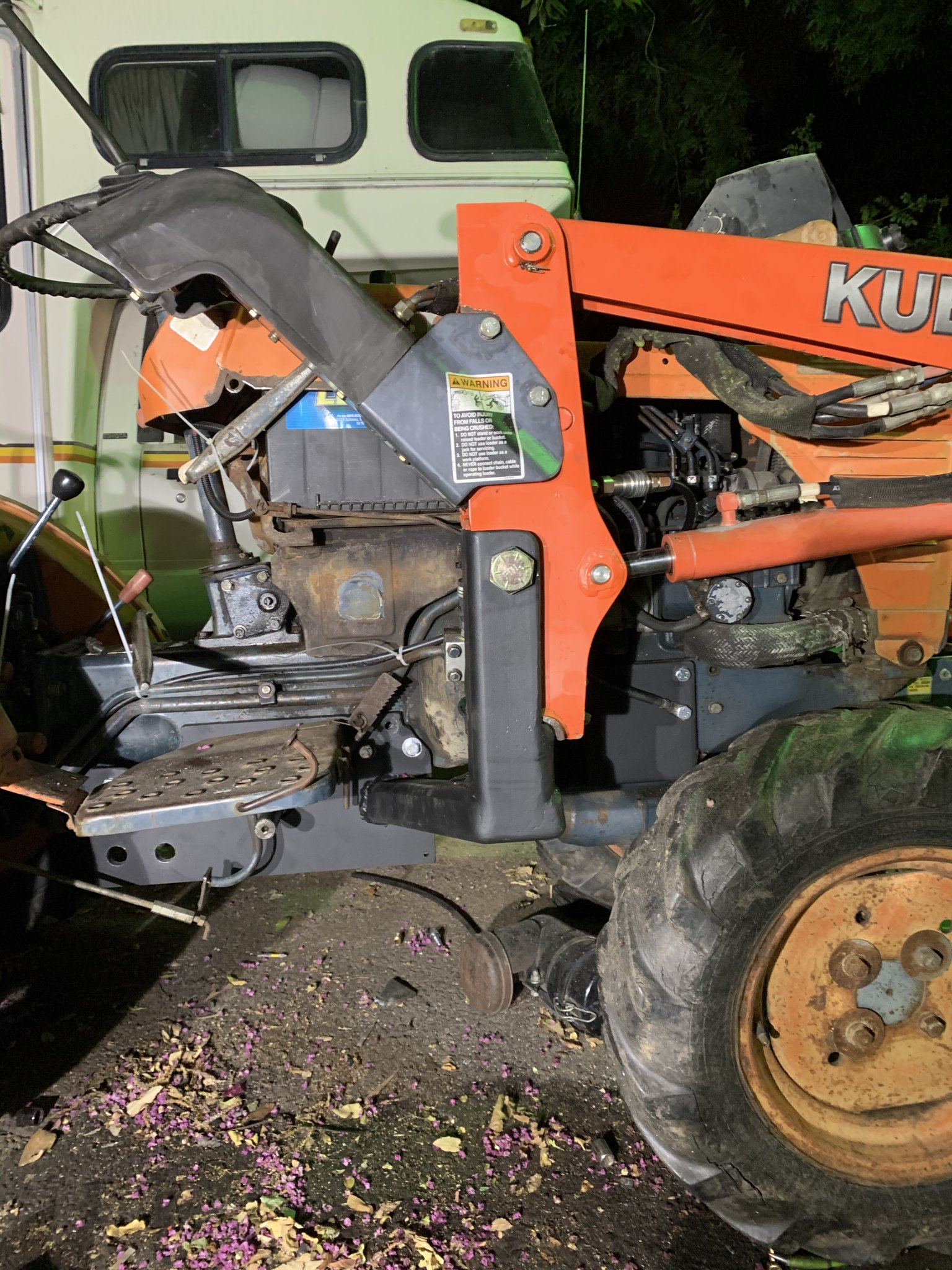

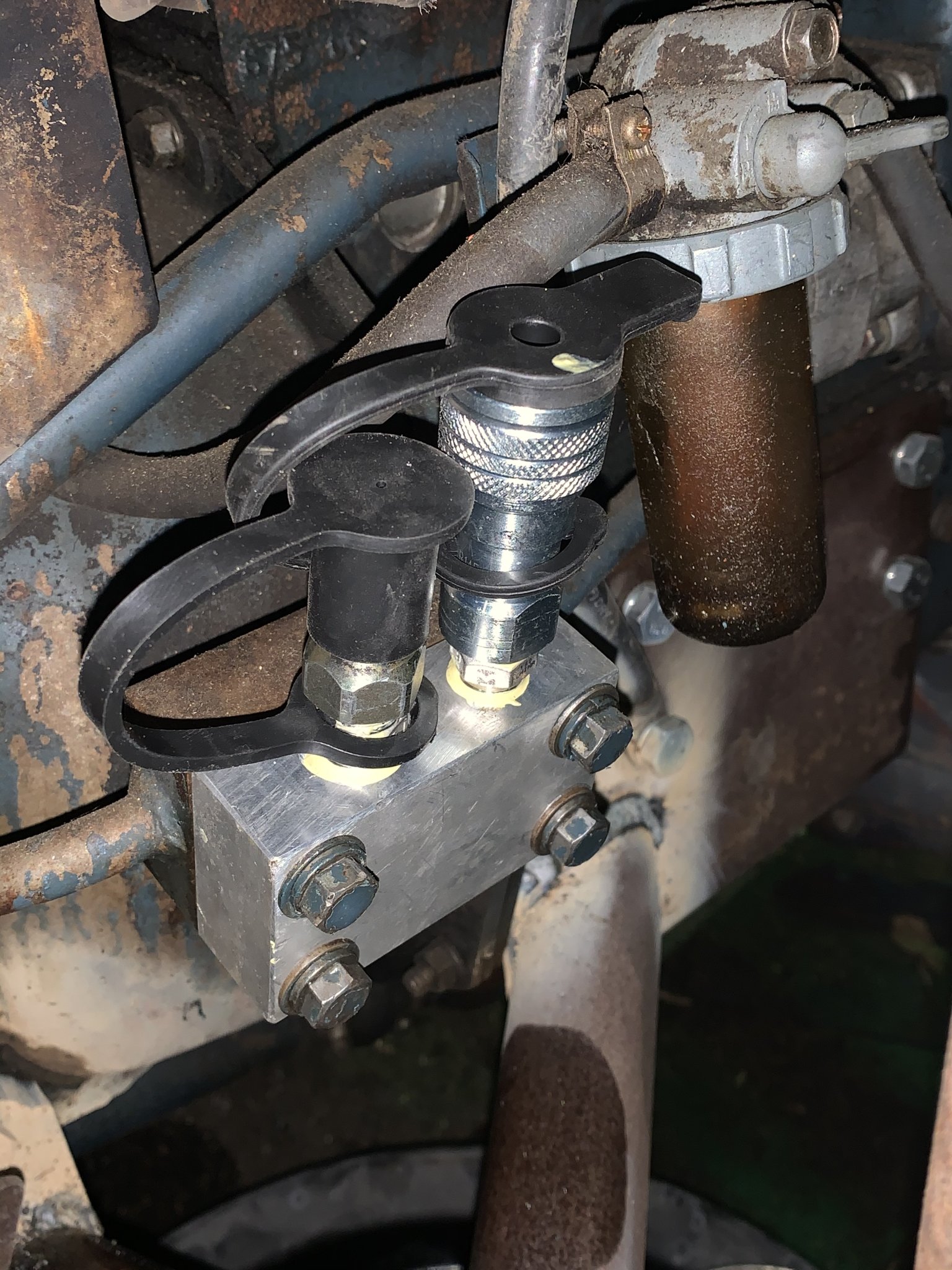

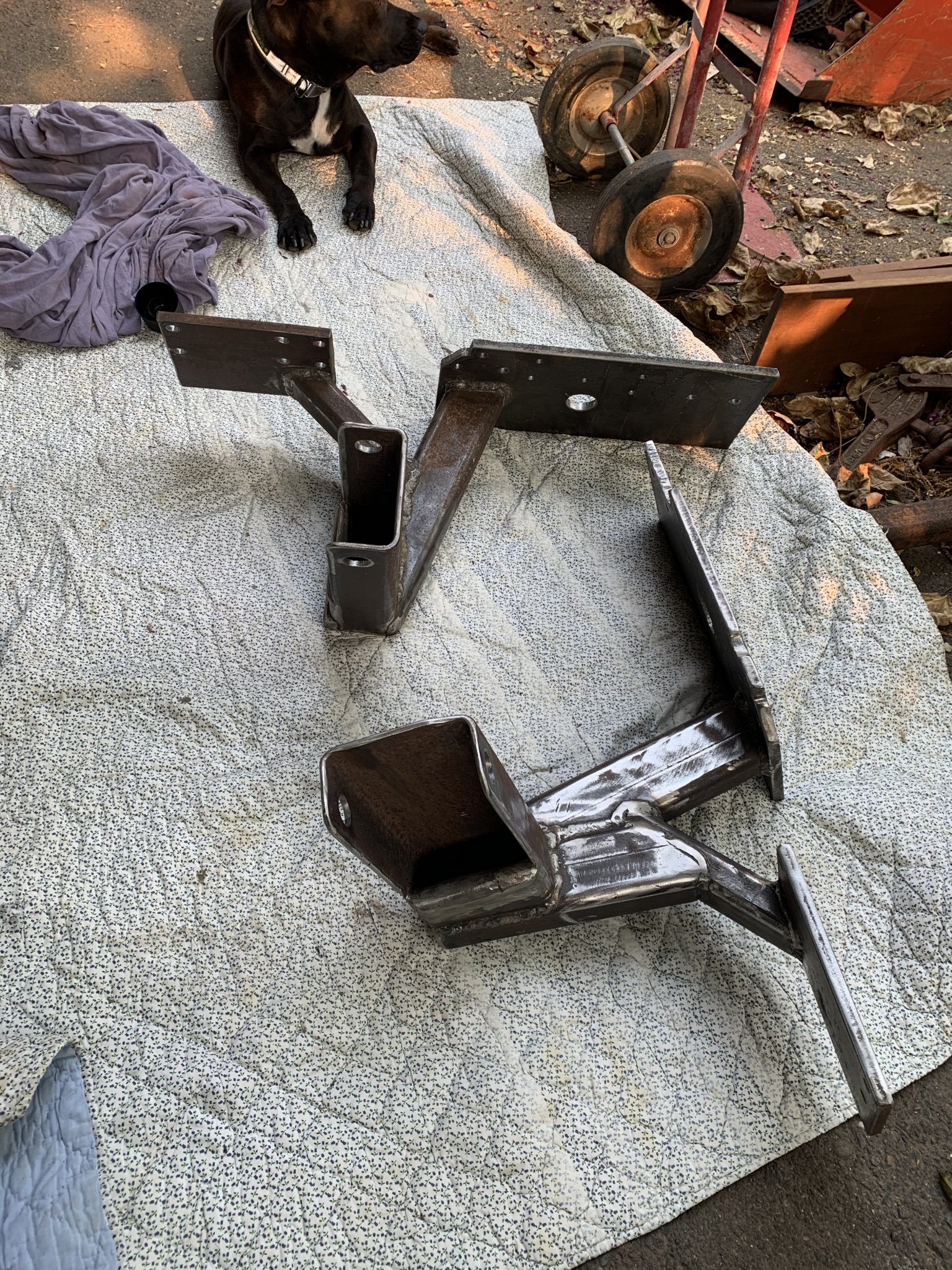

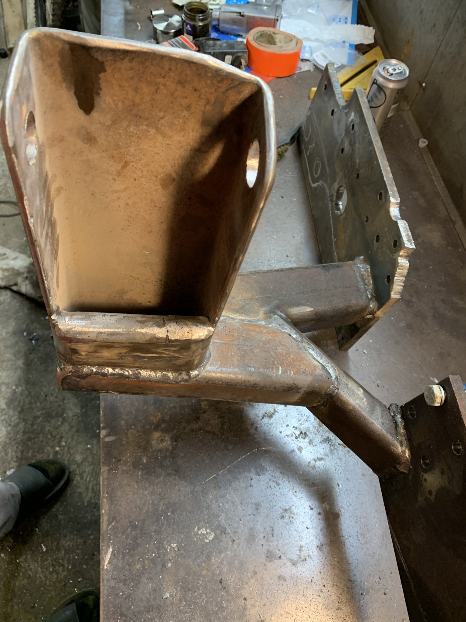

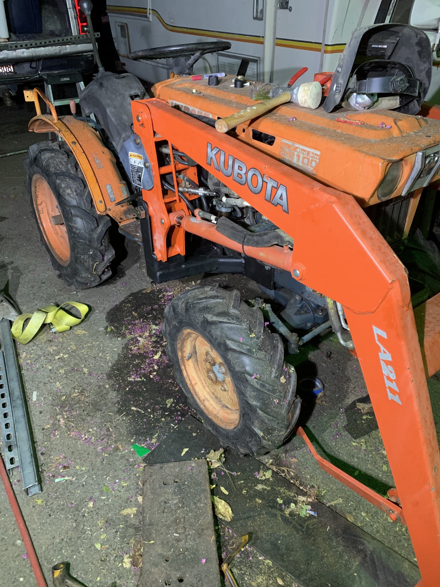

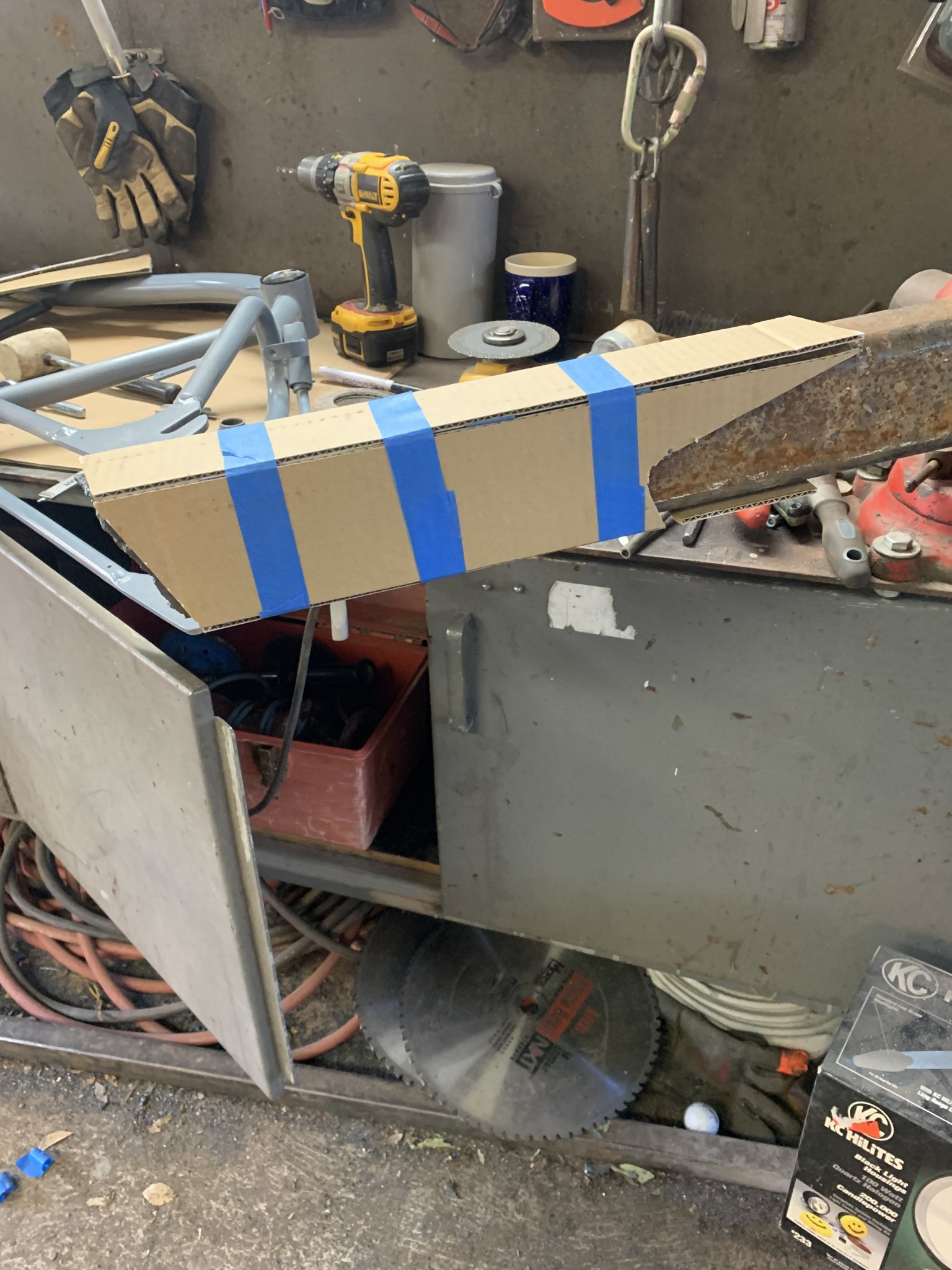

I just finished up adding a LA211 to my B6100. It was not made for this tractor but is a great loader with modern controls. It was a tight fit but is a good size for the tractor. I had to make all the quick connect brackets/frame support and deverter block.I have all the templates for the frame plates and mounting plates if you end up buying it reach out and I will hook you up.

I applaud your adapting it, but a real strong word of warning!
You're very likely going to break the tractor in half without a subframe with rear axle bars!
Seen it multiple times!

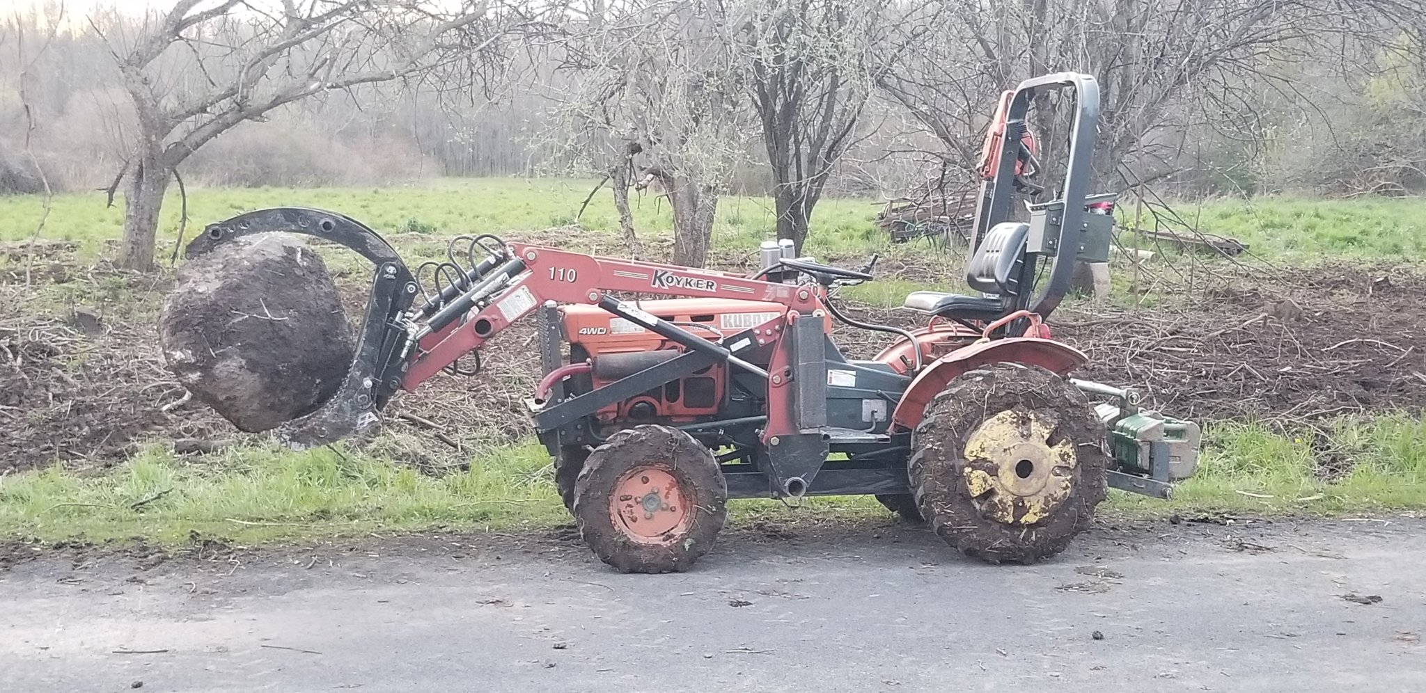

i absolutely love my koyker 110 on my b7100. they don't make the 110 anymore but i believe the 120 is the same loader. lifting power is amazing, you'll want some rear weights. the joy stick is in the perfect spot, atleast for me

Thank you for the heads up! I read that a couple of times and am working on a 3"x3"x1/4" tube that runs from the two 1" holes in the 3/8 plate that mounts to the clutch housing, under the transmission and bolts to the bottom of the rear end. Then up the back around the PTO. I will send some pictures. You can tell me what you think.
What/where exactly breaks? Transmission? clutch housing? Rearend?
33,330
8,670
Clutch housing is Number 1, it's the weak point.
