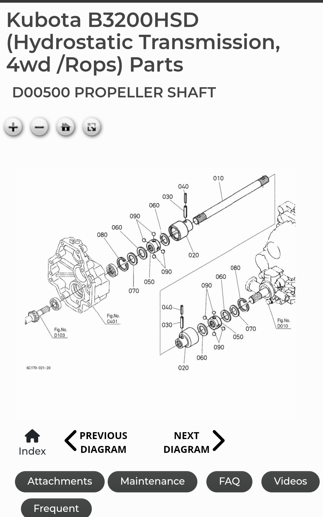

So I went up to my local kubota service and talked about the issue and showed them the video. He said the same thing as previously mentioned in this string that is likely one of the ball couplings such as part (090) provided previously in the diagram. I just started to take it apart after getting it off the mower deck. So with this knowledge can a tractor split get to this part fairly easily or is it in the transmission where I need to tear into that assembly? Or some other assembly that may be a pain? I am on the fence to take it in but at 120 a hour I would rather take care of it myself as long as i dont have to worry about getting stuck somewhere. Any info would be helpful.

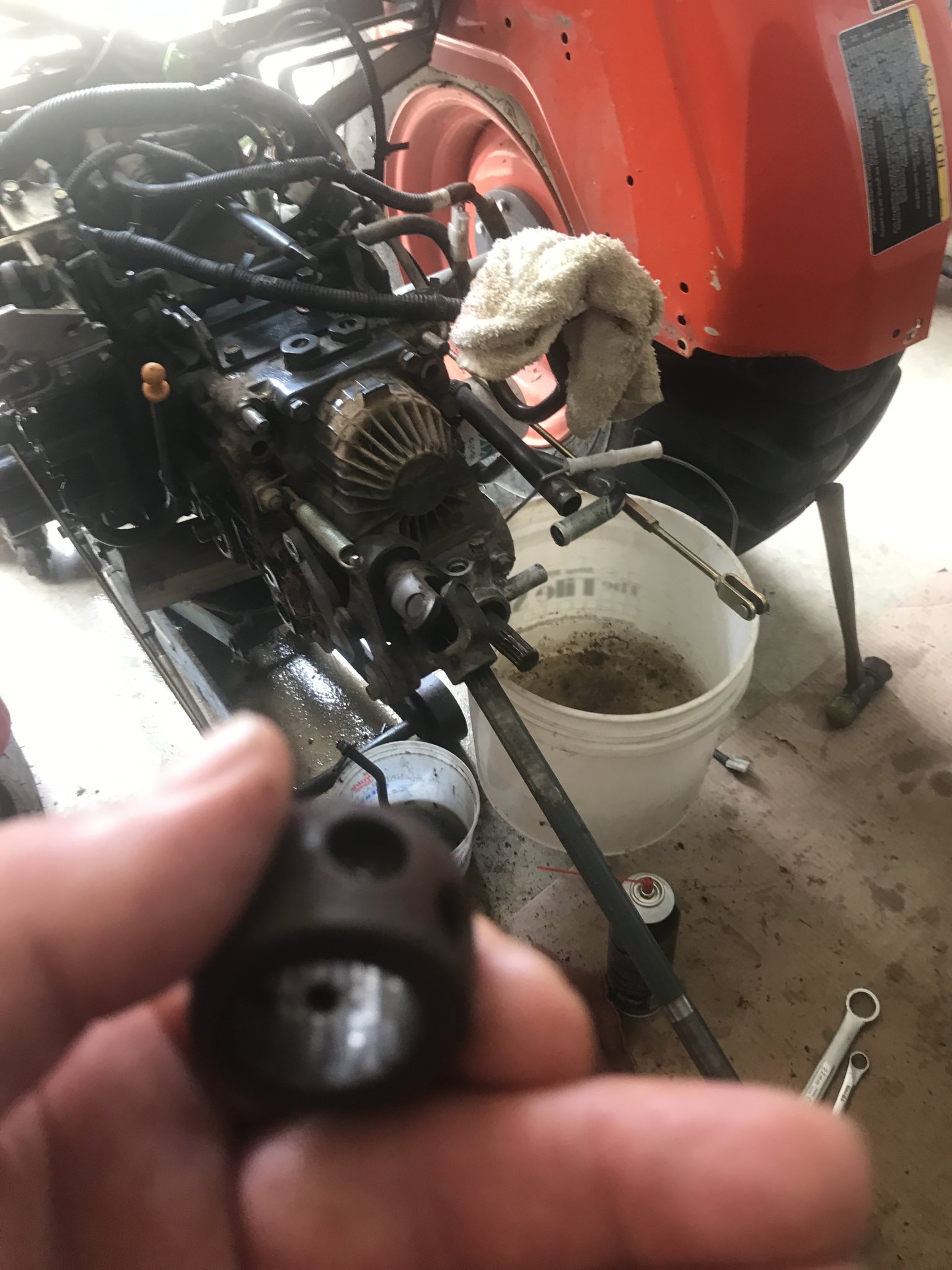

Found the problem. It is the ball coupling. The outer housing for this is trashed as well as also the input shaft into the charge pump. The splines are destroyed on the input shaft in the charge pump. There were only 3 ball bearings in the ball coupling, no telling what happened to the 4th. There are flat spots all over the ball bearings. Looks like they were scuffing within the coupling finally destroying it. I just hope I can get an outer coupler housing and an input shaft for the charge pump. It says where I get parts from, the outer coupler housing is no longer made and I can’t find an input shaft by itself. It just keeps getting worse it seems like.

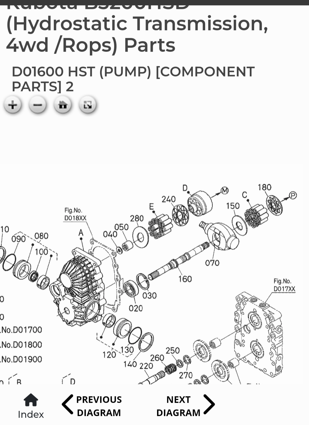

Is 160 not the shaft you need?
32721-35160 SHAFT $153.73

That’s the one for sure. The splines are totally mangled on the outside of the charge pump. I found a new one too for the same price as you posted. I had to use a puller to remove the ball coupling from it, it was bad.
I overlooked the diagram originally showing the #160 shaft and I was under the impression I couldn’t buy one. After looking at the diagrams again I found it. So I’ll be ordering that today. I still have to take it apart to get it out. It’ll make a good paper weight I guess. I’m also replacing all the hydraulic hoses, especially the hidden ones because I don’t want to have to take this apart again any where soon. I bought this tractor new in 2009 and this is the only thing that ever broke. It’s also been kept in the garage and never been left out in the weather so it’s definitely worthy of fixing.
