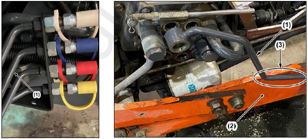

MSC-2022-007: B-Series; Hydraulic Pipe Interference with Backhoe Frame
Document ID CA434
Status Published
Published Date 06/16/2022
Title
Description
This Campaign describes preventative repairs/modifications which must be performed whether a failure has occurred or not. Complete all eligible units as soon as possible, always prior to retail, and whenever they are in the shop for maintenance or repair. Please contact your customers to arrange for timely repair of retailed units.
Product Line
B-Series
Models
B2650, B3350, LX2610, and LX3310 (Cab Models Only)
Serial Numbers
No code has to be inserted here.
Issue
When the backhoe mount kit BH4973 is installed on the affected units, PIPE (1) interferes with the backhoe frame (2) as seen below (3).
Solution
When installing a backhoe mount kit BH4973 on these affected units replace original pipe with the below-improved pipe and O-rings per the procedure on page 3 of the attached MSC. (A photo of the backhoe serial plate must be attached to the warranty claim)
Note: If the affected unit does not have a BH4973 installed, submit for “No-Backhoe - Inspect Only”, stating that the BH4973 kit is not installed.

Thank you Whitetiger, I now know it is a legitimate recall. Now I have to find out how they will be able to install the correct pipe as I have no way to get the tractor to the dealer. I’m over a hundred miles away, and the tractor was delivered to me as part of the purchase agreement. I guess I will find out on Monday.

Sheep farmer, that’s some good news. Hopefully me and the dealer can come to the same agreement. I looked up the part number on Messicks, and it’s $130.00, so the worse case scenario is that I have to buy and install myself. It wouldn’t be my preference, but not the end of the world if it comes to that.
