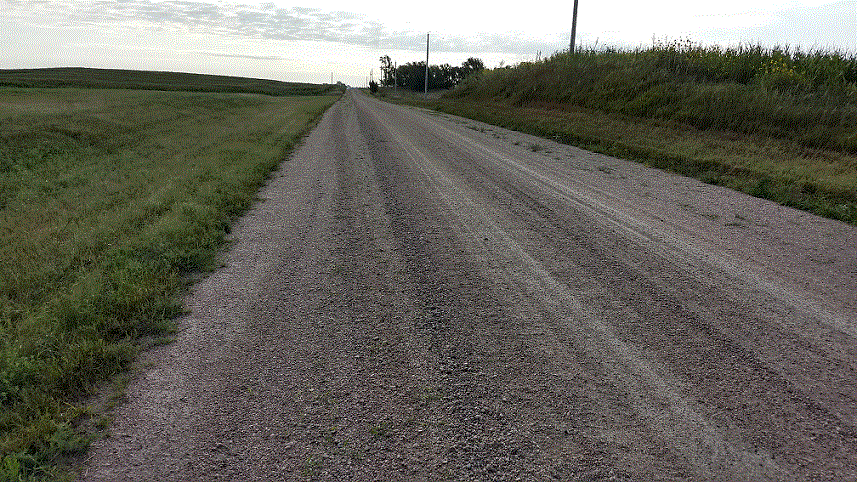

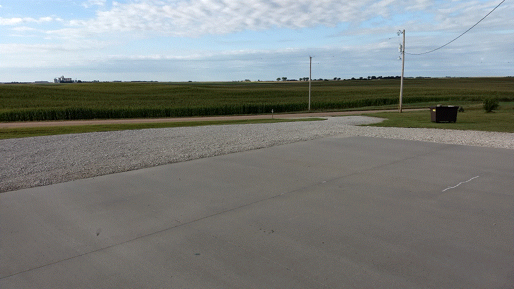

So here's some pictures of my actual driveway. One from my garage looking down and one from the road. The 3rd picture is the section of road just eat of my house that has filled in with snow. The smaller rise is my property. That other side is not my property and is very high 6-10ft. In the past though, the times I couldn't wait for the county, I was able to drive in my property around this area. Snow blew almost clean on top of the level area.
I guess that's the other thing. The guy that did my dirt work tried to make everything so it would blow clean with us being up on a hill. So alot of times my driveway will have 3-4 drifts and the rest will be blown clean down to the rocks. Another reason I was thinking 3 point would be ok. I wouldn't be driving in reverse the entire time. Just line it up with a drift and back into it. The being said all the snow we got last year felt straight down and then the next day (after it was cleaned up) the wind would come up. So I guess I can't even say what normal is...
