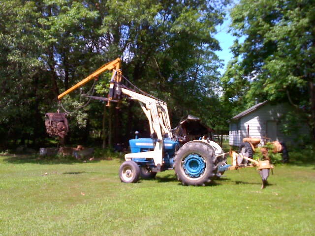

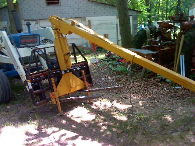

I have a B2650 with loaded tires and ballast box. Jib crane may be OK to quickly move implements around, don't think tractor is heavy enough to set stuff on a trailer.
I did something similar with a Ford 4000 and loaded tires to lift 32' "room in a rafter" style rafters on 7 1/2' walls (around 250-300# each). The mechanical advantage of the lever requires more counter weight than one realizes. I'll post my pics while we wait for Mr. Yates.
Pre-test with engine block for test weight
Added extruded aluminum to boom for even more lift height (forgot to take photos)

Room in a truss rafters gave me a 16' wide 6 1/2' high 2nd story. Large hole in center mean lifting from the top. Finished result.
