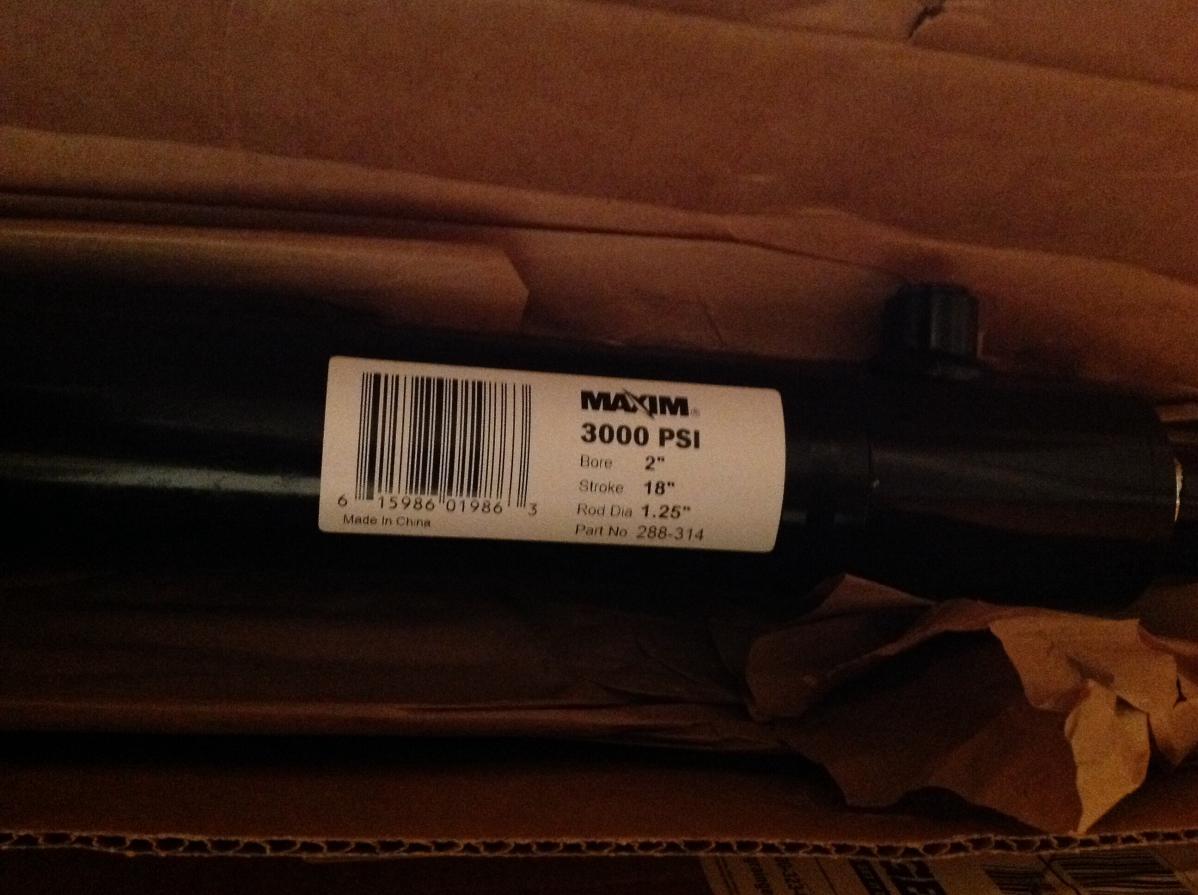

Update.....The 2 new cylinders came into. I unpacked one and took it out to the tractor to just look and compare. It seems that it is just about a prefect match. At least by eye. Hoping to install them this weekend. I'll du another update after they are on and tested. Anyways here is a pic of the spec sticker on them. And here is where I ordered them: Grainger
