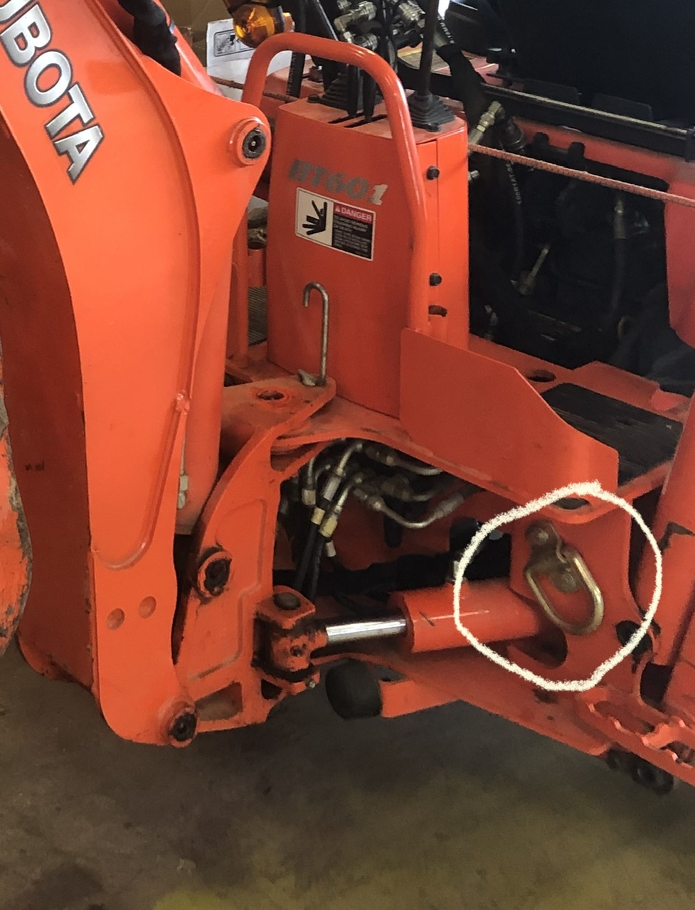

For those with a backhoe, what's your preferred tie-down point on the rear?
There are 2 "built in" tie down points; However, they have too small of an opening for the "hook" part of the chain I bought, so I have a big ole' clevis to connect to it. 1000003571.jpeg
4,080
5,508
Is that a B77 backhoe? Did it come from the factory like that?
Yes and yes.
Maybe its a model year change thing? I dunno.
I added the black shackle.

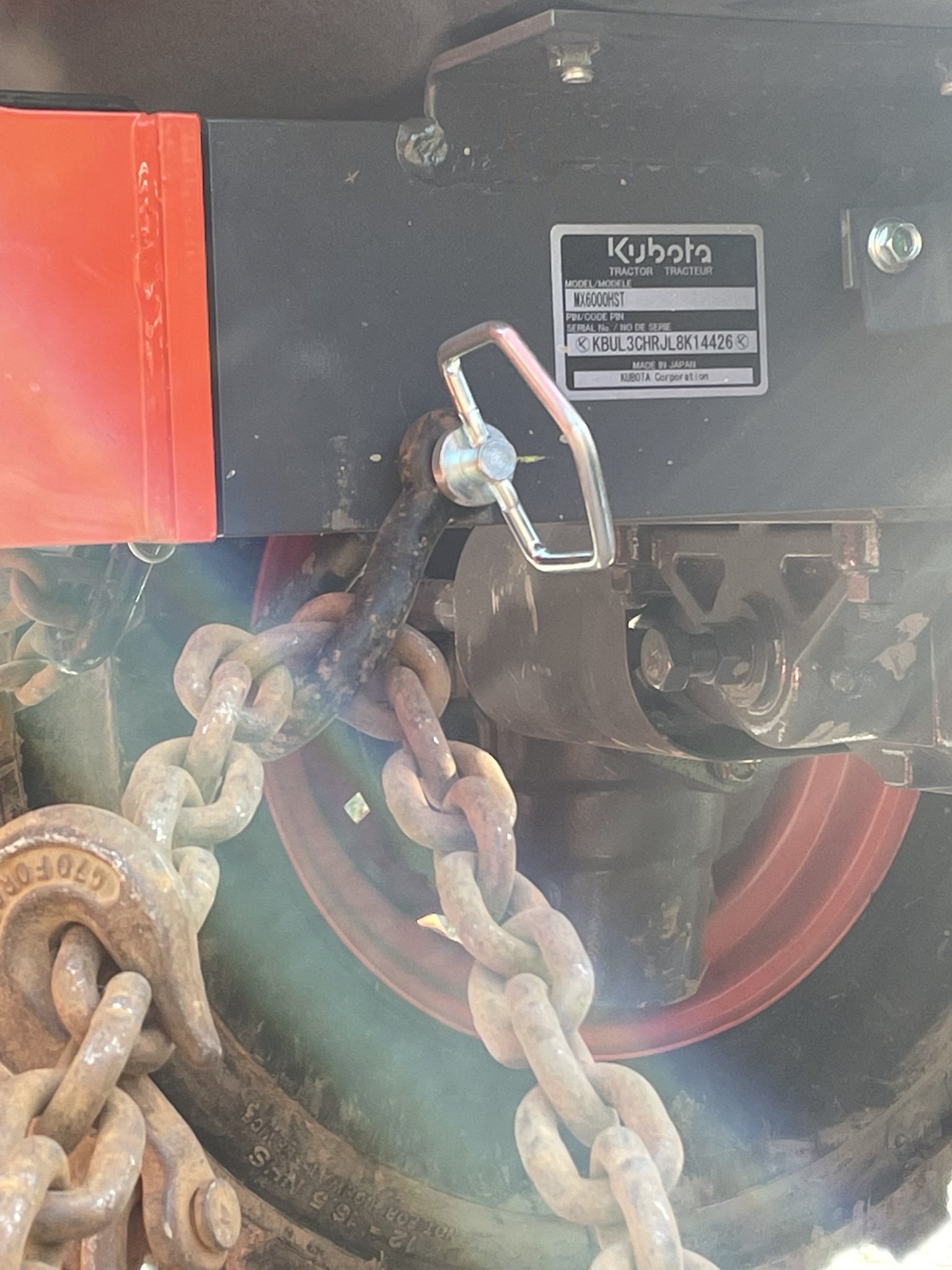

I have not found a good location on either of mine for straps on the axle. If you have access to the holes in the frame, a clevis pin/shackle might be an option. Some backhoes (bh92 for sure does) has tie down location integrated into its frame.

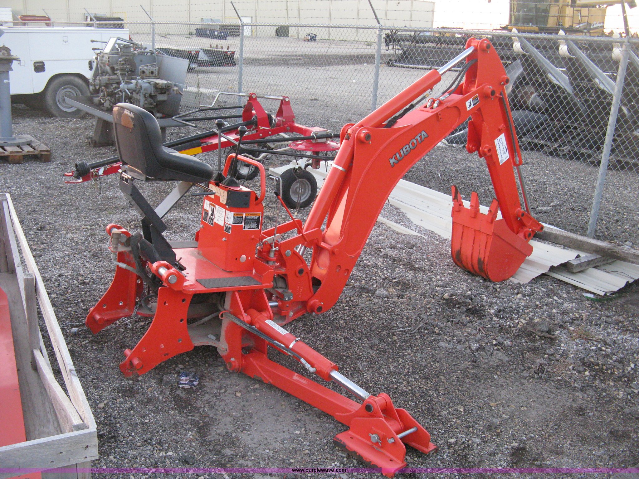

Critique My Binder Setup - pictures of my BH92 subframe - I see no tie-down locations?
Random BH92 picture from the internet - I see no clear tie-down locations?

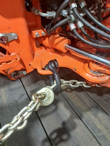

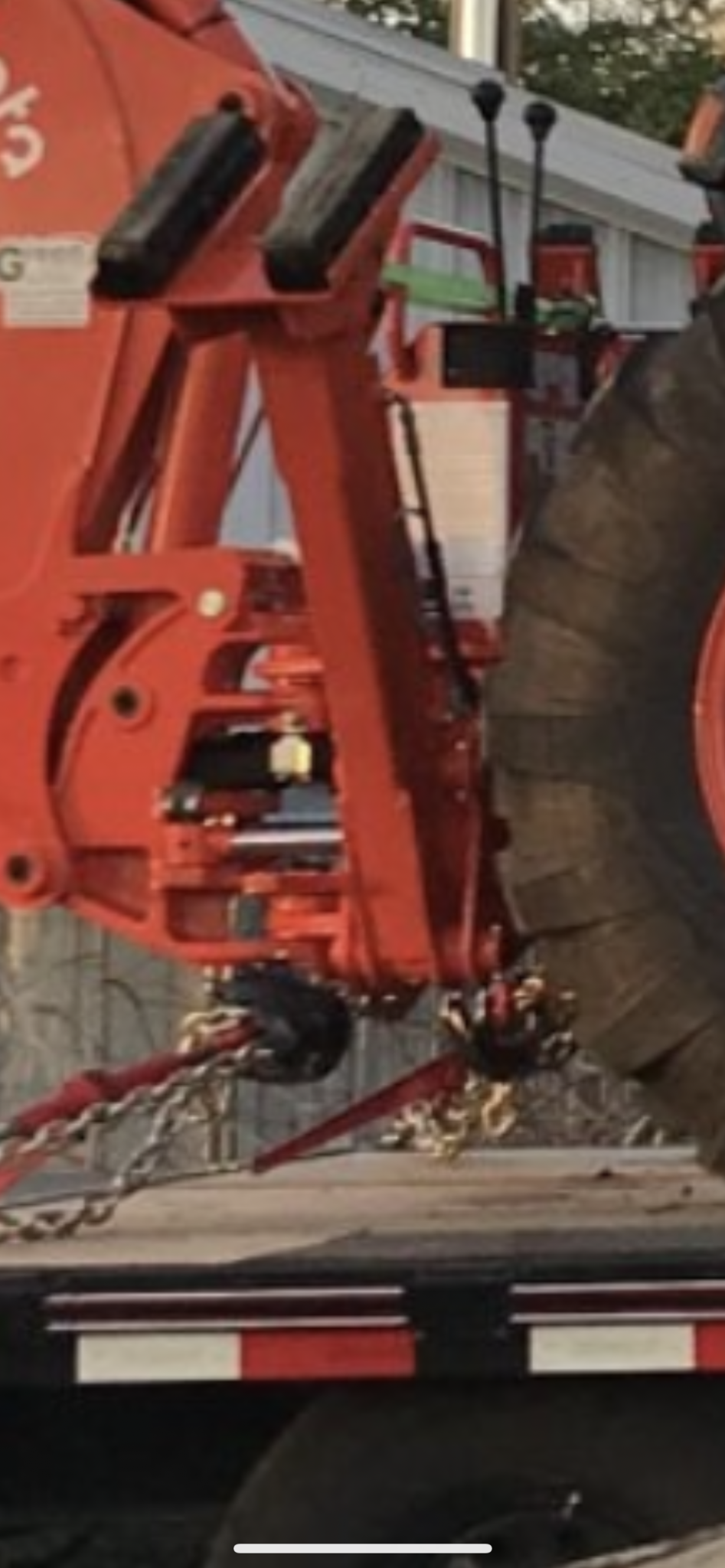

In the previous post, The pic I attached was up front on the frame.
Here is another which shows chaining the BH down. It’s not the correct angle to see and the chains are in the way but maybe you can imagine where there are holes/tie down location on your implement.

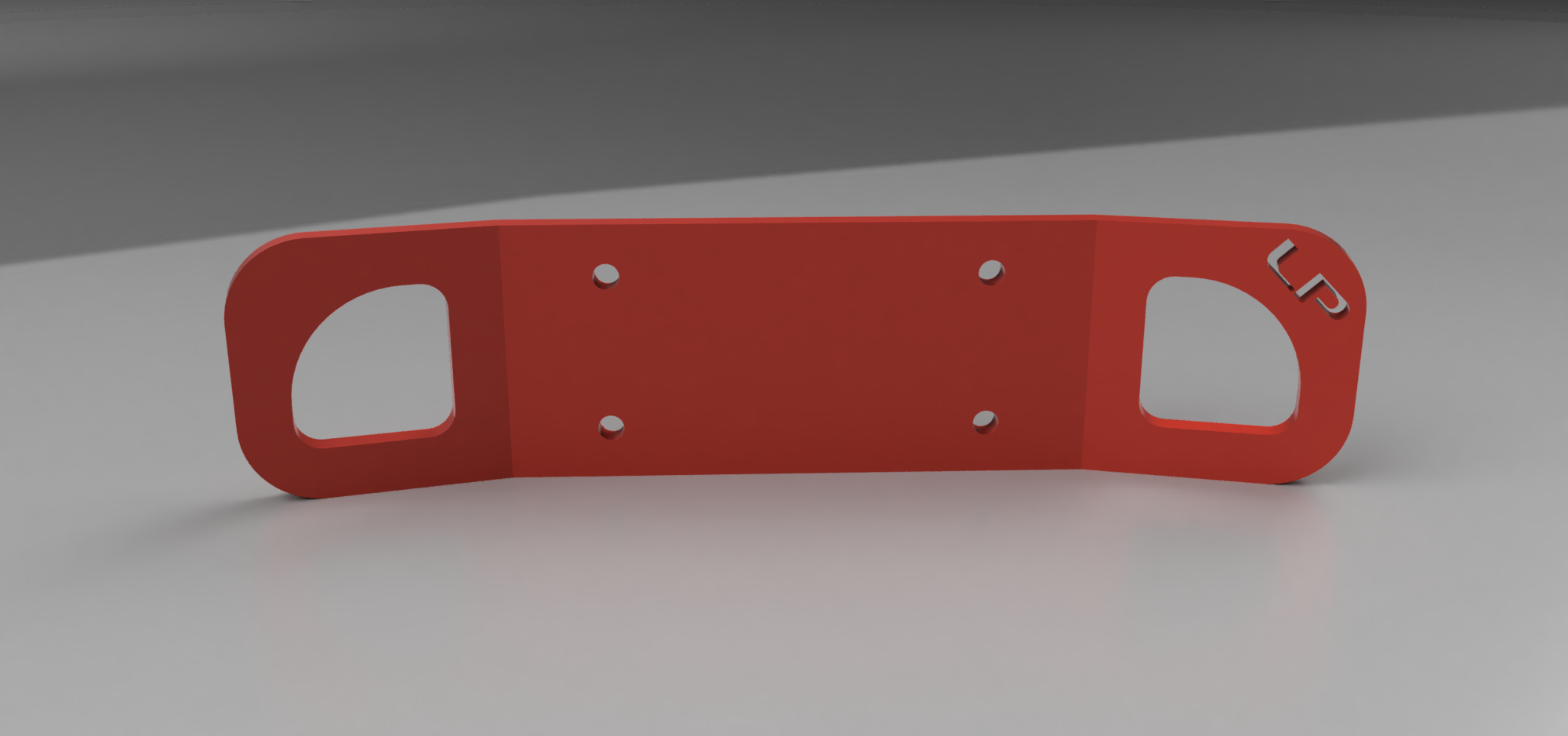

Hey guys, we are a bit late to the game with our tie-downs, but we published them on our website yesterday! Open to any suggestions you guys may have!
One cohesive part fabricated from 3/8" Steel Plate (A36)
Positioned laterally to ensure you don't lose any ground clearance
Bolts to the existing holes on the L, Grand L, and M (that we are aware of at the moment) series tractors, with extended hardware which we include in the package.
If you guys want to check them out and let us know your thoughts we'd love your feedback.
https://lownperformance.com/products/kubota-tie-down-loops Front.PNG
