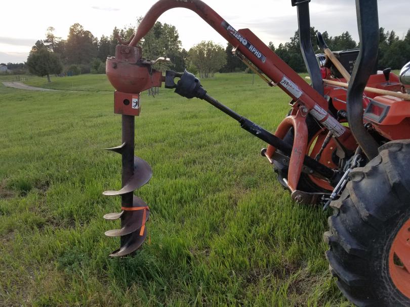

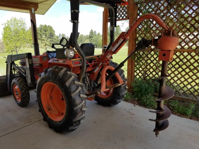

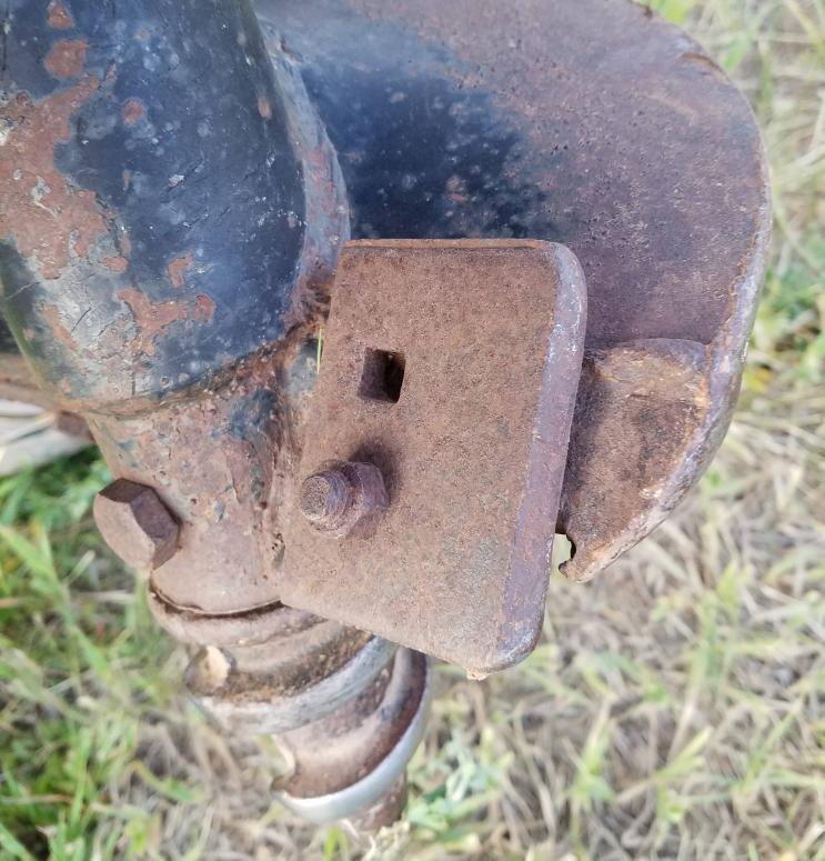

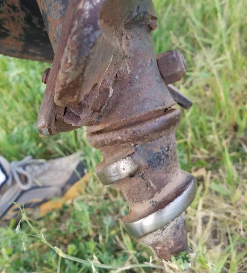

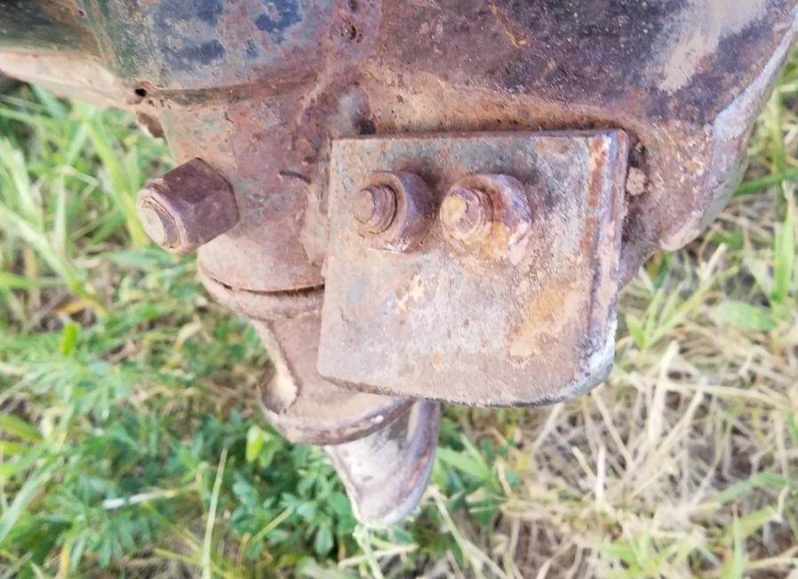

Yes, I bought it used and really have no idea what the cutting edges should look like; I'll do a little research. Here are some photos of what I have. Now that I look at it; seems pretty dull.

The first picture as NIW mentioned, is turned 90% CCW. Looking at it, the exterior hole is worn off by someone that has let it wear down to far. And that pilot bit is pretty worn also.
You could weld it up? You should measure the top diameter of the flighting and then the bottom to see how much taper there is. If you are in frost part of the country and using concrete you don't want taper to your holes.

One digging tooth is on wrong, but both digging teeth are very worn, get new teeth and maybe even a new tip.
Here are a few teeth and tip options
Looks like the auger will need to have the mounting boss repaired so it can have the tooth mounted correctly.

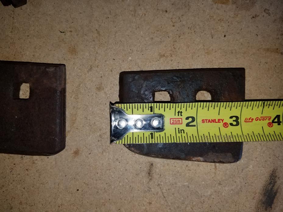

The cutting edges I find on line have 2 5/8" on center bolt holes The ones I took off are 1". Guess I could weld everything up and drill new holes. Any suggestions?
6,413
2,048
