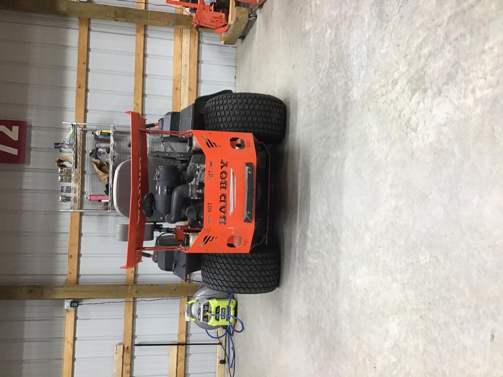

This is why I ask, pic may not show that much difference in the tires but there is. Both are stamp as same size..one on left came with the mower the other is a Carlisle.
I don't know why it shows sideways?

It appears the right tire has more air pressure in it. It's sitting in a much "rounder" profile whereas the left tire is flat across. If you run a tire with lower air pressure for a while, it will take on the flatter profile and stay flatter across even with the same pressure.
Are they the same ply?
Exact sizes do vary between manufacturers and even different lines of the same manufacturer.

The OP can check the tire specs posted by each tire manufacture to verify they are the same. 5 minutes searching will uncover the manufactures tire catalog with all the tire specs.
If the tire doesn't match published specs, take it up with the supplier/manufacture.
After verifying tire pressure are equalized, actual measurements would be more precise than a picture.
