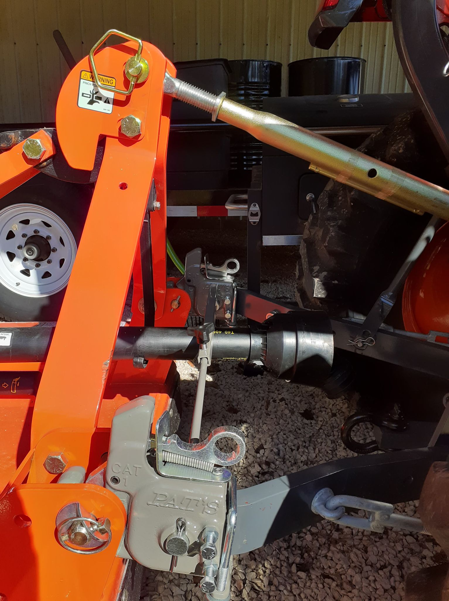

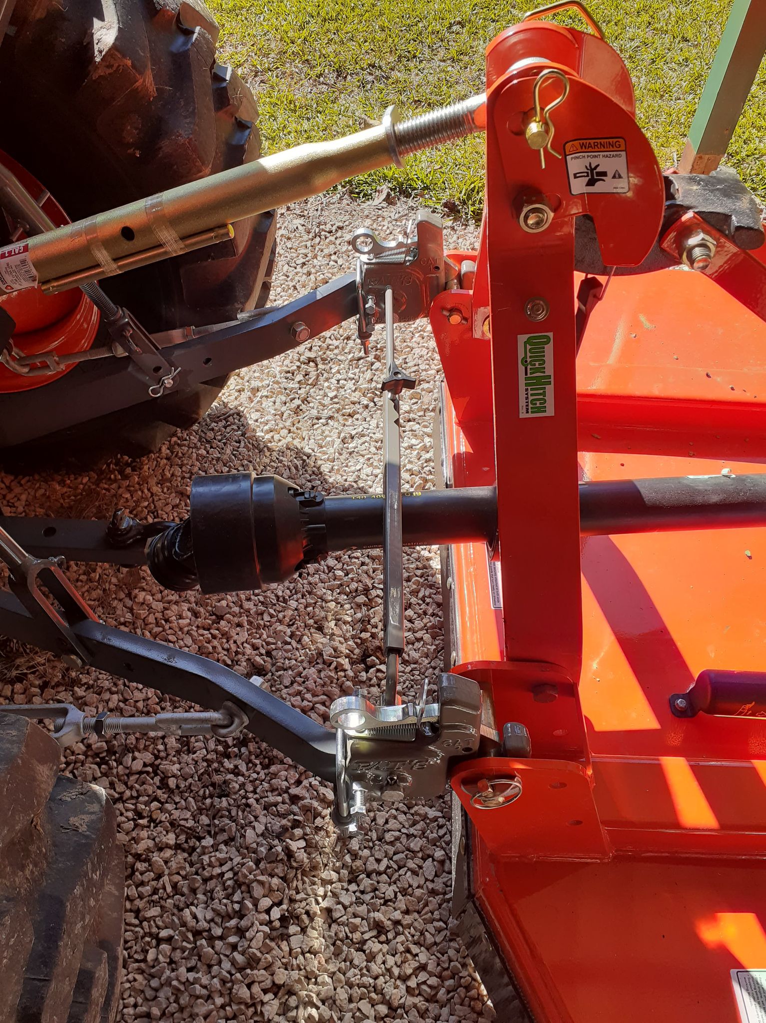

I got the Pat's easy change setup for my L2501 and I like it, not as bulky as a regular quick hitch and worth the money, I have it set so that I can go from the bush hog to the landscape rake without having to reset everything, the only thing that I did was get a longer top link from tractor supply.

If I was in the market again I'd buy Pat's Quick hitch. My first choice would be to switch to the euro style ball, cut off the 3PH ball ends and weld hooks on my 3PH ends. Too much effort for little return, I don't swap 3PH implements enough to make it worth while.

I have a Speeco that does not have an adjustable top attachment. I modified some of my implements but some were not modification friendly so the QH had to be removed to attach them. It's heavy and awkward.
I finally grew weary (read older), and resorted to Pat's Easy Change on both tractors. Yes, I still have to deal with the top link, but even with that, it's a better setup for me.
