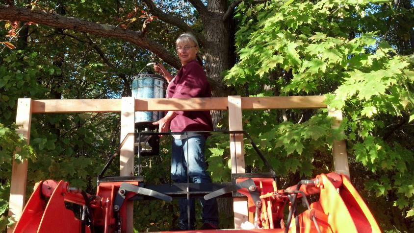

I have done what you are looking at but will tell you that there are many safety features I implemented with it.
1. A lift platform with railings on 3 sides is chained to the forks and back plate to prevent platform movement.
2. The tractor is NEVER moved with platform in the air.
3. The person on the platform is tethered to prevent falling.
By using a battery operated pole saw we can reach about 25 feet in the air.

I made a man lift and use it as you desire. It has railing on all four sides, with one being hinged and pinned to allow easy access. Of course multiple straps/chains are used to hold it to the fork carrier.
It comes in real handy.

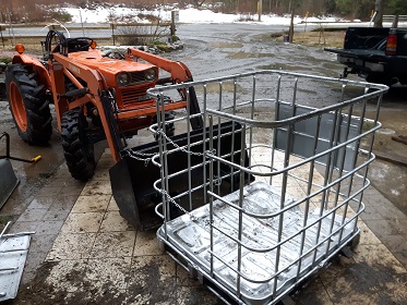

The metal pallet/cage from chemical totes does a dandy job as a man cage.

Yes Chemical tote - IBC tote from my post above. I got the idea from Mike Morgan of Outdoors with the Morgans Youtube tractor show, who uses them to store firewood. They are about $75 around here but I have seen them as cheap as $35 with contaminated tanks. Good only for septic draining or something. But since your throwing away the tank that's not a problem.

$25 for totes here locally, been used for liquid fertilizer and cleaned. Here's my man cage.
