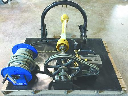

Something like this but with a drum or tank to draw from. Maybe just fill the bucket up with water and make a lid for it?

Dirt Perfect (you tuber) has one he made. Repurposed a pump from a car wash he demoed, an aluminum truck fuel tank for water, misc. pillow block bearings, pulley arrangement for speed increasing, all stuff he had laying around. Going to be a pretty expensive project if you have to buy all new components, but his works very well.
