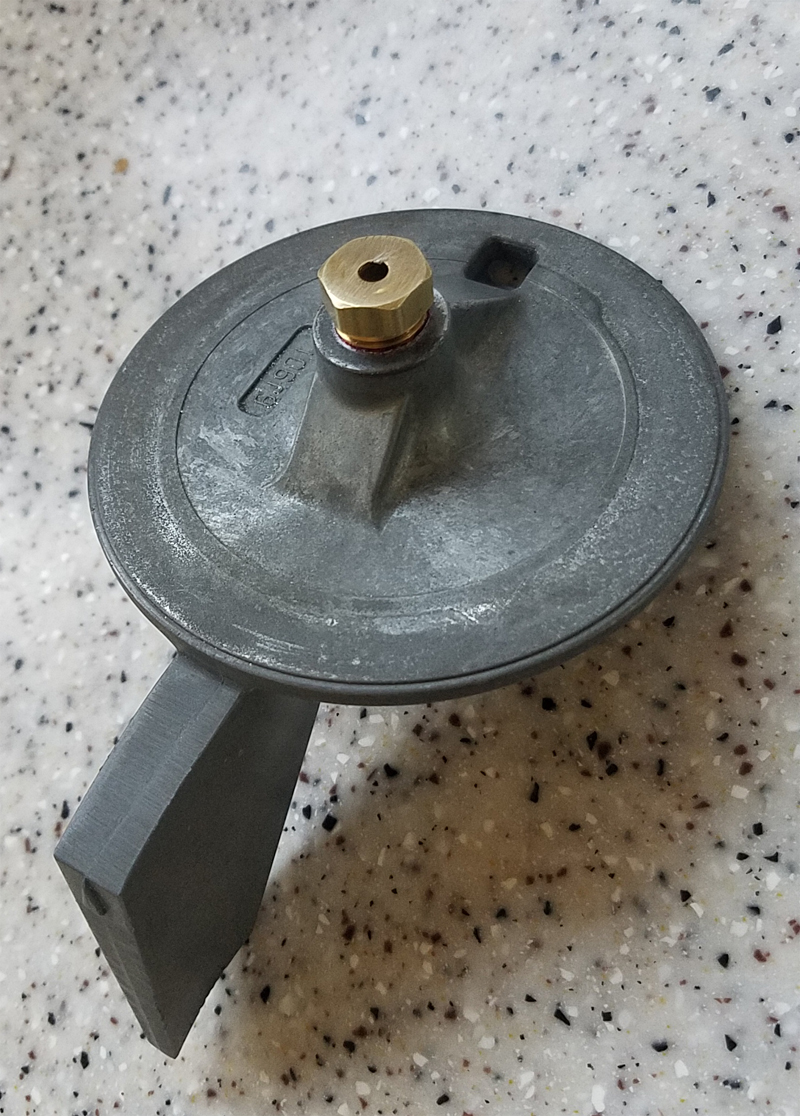

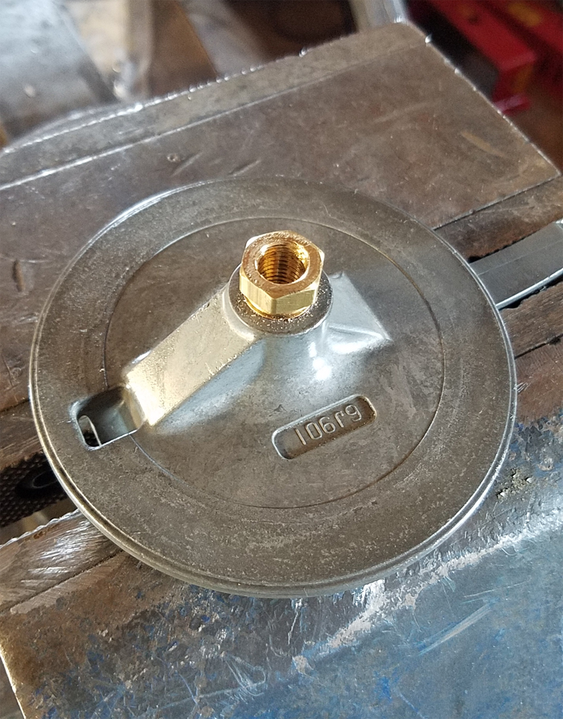

I think I mentioned a while back that the trim tab anode was hard to remove when I was replacing the water pump impeller and related parts. The thread in the anode was messed up either due to galling or cross threading. Since the anode is some kind of zinc alloy the material is on the soft side.
This boat has never seen salt water and the anode is in such good shape, threads aside, that it seemed wasteful to buy a new one, so I decided to repair the threads using a brass 1/4" NPT to hose barb bushing. I drilled out the damaged threads, cut new threads for the 1/4" NPT adapter, cut the hose barb off the brass fitting, drilled out the center of the brass fitting and cut new threads for the 10mm bolt that secures the anode to the lower unit. I was thinking I might need to cut the brass flush with the top of the anode but it turns out that there's ample room to leave the bushing proud, and the upside is that the bolt engages a lot more threads.
I was able to reinstall the trim tab and rotated it a few degrees clockwise and now the steering feels a lot more balanced.

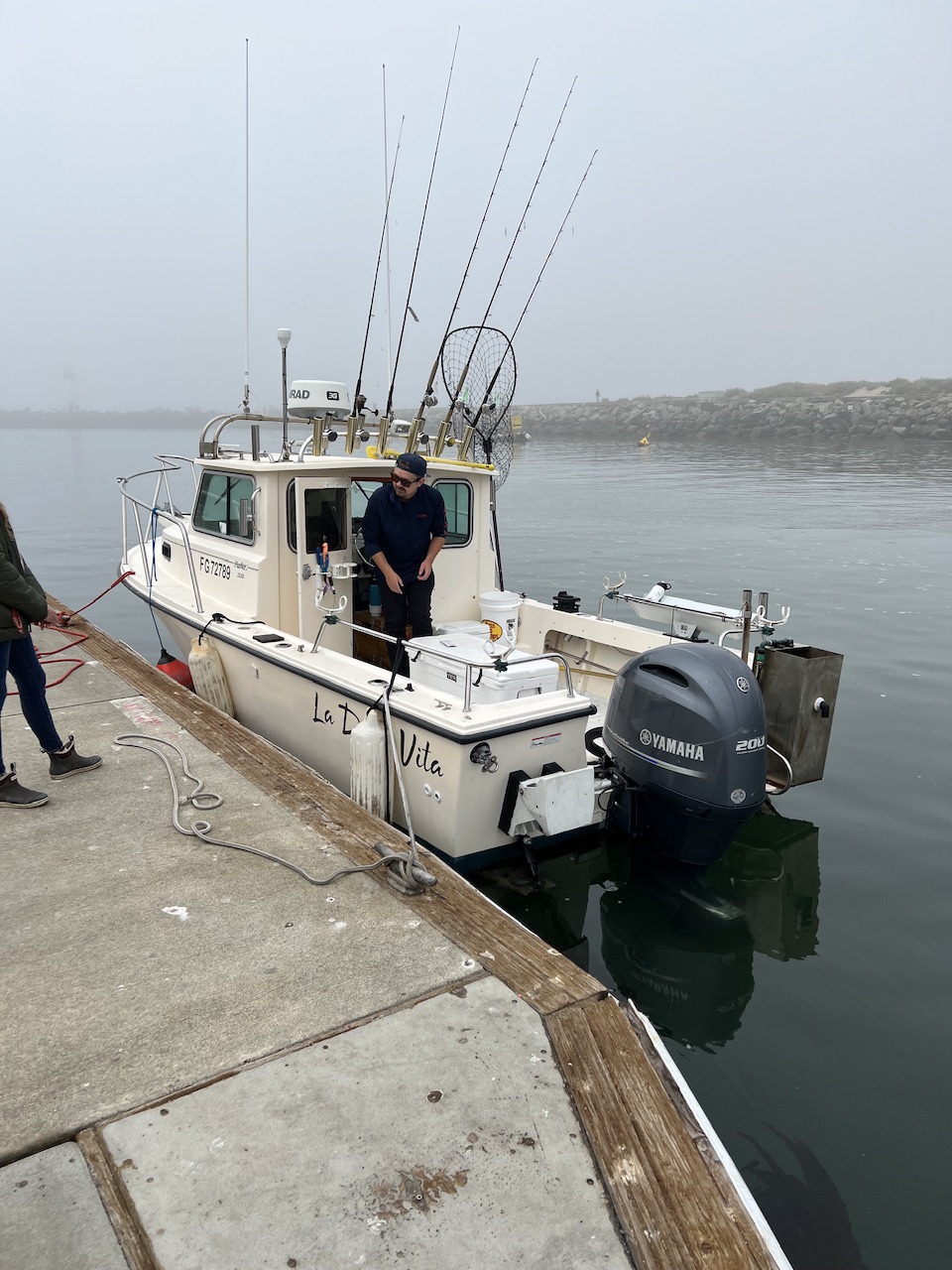

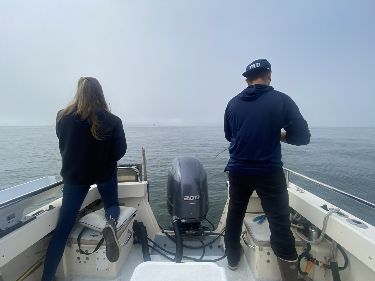

I mentioned my son in law’s boat out on Monterey Bay.
We were there last week. Did some fishing. Very foggy. Only got some Jack Smelt. Only went out a mile for a couple hours.
Nice boat.

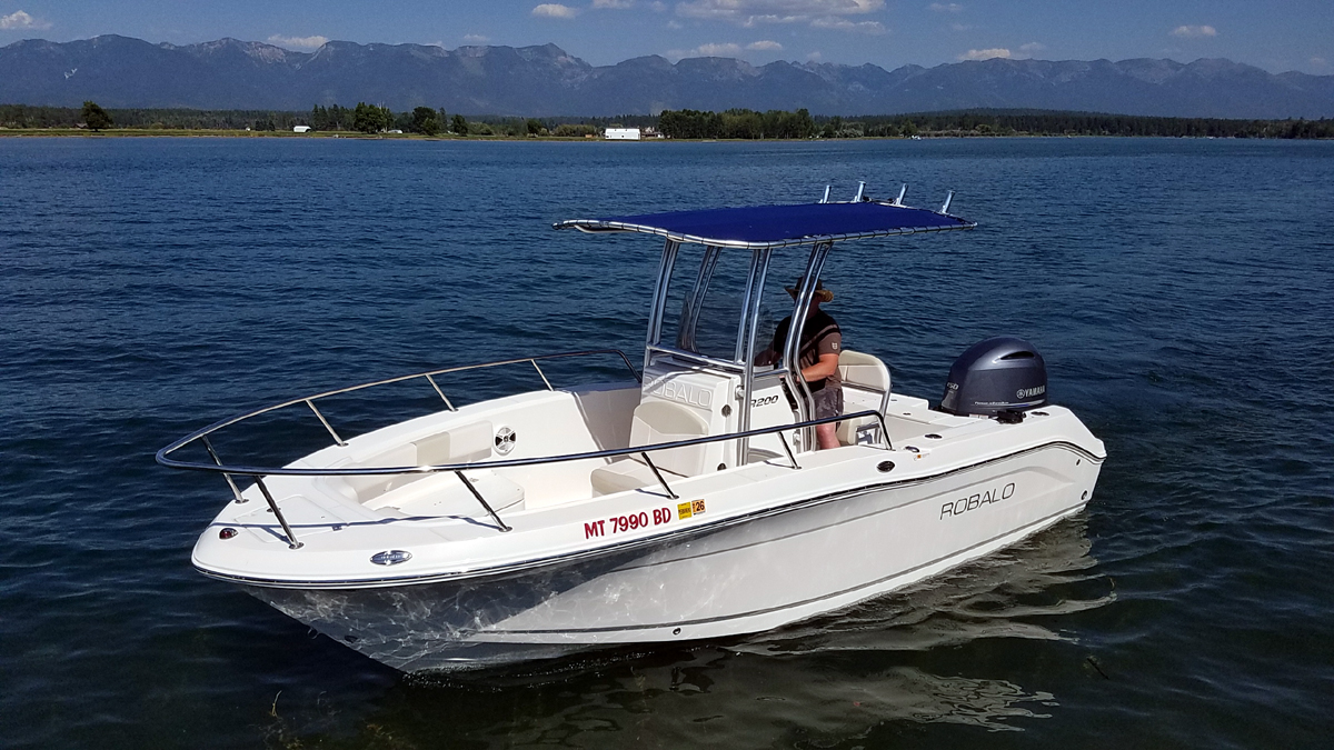

I've put about 10 hours on the engine now and more than 100 miles cruising around Flathead Lake. I would have taken it out more over the past few weeks but I was out of the country for close to three weeks in June/July.
So what are my thoughts about buying this boat? To be honest, I didn't know if this was a bad decision last year but now I feel that the boat was worth every penny. I love being out on the water and I really like this boat. Yesterday a friend and I were out on the lake for more than 4 hours and cruised over to another friend's dock on the lake. We swam for a bit in 100+ ft of water with no one around. The lake is big enough that it doesn't feel crowded or even busy, and that's during the peak months.
I still have a lot to learn and feel that this boat is a keeper. It cruises effortlessly and quietly at 28 to 30 mph (4,200 rpm) and could go a fair bit faster. It's a good size, it's comfortable on the water, it rides really well, it's easy to get in and out of the water, and it tows really well behind the F250.
Here are some photos from yesterday afternoon/evening. My friend has a boat ramp and dock so I backed the trailer into the water and had him get the boat off and pick me up at the dock. The previous weekend I was out for most of the day with another friend and she had a great time.

Very nice! Is that a Boston Whaler?
It’s a Parker 2125…I think. 21 foot, and his friend has a 25 foot version of the same boat.
He has aspirations for other vessels that he pointed out on our short expedition.
Osprey and Farallon (sp?) were two manufacturers that come to mind.
He’s from the area, and just got a slip in Santa Cruz Harbor last year or so. He likes to fish and has our daughter enjoying it as well.

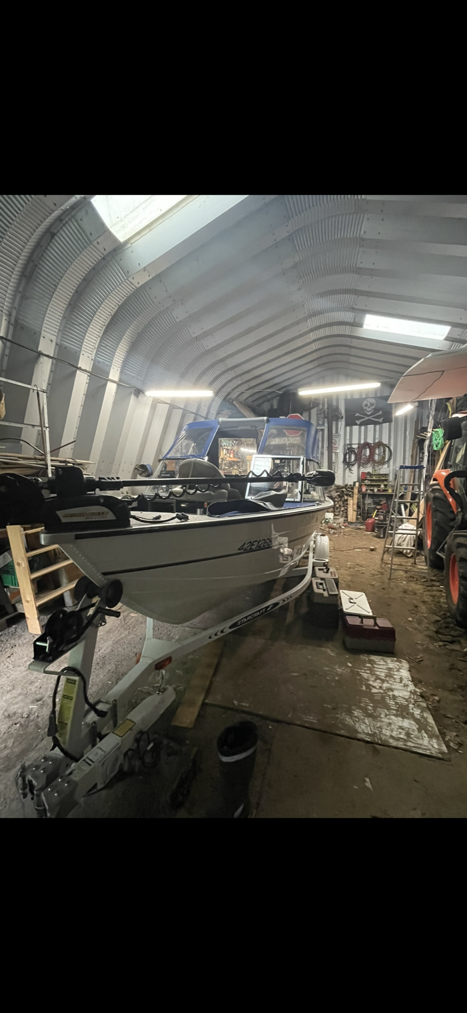

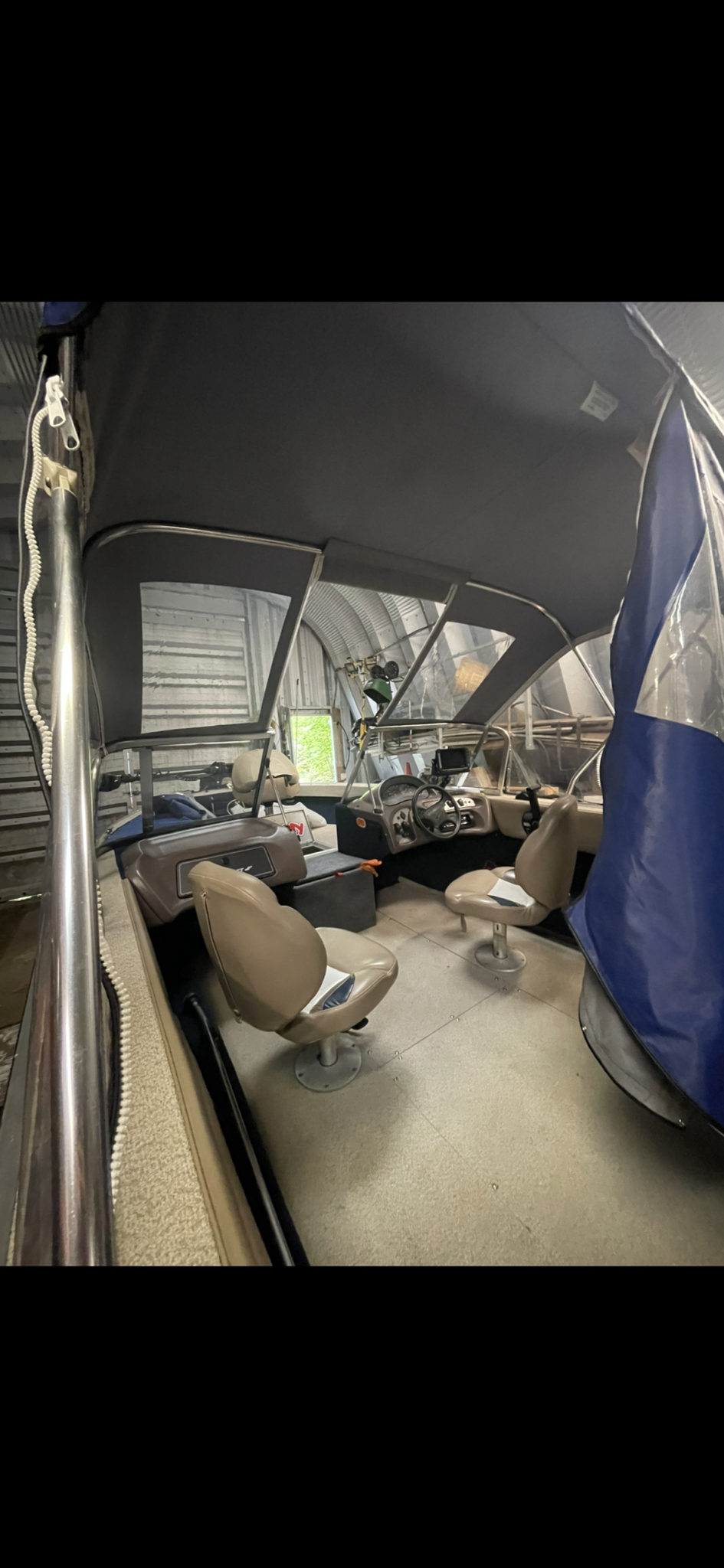

I’m a little late this season for me but never the less I finally got my boat out of storage and ready to fish. My business keeps me pretty busy during prime time fishing seasons unfortunately. I fished 5 days a week for years and now I’m lucky to get out 5 times a year excluding the hard water season. I’m also Just a little guy compared to you center console boys and girls but she definitely gets the job done with the pro xs 115 and 18 feet. As lug bolt said I also can’t fit into some of the places I use to fish with my smaller but I mostly stick to trolling with riggers on the Great Lakes now so this is the perfect setup to just relax and fish. If we really want to hit the small lakes or rivers we just pull the kicker from the StarCraft and use a little 12 foot aluminum we have.
Nice boat! When I first started looking for a boat I considered one quite similar to yours.
