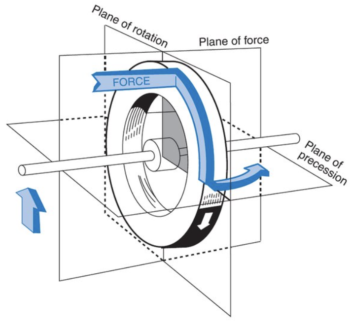

mcm, regarding steering, its called 'gyroscopic precession' its normal on single engine outboards, you'll need to move to two engines to make that go away ; )

mcm, regarding steering, its called 'p-factor' its normal on single engine outboards, you'll need to move to two engines to make that go away ; )

I'm not sure where to start but I want to see more photos of your boat for sure! It looks like a beauty. Thanks for your explanation of the p-factor. As a first time boat owner there are many things I know nothing about so am always learning and appreciate all of the knowledge shared on this forum.

Think of a paddle boat. A prop is nothing but a paddle with the blades at an angle.
Same theory applied to early propeller driven aircraft. They turned faster in one direction because of the rotational forces of the blade (and engine mass).

basic physics has not changed, the rules still apply as they did 'early' days ; )
on an airplane its called gyroscopic precession, this is why single screw outboard is easier to turn one way than the other.
This is all fascinating stuff. I have some reading to do. (y)
True. My understanding is that modern aircraft use trim tabs and other aero to combat most of that. I'm not a plane guy though. My uncle is.
