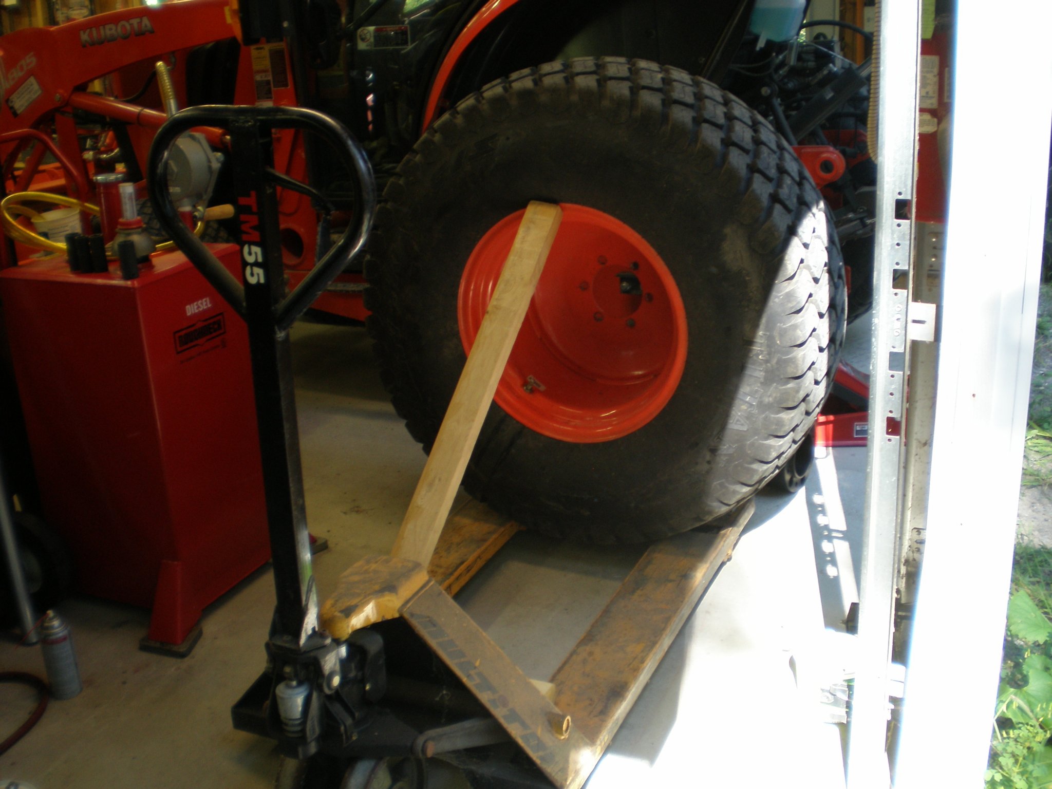

I use
d a pallet jack when I installed my wheel spacers, worked like a charm.

Thanks for the tips and advice. I’m not concerned doing the work. More respectful of the weight and asking for tips to folks who have done this before.
It’s also not something a remote changer is gonna work for because it’s gotta come off to access the panel in the wheel-well for installing rear remotes. So I’m not paying someone to come out 2x. At that point might as well have the dealer do it.
I kinda like that pallet jack trick!
