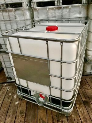

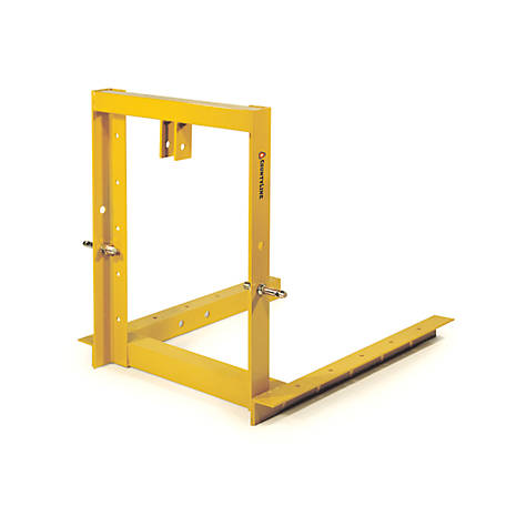

Excellent advice. Just in case our OP isn't familiar with those terms:
Carryall:
Weight box:
Now, an IBC tote isn't what most people think of when they think of a weight box, but it gives you an infinitely adjustable weight box that is easy to fill and empty. If you aren't using it in freezing weather, all it needs is plain water, and you can put enough in it to overload most tractors. Some might not like their weight sloshing around, and that's a valid point, depending on what you're doing. You can always just use the cage and fill it with rocks, too.
But if you insist on a conventional weight box, suit yourself:
As you can see, they come in all kinds of flavors.
A "Carryall" is definitely not the best solution. IMHO.
Agri Supply sells a set of three point forks that will lift 2,000 lbs,..... and forks are much nicer than angle iron.

When I said 'carryall' , I meant a 'generic' style of 3ph lifting device. Both the yellow one and the red one posted are 'carryall' implements to me.
Something that you can use to lift up a 'skid' to move 'something' from point A to B.
they're easy to make, affordable to buy and are a very versatile implement.
you can have 3 skids of weight 'light, heavy, just right', choose the right one for the loader operations.
The one I made uses forklift forks, has a 2" rcvr on it, so more than a 'carryall' I suppose....
it's hauled skids of pavers, stones, 3500# logs and pulled every trailer I own.

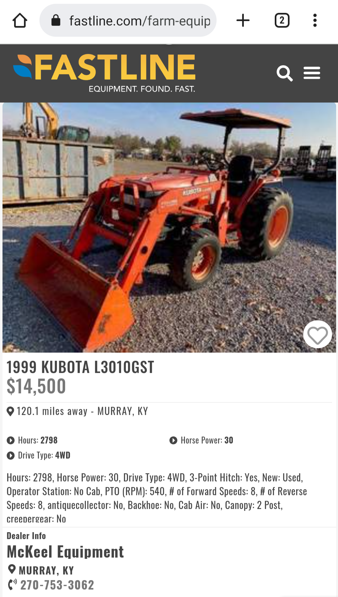

The L3010GSt shown above should work, but would be at about the minimum. Also I noticed the John Deere dealer in Wamego has a used Kubota on the lot, but I didn’t check it out. You might take a look at it. I personally would stay away from the tricycle type of tractors unless you really know their limitations. I grew up with narrow front end JDs and just like a tricycle they will tip over easily, especially if not on flat ground. There is a reason the 3 wheelers went away and the 4 wheeler utvs took over. To many accidents. Good luck finding one that will fit your needs!
N
Nearly impossible to fit that "carryall" shown into a normal pallet.
3pt forks are a much better idea,.
The forks can slide into, or under a pallet, and at $299 they are not very expensive.
Be sure to check out that tractor at the Deere dealer. Often times an off brand tractor gets sold at a very reasonable price!!

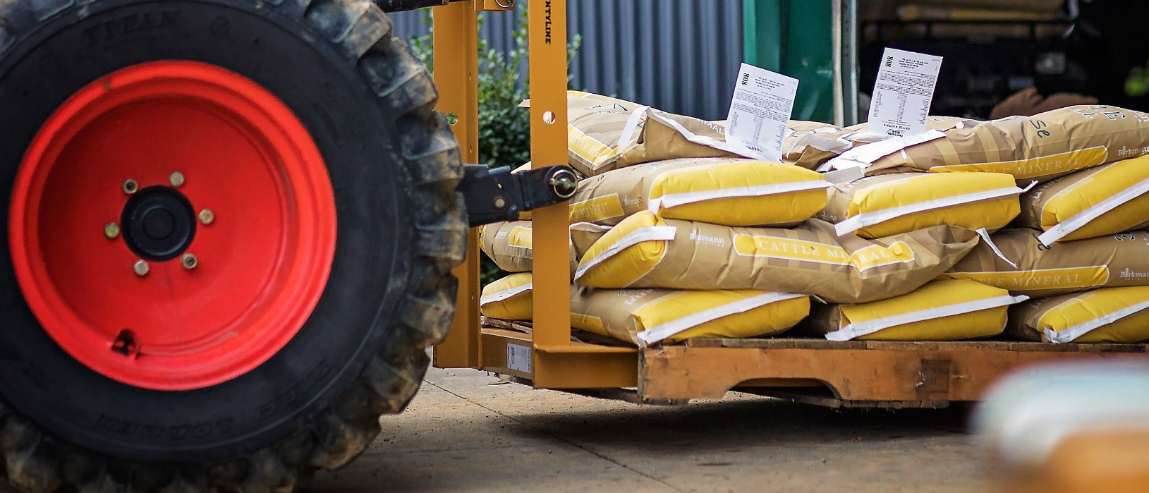

curious, and finally found where the yellow 'carryall' came from, so here's another picture of it sliding into a skid.
'normal' skid ..hmmmmm, around here a 'normal' skid is 40x48 , all made from 2by6, consisting of 3 runners and decking. 40" wide ,as 3 fit real easy on the 11' wide racking, 4' deep cause the 2by6's came that way(free 'offcuts', 1,000s of them). We've built hundreds of them.
One trick with storing stuff on skids , is to double up. The 'lower' skid keeps the good one off the wet ground and easier/cleaner to grab or drop the good skid.
If forked carryall is same or close to price of the angle iron one, yes the forks could be a better deal, again depends on the ultimate use.
BTW, if you stack the load closer to the tractor,you'll be able to lift more.
