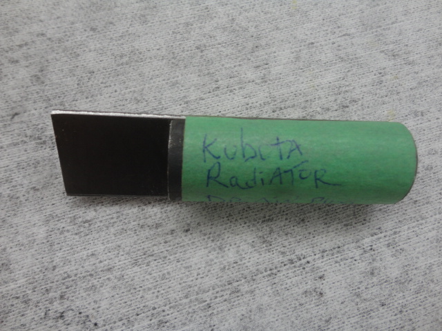

I drain my radiator each winter about this time to install my cab....or actually to hook up the heater in the cab when installed. The drain plug on the bottom of the radiator hasn't been a problem. I made this little tool to fit the groove in that plug better. Used with a slip joint pliars and it loosens/tightens without any issues.
It's just a short piece of thin flat iron inletted into a short piece of pipe. Nothing fancy. The label is so I remember what it's for and don't throw it away in the summertime. 😄
