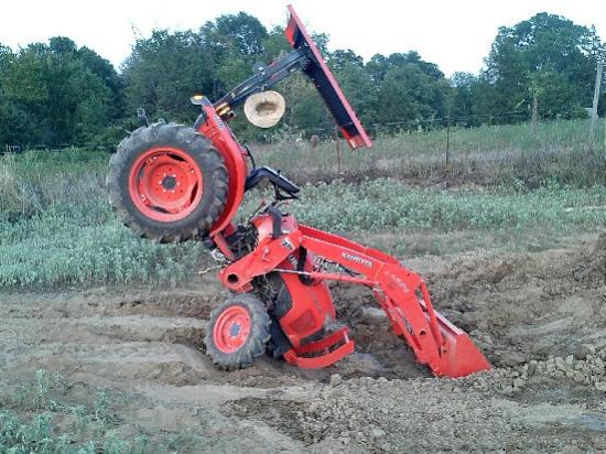

Flipping a tractor forward on it's nose is really really hard to do.
Can it be done, YEP! Here is proof of that (Found it on the Internet)! :D
#1 Cause, bad operating, #2 Cause again bad operating, #3 Cause no rear ballast!

North Idaho Wolfman, that looks like someone failed to anticipate......
I think the OP might have not estimated what a 330' roll of field fence weighs. Multiply that times 2, then stick it out on the forks.
It's like putting a fat boy on the other end of a teter totter and then wondering why your feet never touch the ground!
Disclaimer: If this is your tractor, there should be an organization like the ASPCA, we will call it the WWSPCK (World Wide Society for the Prevention to Cruelty of Kubota's) to come over and teach you a lesson or two. :rolleyes::eek::cool:
Hell, just looking at that make my butt pucker.......
can you imagine climbing OFF that machine? YOU would be shytting bullets......

... there should be an organization, we will call it the WWSPCK (World Wide Society for the Prevention to Cruelty of Kubota's) to come over and teach you a lesson or two...
Yep! My thoughts as I looked at the first pic. The second pic convinced me to make a donation to that worthy organization! :D

I have tipped skid steers on their front end . A Kubota with the @$$ end up in the air like the one above with the FEL dug in like that is operated by someone that should not be in control!
