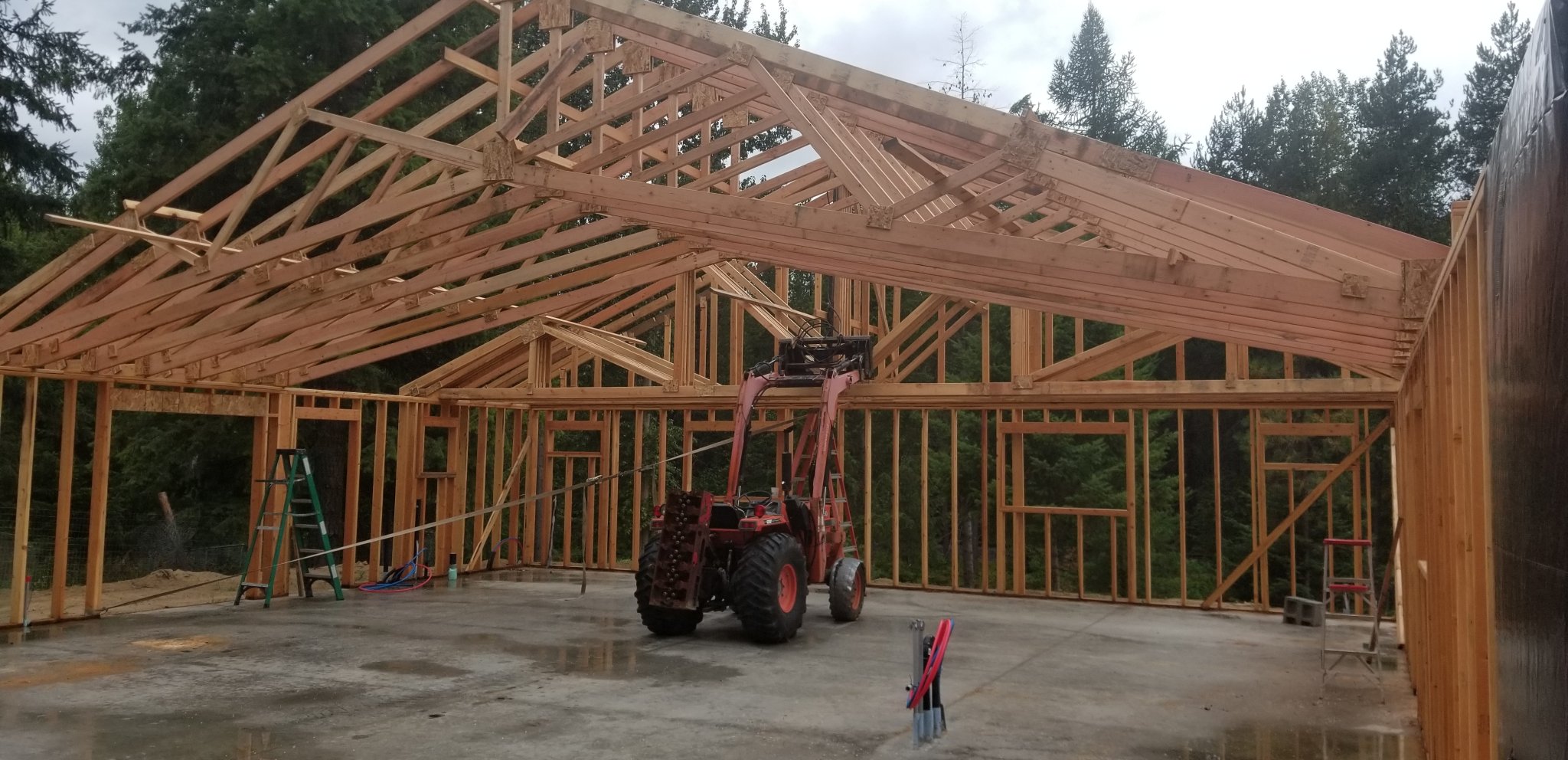

Hi just a little feedback. the trusses seem fine and we have had a considerable amount of wind alto the snow has been light less than a foot at one time. I made a mistake using the suntuf panels and when building the tractor shed with the medal roof was able to use clear roofing panels supplied by my metal roof supplier. Those panels were much easier to install and less than 1/2 the price and they look as good or better. There is a leak in the suntuf roof that I have so far been unable to locate but the panels have multiple gaps so this spring I will silicone the gaps. the metal roofing supplied panels have no gaps. live and learn.

Don't use silicone, use Lexel!
It doesn't harden, so it flexes with temp and condition changes.
It's not cheap but it 100% works!

one .big mistake I made was using the suntuf for the roof . my medal roof guy has a better clear product that would have been much easier to install for 1/2 the price. The suntuf went up wanky and was difficult to install the clear poly from the metal roof guy is much easier to install and looks better it will be my choice when I put up the greenhouse. As far as the trusses go they held up all winter with some pretty powerful winds and seem to be doing great. thank you for all the help and advice

Good luck with the shed. Don’t forget to use hurricane ties or similar. They are relatively inexpensive, but will help when the wind blows. Also, pay attention to how you put the screws into the roofing including the number to use

I purchased a 12x16 ft shed a few years ago, and it had trusses like the ones in the first pic. I immediately notice that the center of the roof was already starting to bow down. Checking the trusses, I could tell they were installed very cheaply. I decided to beef up the trusses myself, with 6 2x4's, on the longest part of the trusses, and added support half way on each of them. I live near the White Mountains in Maine and we have snows that are in multiple feet each year. I don't think I had much more than $50 dollars to make everything right. Spend a little bit more and ensure you will have no problems.
