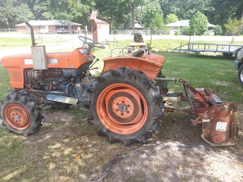

I've been reading up on your site today and wanted to join in to gather intel on a possible project. I have an opportunity to purchase a L2000DT but just couldn't settle on a price yet due to my uncertainties (ignorance) in repairs! I think its a good price but that can go downhill pretty fast if the right thing is wrong!
Info on tractor:
L2000DT
1500 Hours
Tiller included in price
$2500 USD
The good:
Starts and purrs like a kitten, engine sounds great
No noticeable engine oil or gear/transmission oil leaks (even at the PTO seal)
H/L 8-2 all seam fine and operate
All four speeds PTO work
Tiller seems to be great, no obvious noise when operating
The bad:
Brakes not working
Radiator Leaks from upper area (not the cap or overflow)
Tires in bad shape=dry rotted (will need at least three, both front and one rear)
Black pull knob doesn't work. I assume its some sort of compression release??? But not sure...
Missing some type of switch/control knob on dash panel (the one with the silver housing)
Radiator re-core and tires, I can get a good idea on price, but the brakes worry me. Anyone deal with the brake system?
I think I might be able to get it for $2000, but I don't want to sink a lot of money into it and not be able to get out from underneath it without a huge loss. This will be my first tractor.
I plan to go back to the owner and look at the tractor again. Maybe make him an offer. Any advice what to look for, tips on these types of tractors, etc...?

I will take another look at this unit, but wanted to gather more info before I go. Brakes concern me as to what it may cost to fix them, or more importantly in the realm of safety, if they can be repaired at all. I can't seem to find a diagram that details them. Any info on where to locate a diagram on the braking system and what are some tips to look for?
I have attached two pictures, albeit not the best or closest detailing her, but all I got.
Thanks!
Russell

The brakes on that should be similar to automotive style drum brakes. Not hard to replace yourself. Since the L225 is the cross over model you can go to Kubotas website and pull up and illustrated parts list and get an idea how it all goes together.

The hardest part of the brakes is getting the wheel off. They are enclosed in a houseing (wet disc) but easy to get off, other than rusted bolts.

Thanks y'all! I'm gonna make him an offer. After reading up on some of the tips, y'all's advice, watching videos, and other information here, I think I can tear apart and rebuild the brakes after looking at the kubota's L225DT exploded view of the system. I'll let y'all know how it goes! :D Thanks again, Russell
