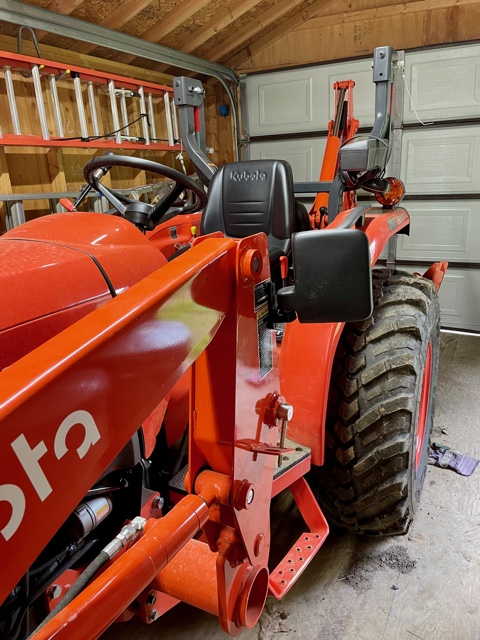

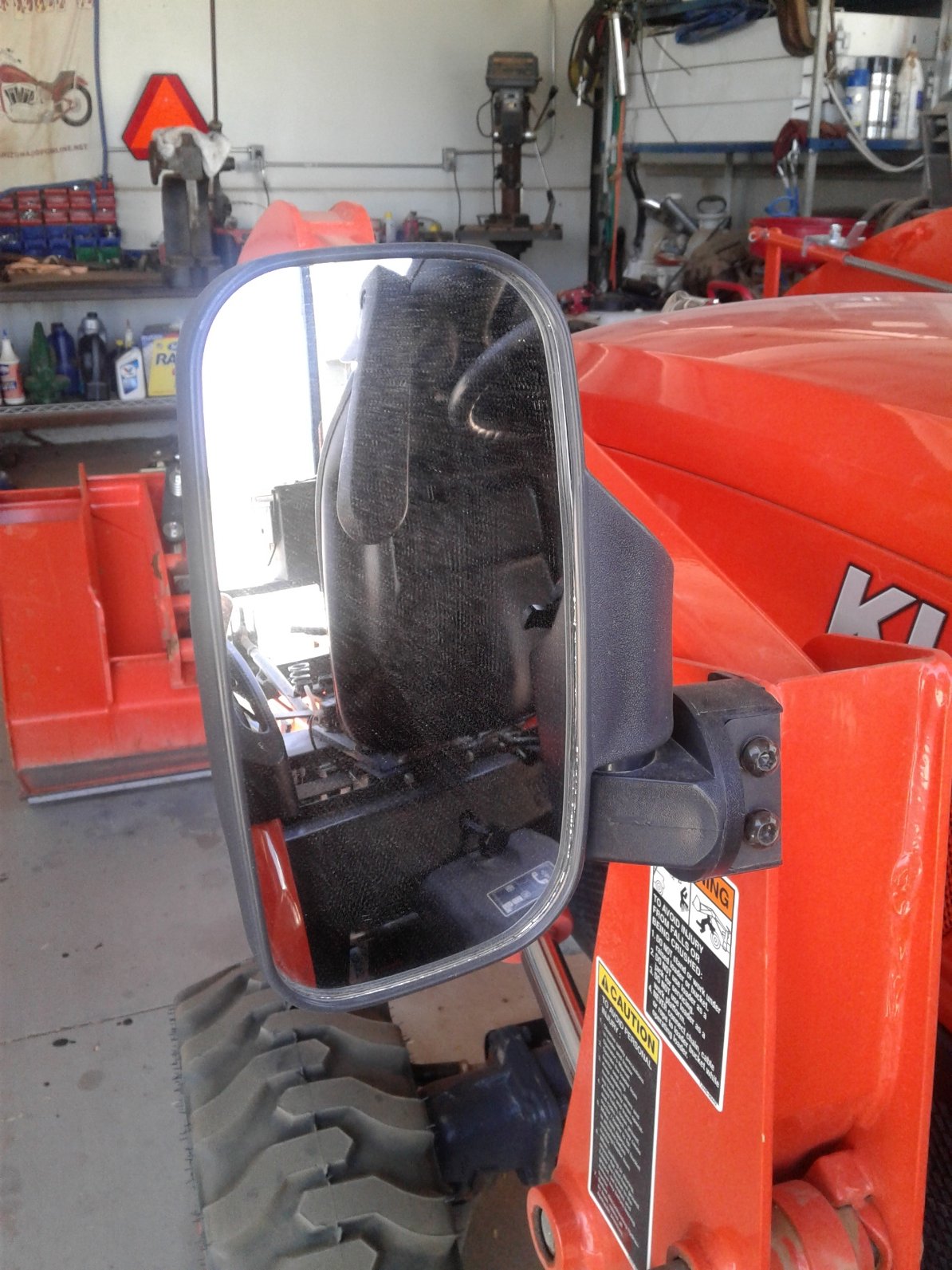

Agreed on the pics being worth 1000 words - took some now. ;)
So, I have the LA525 which does not have ANY factory holes that are close to being useful.
I used a cut-down bike innertube to 1) prevent movement or walk & 2) allow me to really crank down on the clips. Because of the welds and the thickness, I had to put them narrower than @ full top & bottom but still gain the height. I then ended up grinding down a bit of the lip on the inner part of the mirror mount about a 1/8"+ or so to get it just right. My mirrors were actually too stiff out of the box, so I used some silicone and worked them a bit to get the right firmness of adjustability. There is a nut/bolt on the bottom.
Overall, it's a very cheap and useful mod IMO

Looks good bbxlr8. If you ever have to raise the mirrors, I think you have enough of that tower that you can add a length of 1" angle iron to the outside of the tower, and clamp it where your clamp is now and once again a couple inches just below that clamp. That will give you height if needed. I was fortunate that my towers had the two large holes at the top of the towers. I said I used washers, but in fact used a couple pieces of cut flat stock with holes drilled the exact size I needed only after concaving two of the larger fender washers. They worked, but I was not happy looking at bent washers so went through the trouble of cutting, grinding, drilling and painting the two square washers I made. It made me happier doing it that way. But then again I can sometimes go too far with some things...LOL

That is a good idea. I was trying to work out what to do if I wanted them higher and I appreciate it.
Right now they are not too obtrusive and show me the left and right fields from the tire contact patch up. I feel you about working to "get it right"!

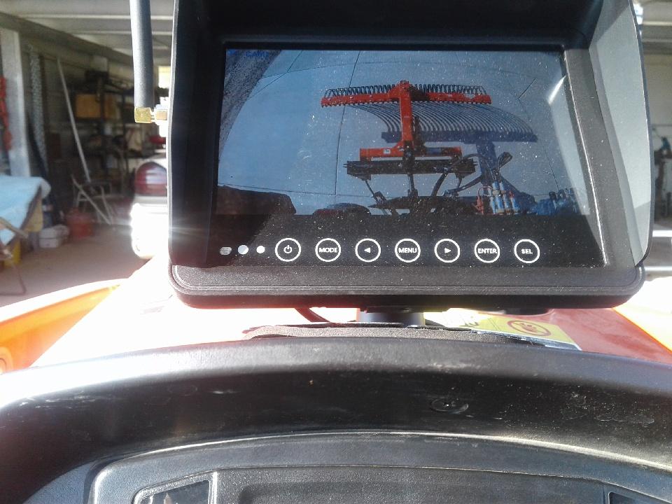

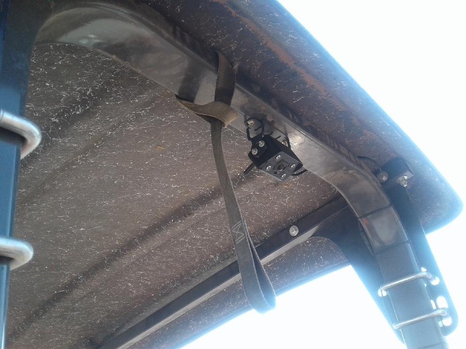

I do have mirrors on my B2650 But also a remote rear camera. the 7" monitor is waterproof and it Shure makes it easy to back into your implements back up 3.jpg Camera 1A.jpg 20200510_131410.jpg back up 3.jpg Camera 1A.jpg 20200510_131410.jpg without turning around.

Do you have details for your camera/ monitor
I got the unit on Amazon, its a Yakry model Y34HD and it cost $190.81 I have been using it for about 4 weeks now and it is sure nice. and the monitor is water proof so I don't have to remove it when I'm not using the tractor. i wired it into the ignition so it come on when the tractor starts. and the camera is wired into the 12VDC port next to the seat.
